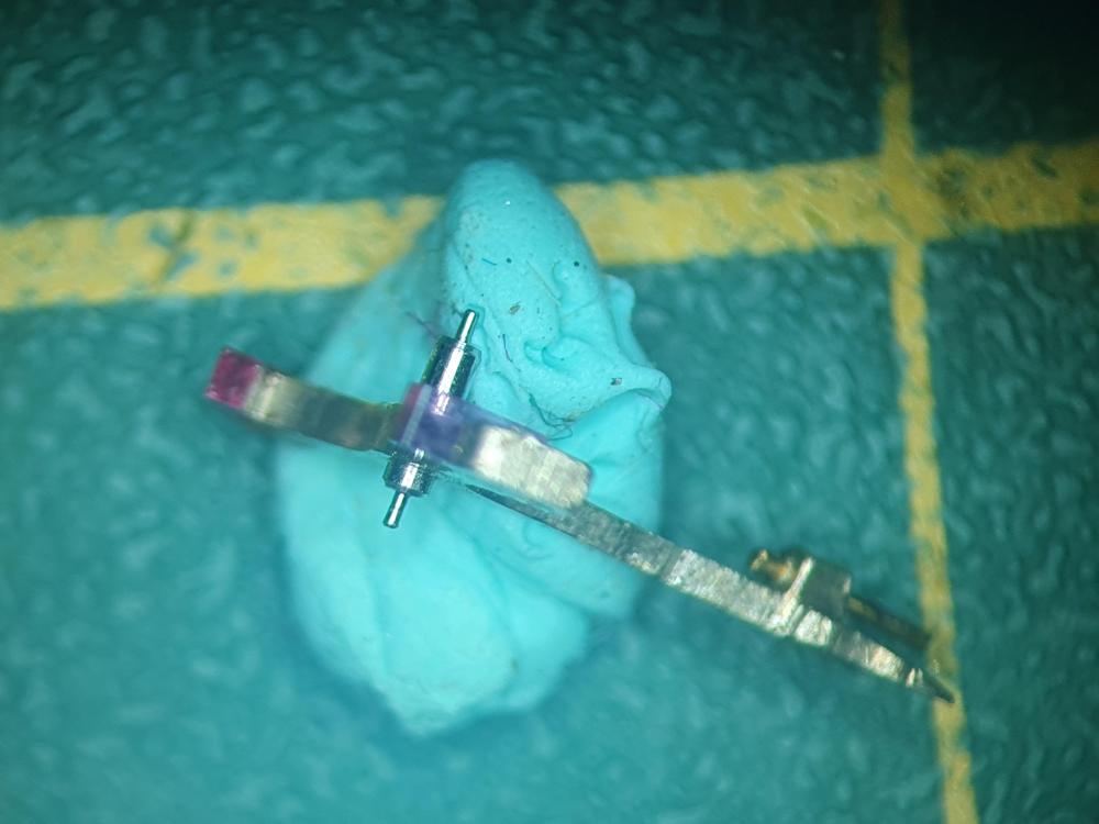

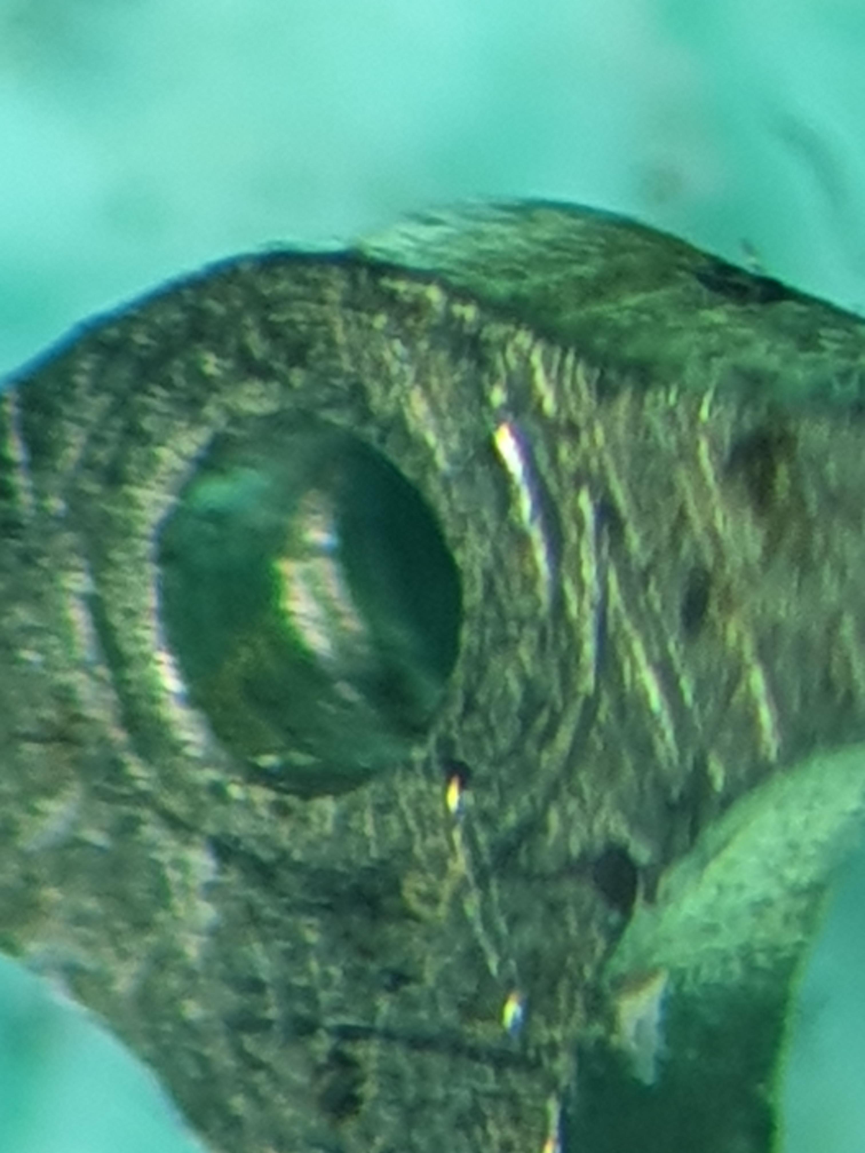

My plan for tonight was to assemble the balance complete and get it on the main plate with the pallet fork to check if that fit was ok as well. When I fitted the pallet fork, I noticed a lot(!) of play. Turned out the staff is loose.. Someone has put a hammer on it by the looks of it.
So, apart from the brokenbalance staff, the bent balance cock, the bent extended pivot for the sub seconds hand and the missing tooth on the rachet wheel, I also have to fix the pallet fork (and apply some fresh shellac). Nice project. 😀
At least I got the balance spinning nicely.
Added: I removed the pallet fork staff. This is turning out to be a project with a lot of new challenges for me. I'll probably have to make a new staff for the pallet fork as well.
Edited by caseback
Typo's, added extra picture
Actually You have more problems with the pallet fork. The entrance pallet is wrong - it is actually an exit one. The slope of the impulse plain is much bigger than it should be. Then the staff - Yes, it is threaded, but I don't remember how it should be on this Junghans. Seems like somebody modified the staff to fit here, the pivots look as shaped by almost blind watchmaker. Anyway, You can make new staff and there is no need it to be threaded, but have in mind that the fork can be deformed due the experiments of the previous master so the angles and distance between stones tips may need correction by deforming of the body of the fork. And the entrance pallet must be replaced, or reshaped at least.
Thnx Nev!
Yes, to use an understatement: it sure has some issues 😀. I hadn't noticed the incorrect stone, but what I did see was that it's already bent, the hole for the staff is deformed and there are very crude file-marks. I might be better off sourcing a replacement, but I'm tempted to try and nurse this one back to some "health". I'll give it some thought..
What's also troubling, is that there is now way of knowing what part (if any) of the pallet fork is even meant for this movement. Copying the staff and getting it to fit the fork would be easy, but I'll have to take some measurements first to check if the hight is correct.

I would use the existing staff to determine is this fork able to work correctly with this movement. This means the rear part to work well with the balance roller and the front part with the escape wheel. If You need guidance, I will explain everything that needs to be checked, but it will need some writing. Actually, the pallet fork is complicated part that have to comply with many things in the movement
Thank you for your kind offer. Very much appreciated!
I'll make a replacement staff, put it together and see what it does. I'm sure I'll have some questions to ask you by then.
Well, I've made and fitted a new pallet fork staff, replaced the pallet jewels and straightened the seconds hand pivot. The pallet fork locks and unlocks the escapewheel so I'm itching to see if she'll actually run, but there's another thing that needs fixing first. The ratched wheel is missing a tooth. Yes I know it will still work without it, but what's the fun in that..? Can anyone tell me what the recommended method for this is? Making a slot with a small saw, solder in a new piece and file it in shape? If so, brass or steel?
