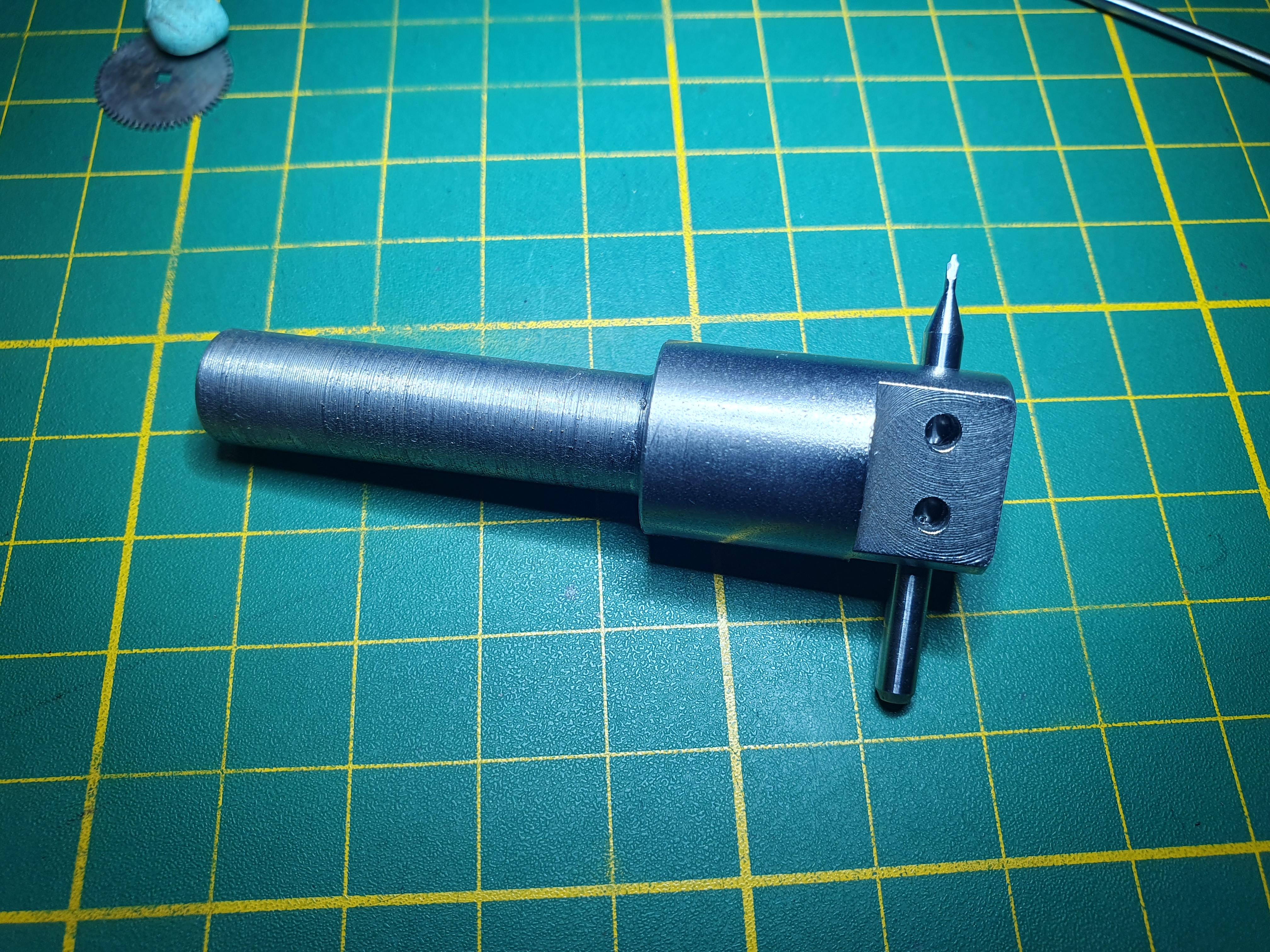

On 10/21/2024 at 6:51 AM, nevenbekriev said:
Yes, the 0.1mm bit on the picture has 1,2mm carbide tail. 0.6 and 0.7 too have suitable tails for making cutters out of them. Of course, one should use broken bits that are good for this purpose only. The 3.17mm tail can be turned in the lathe to 2mm or whatever the milling attachment is made to take. Sometimes it is soft enough, sometimes needs annealing. It is of some kind special, not usual tool steel.
Another source for carbide material suitable are carbide drill bits with 1.5mm tail, they are made entirely of carbide.
Following your suggestions, I've made something vaguely resembling a cutter.
I'll set this up on my milling machine and will try using it on brass first to see what it does..

11 hours ago, Neverenoughwatches said:
Be sure to cut the excess off the back end of the cutter lol 😂
Or maybe I could just grind a matching profile on the other end and centre the cutter in the holder...🤔🤣
Edited by caseback
🤔 you better have any play on that fly cutter down to nothing and a torque wrench on those grub screws then and stand well back behind a riot shield lol, you're a better man than me 😅

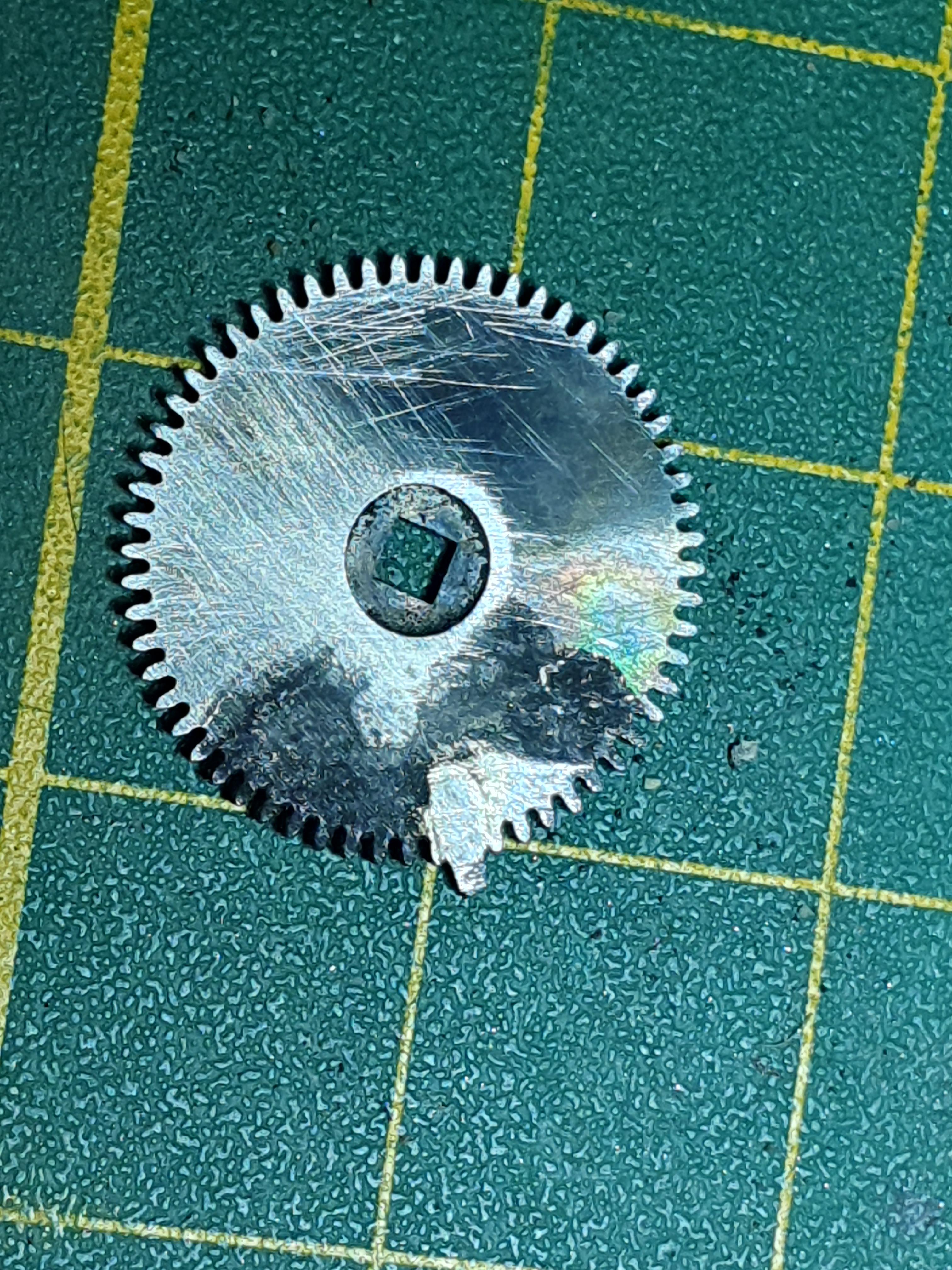

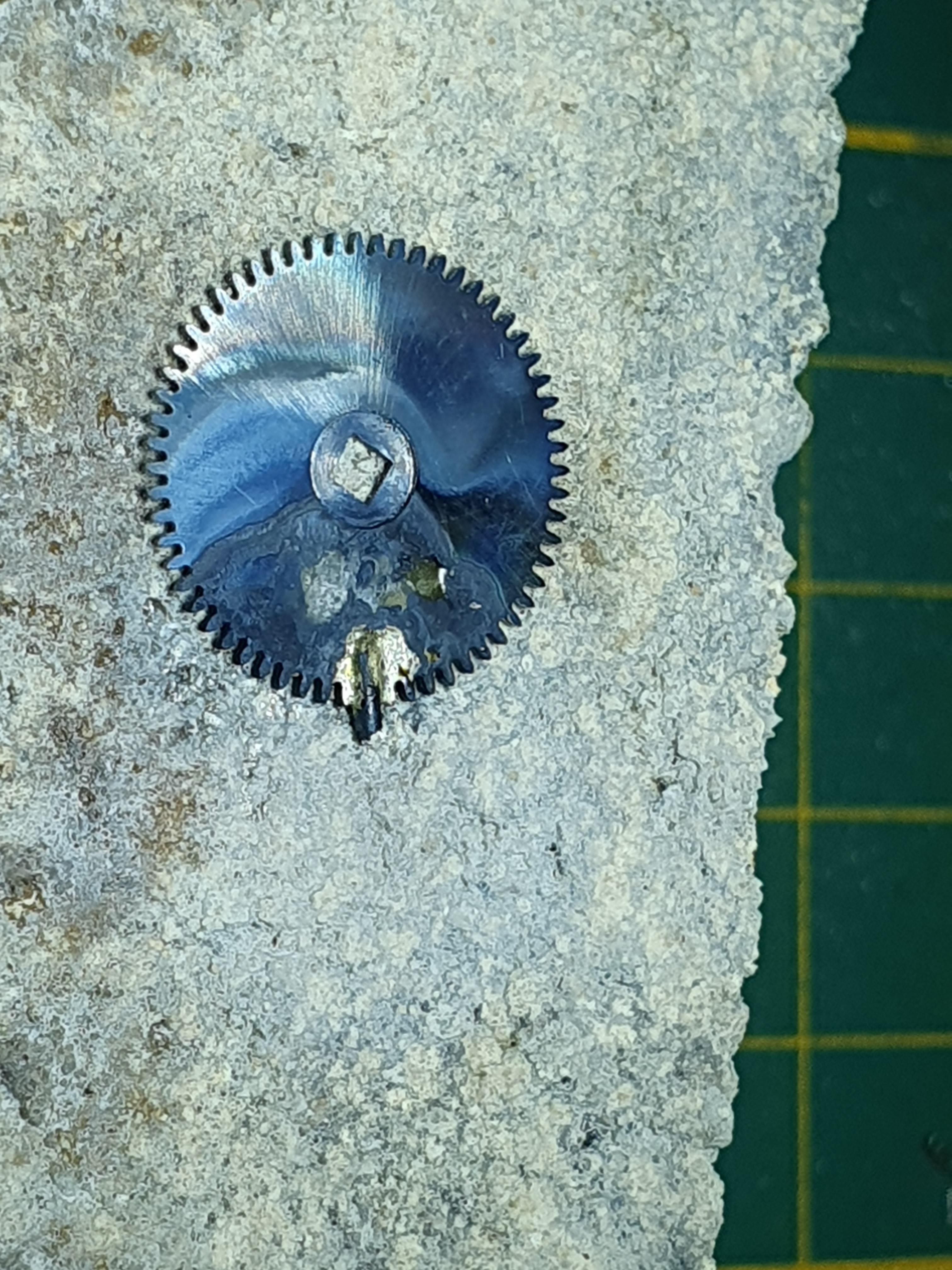

On 10/16/2024 at 12:38 PM, praezis said:
But you can repair the tooth only, I did it sometimes before I had such wheels laser cut. Well made it looks not at all ugly as Nev said and you don‘t need milling gear.
Cut a slot in the wheel, wide and long as the missing tooth. There are thin separating wheels, use your lathe and a table in the hand rest post. Silver solder a piece of steel into the slot, replacing the tooth. Grind / finish to a tooth shape.
Frank
While attempting to make a new ratchet wheel (btw, does anyone please have any suggestions on the steel I should use? O1 perhaps?), I decided to try the other route as well, if only for the learning experience.. So I cut a slot in the wheel and silver soldered in a piece of steel wire that was ground square(ish). The result isn't too bad. But before I go ahead doing some polishing to make it look a bit nicer, should I heat treat it? If it was hardened originally, I imagine the soldering will have made the part softer. Or am I overcomplicating things now?
39 minutes ago, praezis said:
The replacement bit is a bit clumsy (I used the width of one tooth) but a superb result!
I didn‘t heat treat, imo it was still sufficient resistant.
Frank
Thnx!
I didn't have any thinner cutting disks available. Question of doing the best with what you have. I had never done any silver soldering before, but it filled the gap nicely.
I'll clean it up and put it in the watch to see how it works.
Thanks for the advice.

Something to say here.
The ratchet and the crown wheels are 'the face' of the movement. One expects to see perfect decoration there. Of course, it is not a problem to replace broken teeth, but hard soldering will leave at least half of the wheel soft and will make impossible hardening, as the solder will melt before hardening temperature is reached. Then, the wheel will usually bend out of flat when soldering, and thus will need a lot of grinding when decorating the wheel, the wheel will get thinner. The soft wheel will work fine, but the same reason for which hardened tooth breaks will make he soft tooth smash. This is the why I recommended to leave the original wheel 'as is' rather than replacing the broken tooth
Thank you. That is something I hadn't considered yet.
This watch is, as you can see, very much a learning experience for me. I have just started my attempts to make a steel ratchet wheel, so eventually that will replace this dental patient..
Do you have any suggestions for the material to use? Hardened steel, or an oil hardening O1 for instance?
Again, I very much appreciate all the helpful feedback I'm getting!

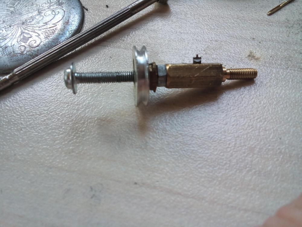

You need tool steel with carbon content 0.7-1% or so called 'silver steel'. I am not much familiar with american and european steels, I have and use some USSR steels, for important things - some 115CrV3. Sometimes tool steel can be got out of ... tools. Chinese hex wrenches, cutting disks like
0805061570-0805061738-cirkuljaren-disk-za-ygloshlajf-f115-x-22_552x552_pad_478b24840a1.jpg.6d58d8d56f859670b2587025c02639ff.jpg
when steel sheet is needed. The steel of this kind of disks is soft enough for machining and only hardening and annealing after the part is cut is needed.
O1 was commented as good for balance staffs, this means it is good for everything else. But, the best steel for someone will be the one that He is familiar with it's hardening regime, feels comfortable with it and every time gets good results. If the steel is new, then He would try to harden some example, try it with file, then anneal to desired hardness and break it to see the crystal structure.
For making the ratchet wheel, I would use piece from middle of the disk shown. Then would make the square hole by forcing in smaller hole a square tool, shaped like 4 side broach. Next will be turning of the piece fixed with shellac on the face of a rod, centered by the hole - first one side, then another, in order to roughly thin it to size and to exact diameter, then cut the teeth, harden, anneal. Then final turning the sides to the thickness needed, form the recess for the screw head, and finally - the decoration

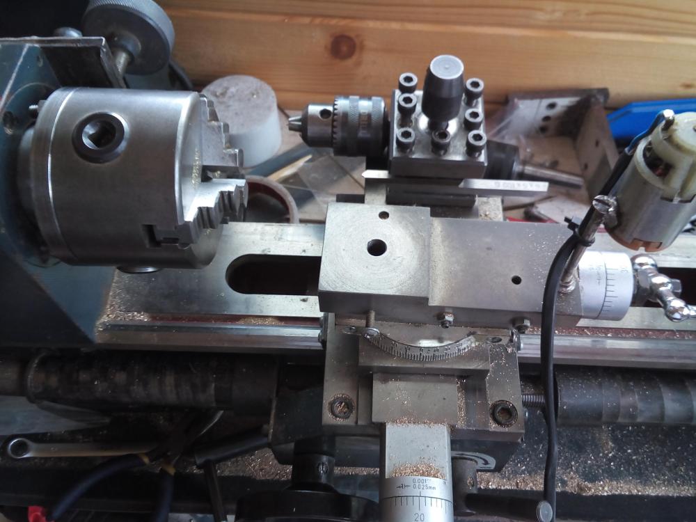

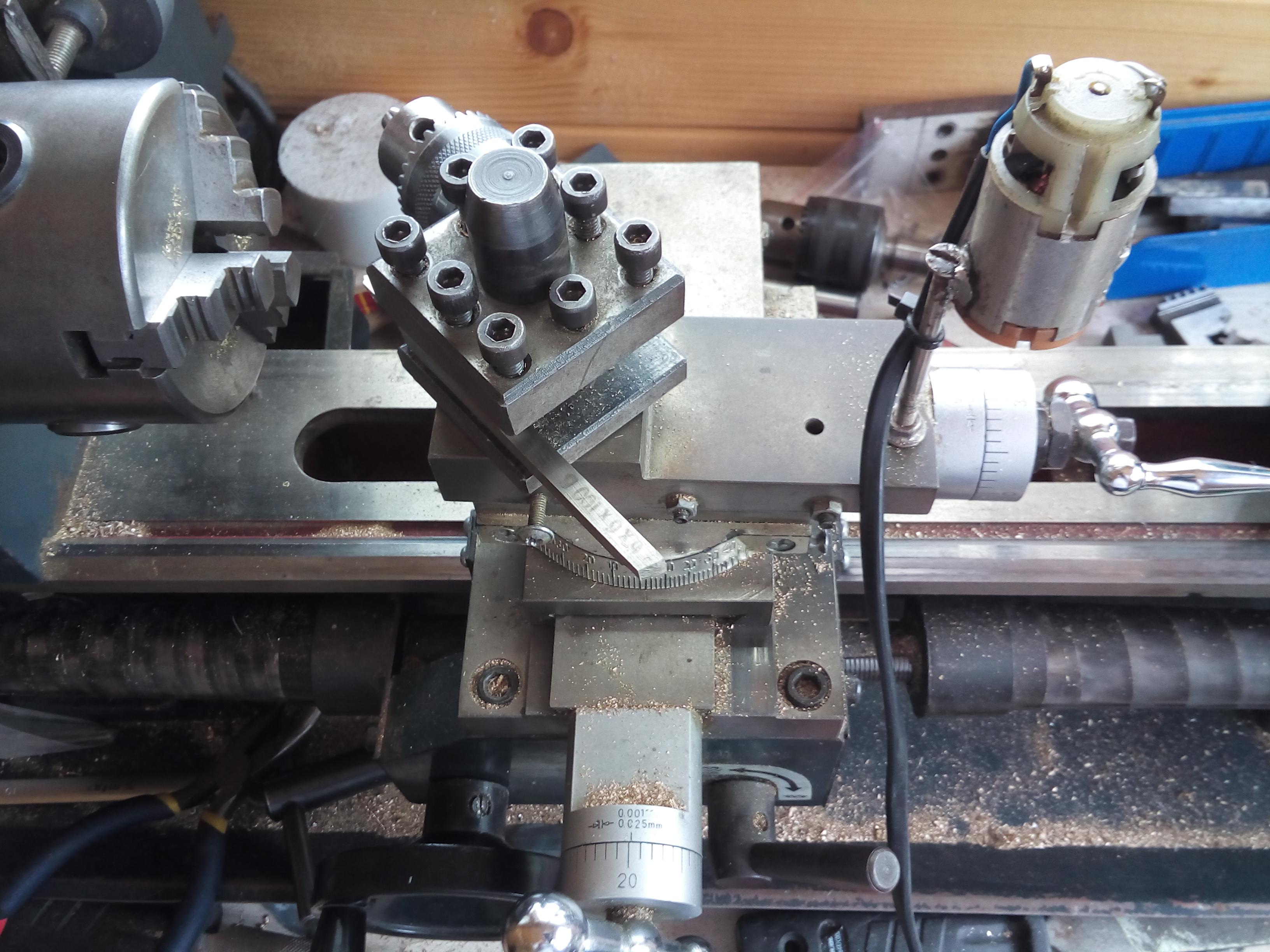

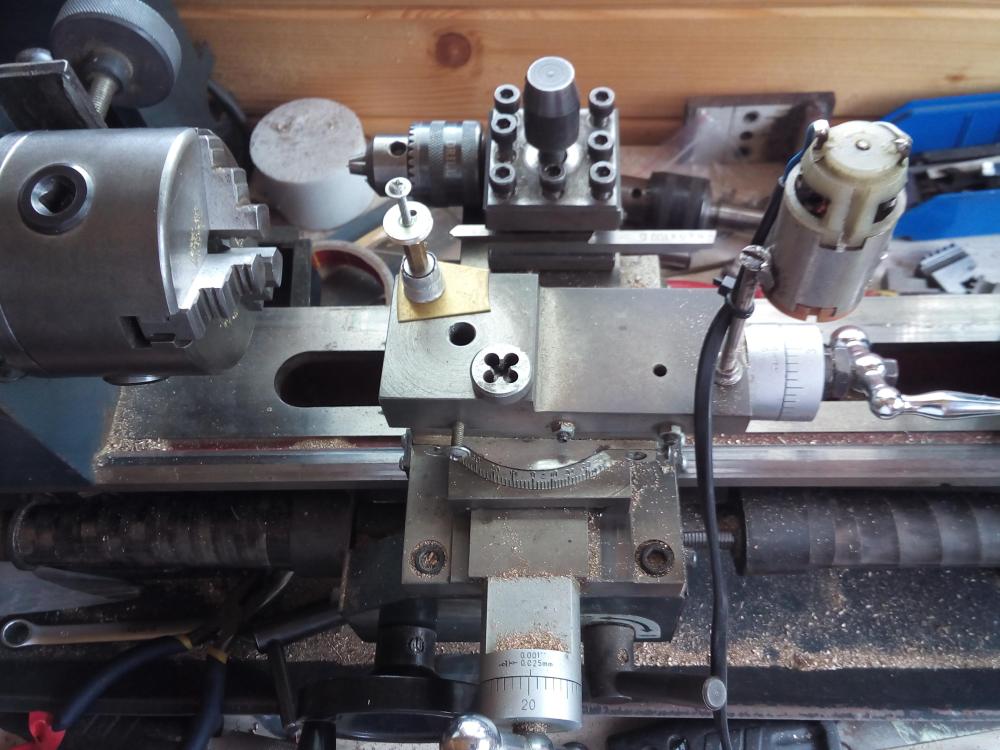

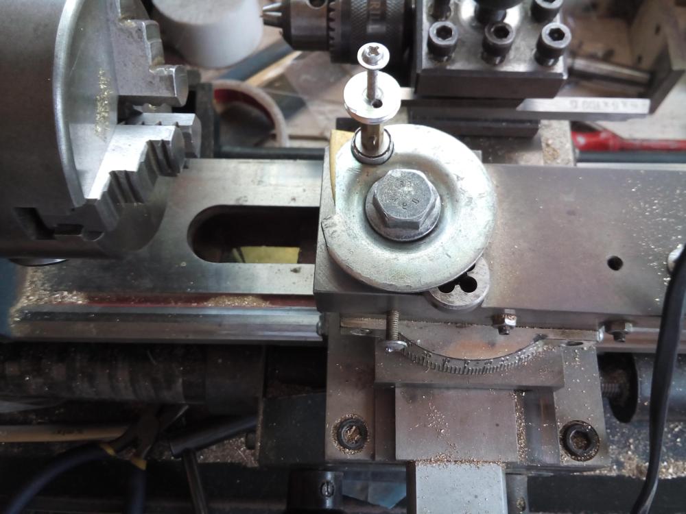

On 10/17/2024 at 7:18 PM, nevenbekriev said:
OK, here are some old  photos of the first design of my milling attachment. Ver. 1.0. 😄
20160723_132059.thumb.jpg.11ba62b4f462025be83b329744404c02.jpg20160723_132129.thumb.jpg.ae165be5e8416bf606a805aa517fe3e0.jpg20160723_132142.thumb.jpg.a245fa1b727536f111cd14937965835f.jpg20160723_132207.thumb.jpg.466fd58516475cacb33a6309f01e359c.jpg20160723_132245.thumb.jpg.8a47984e0f096e68a919e066db49efbd.jpg20160723_132255.thumb.jpg.ba3f781e95db2d2767013f6ce3f26c1c.jpg20160723_132304.thumb.jpg.dc23512741b249de8cc534bba976e4c8.jpg20160723_132606.thumb.jpg.254587ce39b28af4a3a86b1c27d20134.jpg20160723_132626.thumb.jpg.c9ad2a176f9a3156f5a4e636ef5689c5.jpg20160723_132738.thumb.jpg.6cd8d08fee487f6a0cc3b65b40646a67.jpg20160723_132806.thumb.jpg.54bd63a31b0d18afb2d55e187b9a71e7.jpg20160723_132838.thumb.jpg.75ceeefdadf8c94c88ef2eef91054a1b.jpg20160723_132917.thumb.jpg.d6a8cf992440dff873e8d3fa16d22596.jpgfix-hard-disk-errors-image.jpg.d91c028fe01918953cc47c21d57527d5.jpg
Yes.
Finally, I got the chance to see clear images of what I have seen on your YouTube channel for a long time.
You are truly an inspiring and creative person and that is what makes me follow you actually.
I hope you continue to share your work because you have a different approach.
Thank you very much
