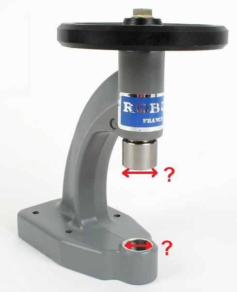

Greetings fellow watch nerds 🙂
Can I ask one of you who has a Roburpress to take some measurements and help me clarify what I'm potentially looking at when considering a purchase?
I find there is limited information about this press online, and the pictures are also bad and limited as they're all from the same perspective.
I have a few questions mainly:
1. What is the diameter of the bottom hole?
2. What is the diameter of the top holle?
3. Is the top hole, actually a hole? How does it hold dies if it's shaped the same as the bottom hole? I haven't found any pictures showing the top anywhere!
Thank you so much!!

Bottom hole 15mm top hole 15.5mm. Which is strange because the dies fit in the upper and lower holes. See attached my set.
Mine measure 15.5 / 16 mm, the dies pivot 15.2 mm.
The top hole has a (too) strong wire spring inside to hold the die.

The thing I like about the robur is the dies.. so I was trying to see if I could use the roburpress's dies with the same press @VWatchie has .. I actually already have that press... but I just measured the holes on the chineese made press , and they are 14mm.. too bad because if they would have made them 1mm bigger, the robur dies would work in this offbrand press.. which is made quite nicely.. What dies do you fellas use?

Some here have 3D printed an adaptor for the Robur dies.
You may need a press with a little extra headroom to accommodate the extra space 2 adapters may take up.

If you have access to a lathe that is slightly larger then a watchmakers lathe, perhaps you can convert the parts of the press vwatchie has to fit the robur dies. You wouldn't loose headroom using adapters. If you're in the Netherlands, I might be able to assist with that..
