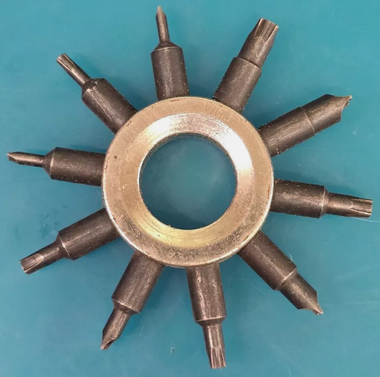

With the crown unscrewed and removed, look into the top of the pendant tube. You should see threads and also 4 or perhaps 2 slots or divots. Those are meant to engage with a "sleeve wrench" which is used to turn the case sleeve in and out. It's a tool that looks like this, with many different sized and styles of tips:
Probably you just need to turn in the case sleeve 1 or 1.5 turns and it will engage the movement's winding correctly. Here's a video of JD Richard adjusting one.https://www.youtube.com/watch?v=ugiH0FvERqc

Thanks for the knowledge guys.   It seems like when I was first looking the watch over if I pushed in the crown firmly I could get it to engage somewhat but it was fully wound so I couldn't do much winding.  I will try to fully put the watch into the case with the case screws and see if I can get better engagement that way.   If I work on any further pocket watches I think I definitely will need one of those 10 spoke tools.  How would you go about removing the spring lock to free up the stem?
You might be able to improvise something with the watch you're working on. Since it is 0 size, you might be able to unscrew the sleeve by sticking sturdy tweezers into the slots unless the threads are stiffly seized inside (don't wreck your good tweezers). You can grab the square part of the stem with pliers and hold it while unscrewing the crown. Then you don't need to remove the ring inside, the stem will come out with the sleeve from the top. However, if you can turn the sleeve with tweezers you might just try turning it inward 1 rotation and see if the stem engages winding better.
