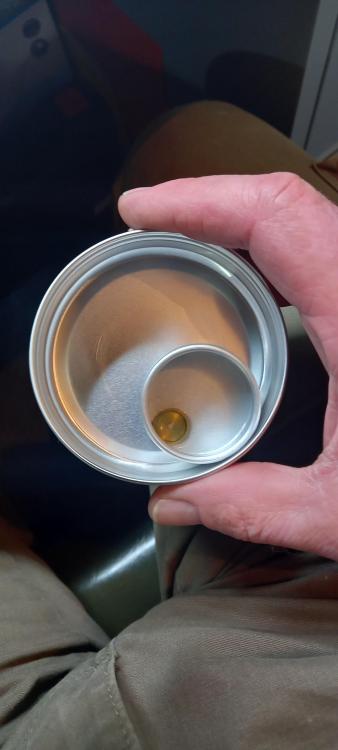

I don't think the heater is necessary, or at least not in my setup. I do the final rinse in IPA and then spin dry. After that I blow dry jewels with a puffer because the spinning doesn't get rid of everything. Theoretically puffer is better than a heater because if there's some crap dissolved in the IPA it remains on the surfaces after the IPA evaporates.
How i clean and dry watch parts... cheapy cheap diy fashion, spinning inside a US.  Speed controlled  CW + CCW... DC motor and mini US machine, a lab stand, some bean tins, a modded make up lid,a bit of door panel plastic and a few nuts and bolts, the wing nut acts as a small impeller...it will when i bend the wings over. How rather very simple of me 😅
