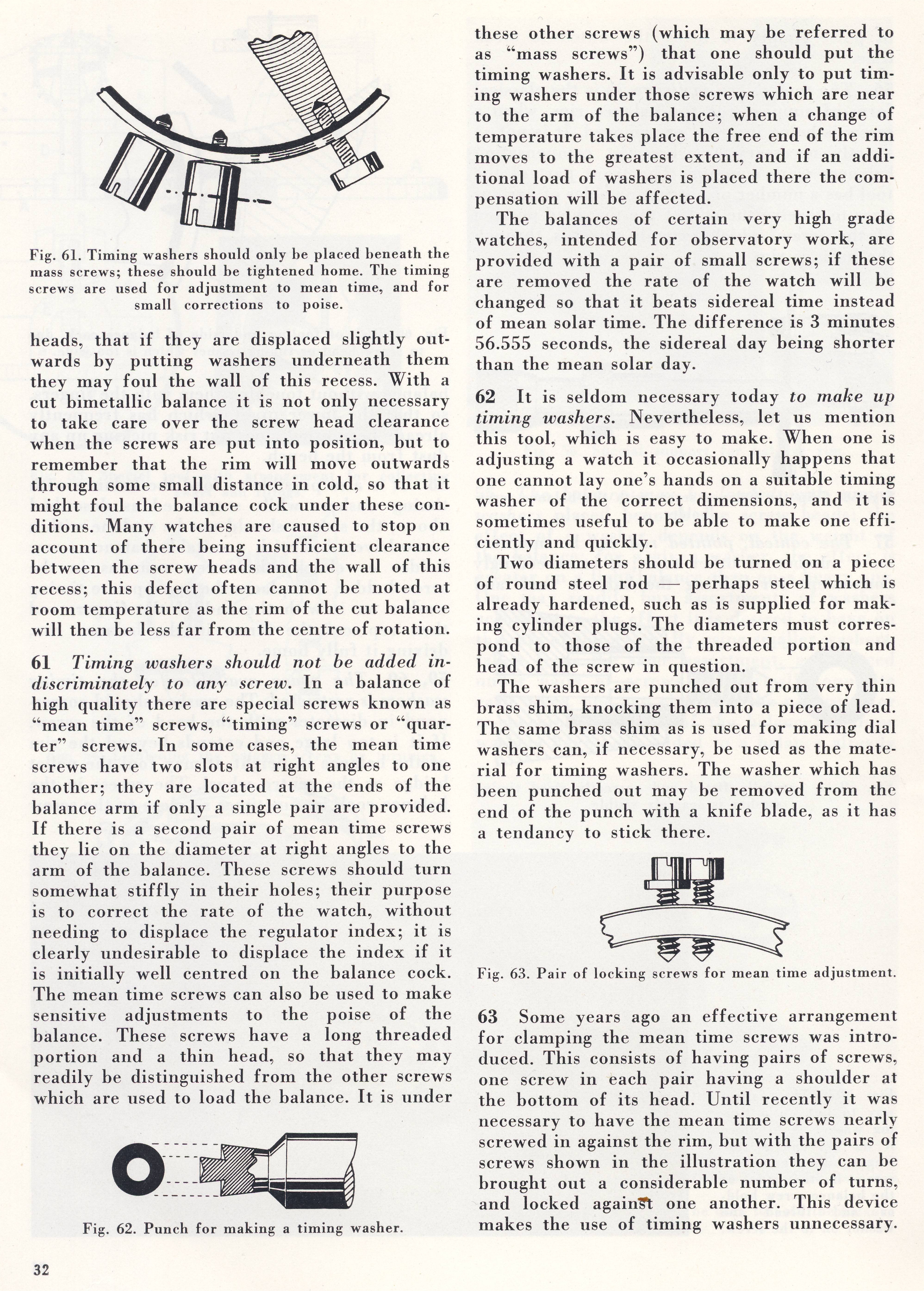

Hi, I'm looking for some timing washes. I can't seem to find any on the auction site is there a way I can make my own instead of me buying?

I have found the complete opposite - plenty for pocket watches, but few (of the right price/selection) for wristwatches. I have a saved search and I've been checking for years for some suitable wristwatch washers. I have pocket watch ones which go down to size 0, which is about 13'''. OK for large wristwatches. I've fitted them to small balances and filed the edges off.
I have some brass shim sheet in .001", .002", .003" which would probably be suitable. But I can't imagine being able to turn it it to useable washers.

What about using timing wire instead of timing washers? I use wire, for many years, it is free and available in plenty of sizes.
What type of timing wires are these you're talking about? Do you have any pictures? Could you send me a link to where to buy them?

Hi Murks,
I talk about normal copper wire from electric cable. Cable with many thin wires inside. You need wire thin as 0.2mm or similar. Just unscrew a little the screw, enough to wind one coil of the wire under the screw's head, then tighten the screw and cut the excess wire with sharp office knife, that's all. It acts same as washer. You can use thinner and thicker wires, as needed.

@nevenbekriev solution sounds pragmatic. But you'll need some good fine motor skills.
