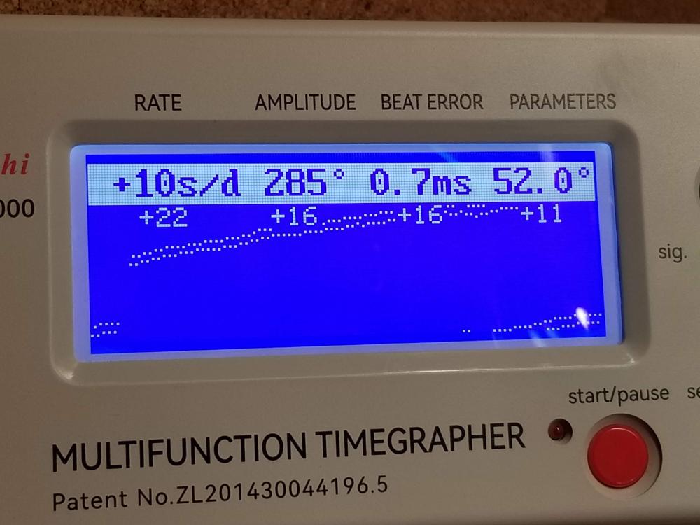

I'm working on my Grandfather's Benrus tank watch, with Model BA movement, that I inherited.  I am puzzled by the timegrapher results. Dial down gives some really puzzling results. Other positions that I have tried are more what I expect.  I have already serviced the movement.  I didn't see any problems with the pivots or jewels.
What should I focus on?

My advice will be to check for overbanking in DD position. Amplitude readings... Learn to see amplitude by observing the balance, what is seen on timegrapher is not always relevant. Of course, it may be some kind of hairspring problem, but may be just stronger mainspring. There is difference DU/dd, which needs investigation.

I had a much more reasonable DD timegrapher result prior to service.  So, what has changed?  Well, it has a new mainspring.  I tightened up the upper barrel arbor hole in the barrel bridge a bit.  I also reduced end shake on the pallet fork (jewel on the pallet bridge was a tad high).  When finding this issue, I tried to reverse that change, but it didn't affect the results.

I second the rebanking theory. Been there, done that. New, potentially stronger mainspring. Highest positional amplitude. Super high rate gain in the one position. Looks normal visually. Seems like kind of a low amplitude to start rebanking, but not impossibly so. If you have the ability to adjust the pins, you might see if you can narrow them up a bit without causing problems. Won't likely take much, and will at least be a good test if not a fix.
I was able to move the problem to the DU position by changing the height of the stud pin in the balance bridge. 😵‍💫  Initially, I had the stud pin in as far as it would go (I had removed the balance wheel from the cock to clean the pivots).  I loosened the stud screw and let it find the position that it wanted to and tightened it back up.  The craziness moved to DU.  Fiddled with stud position, to get the mainspring to lay flat, but that brought the problem back to DD.

Was the watch fully wound then?
If DD shows knocking, it should disappear with less winding.
Next to +467 there are -9 results. Was the ‚crazy‘ result intermittent only?
Frank
Yes, fully wound.  Though, I let it run overnight and checked it this morning and it was still acting bizarrely.
It can be intermittent.  The timegraph can look more normal, then start going awry.  Once awry, though, I haven't seen it go back to normalcy unless I change the position and then go back to DD.  That is not always the case, though.

I haven't found the lift angle for the Benrus BA movement.  I did find 51 degrees being the lift angle for several other Benrus movements, so I have tried that.  Not much of a difference in amplitude reading from 52 degrees, of course.

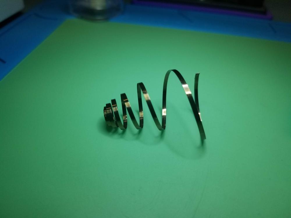

I'll attempt to center up the hairspring collet and tweak the position of the regulating pin and retest.  Trying the old mainspring is certainly an option, but it is quite coned.  Plating was worn off of the barrel lid, so this wasn't from me removing the mainspring.

Yes, the spring is coned. Actually, I have never seen spring that much coned. But I can argue if it will not work or release only 2 coils . Thinking in this direction, I can guess that the spring has been coned on purpose and this purpose is to reduce the amplitude...
OP, The hairspring looks great, but I still will advice to enlarge the space between the outer coil and the rest. Bend a little in the point I have marked on the picture.
You know better than me Nev 😅, ive never seen one this coned before . But i did actually wonder if this had been made this way for a reason as i cant see it becoming this bad any other way. Reminds me of the 80's craze toy ' Slinky ' 😅
I tried with the original mainspring.  Had to wind it in by hand as the coning was causing me a problem trying to use a mainspring winder.  Amplitude is significantly less, but I don't see that weird problem in any position.  So, I'll look at getting a new mainspring.

I meant the pins on either side of the pallet fork. The banking pins. The fork isn't where it's supposed to be, and the balance wheel is hitting it on the back end. ...is my theory based on the timegrapher.

If You order springs with 0.11 strength, then You probably will get the same big amplitudes. The movement is actually ETA900 I guess and from Ranft database, the spring should be 1.55/0.10/290
ETA 900 is the base movement.
8 hours ago, AndyGSi said:
I've found various different sizes for the mainspring.
I think one of your problems here could be the 1.6 is tool big for the barrel.
The lid closes no problem, but the height I've seen listed for this movement is 1.5 or 1.55 mm.
Not sure that I want to mess with those.  A less strong mainspring seems the better way to go.
