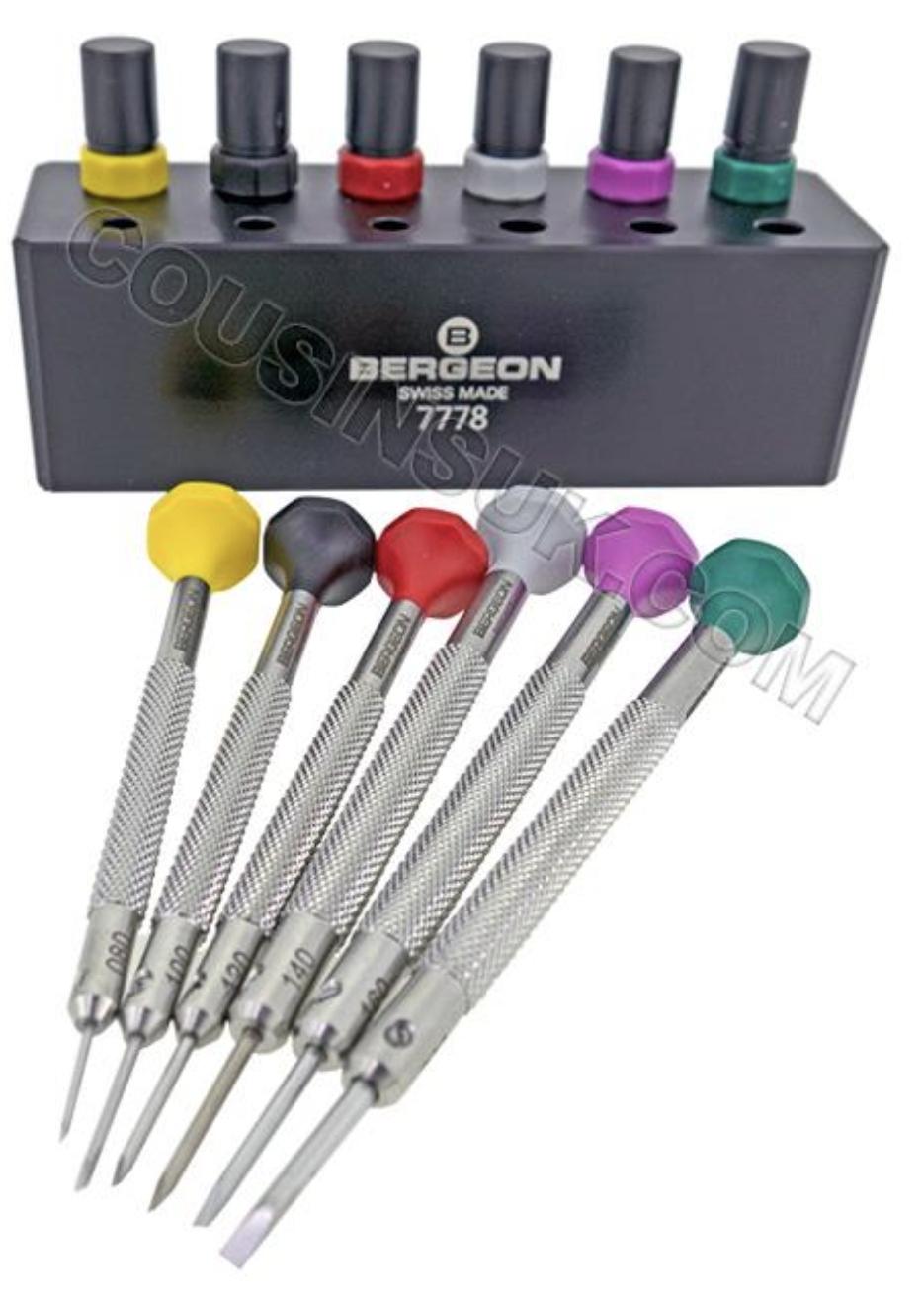

For reference, this is the set I have (80, 100, 120, 140, 160, 200) and all I ever needed. Except, the 60 which is often needed for the tiny screws in non-shock protected balance jewels. I bought that one extra.
https://www.cousinsuk.com/product/bergeon-screwdriver-sets-static-stands
That looks like a good set, i like the larger heads as i have large hands, 70 something quid plus 14 for vat and then shipping so around 90 quid and you know the head bearings will be smooth.
