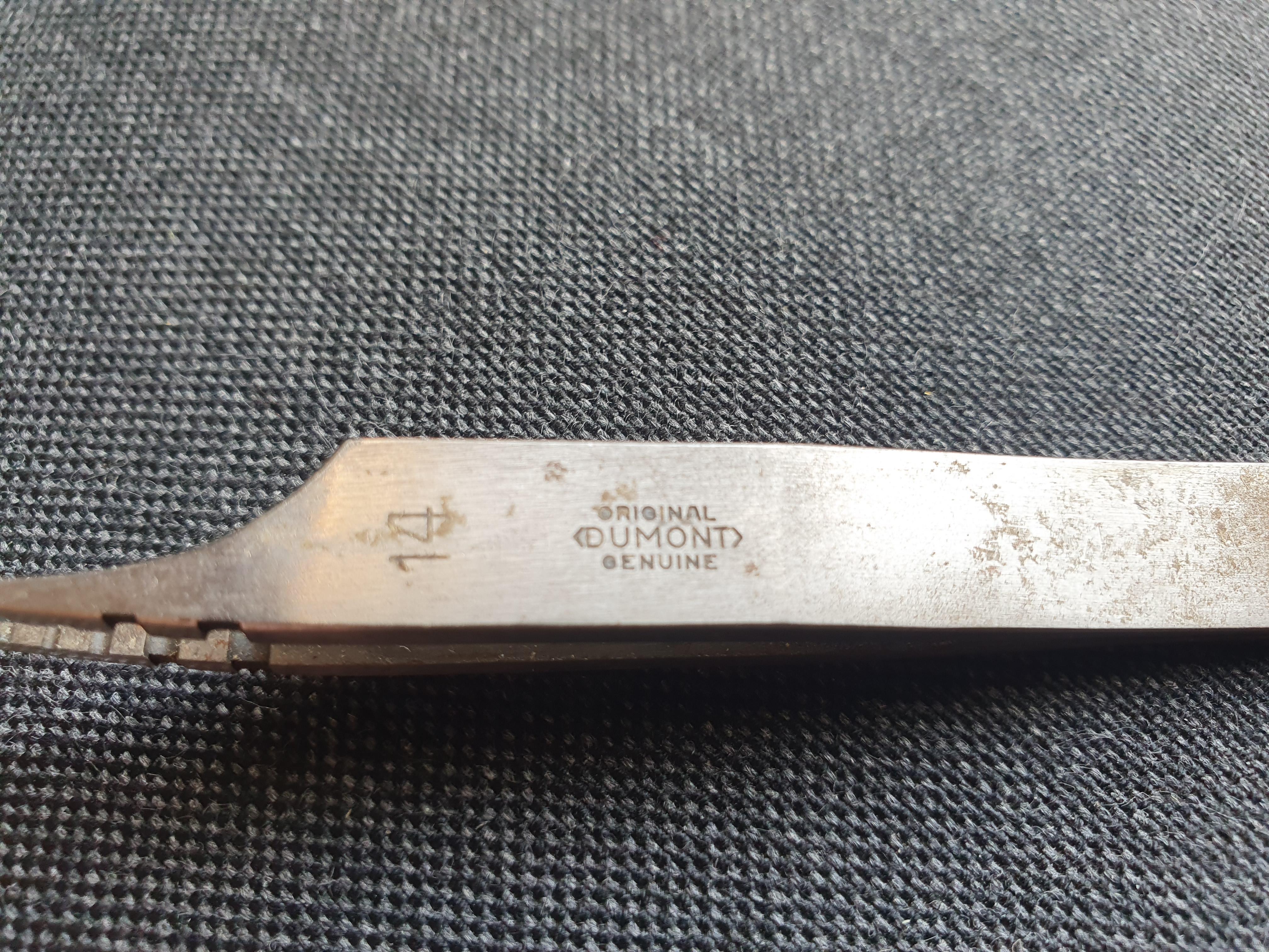

In the batch of tools I received were some tweezers, one beeing a Dumont 14. I can't find any info on this odd-shaped instrument. What is it used for? Cannon pinion pulling?
The old Bergeon catalog lists it as for "removing and holding seconds hands". There's the 14a which has a sliding lock on the side as well.
Thank you. I would never have thought that was it's intended use. It's sturdy enough for pulling teeth..
