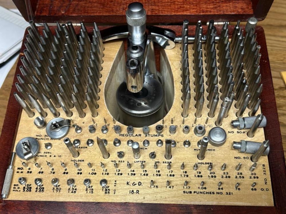

I learned a lot from this site about K&D staking sets.  You can find out exactly what stakes, stumps and accessories originally came with their more modern sets.
https://kanddinverto.weebly.com/
What I found with sets on eBay was that they often came with duplicate stakes, stakes from other manufacturers, and missing pieces.  Sellers will not typically list the particular stakes that come with the set.  You can ask them to provide you a list.  Compare that to the stakes that would have originally come with the set.  Steer clear of rusty sets.  Some of the holes in the stakes are really small and hard to clean out any corrosion from.
That K&D 18R Deluxe set you list is missing some things.  There should be two balance staff removers that will fit the frame, one for smaller sized balance staffs (wristwatches) and one for larger size balance staffs (pocket watches).  One of the balance staff removers is too short for that frame.  There should be two stakes that go with those removers (small diameter tip for wristwatches and larger diameter tip for pocket watches).  There should be 10 screw knocking sub punches in the small set of holes, plus the holder.  Those are all missing (those sub punches are often missing).  One of the canon pinon closing punches is missing (an incorrect stake is in its place).  The first reamer looks broken. For that style of roller table removers, there should be a small rod to tighten those.  Maybe it's there in the bottom of the box, but not shown?
Personally, I think it better to get a Seitz set for jeweling and reaming operations than have the staking set do those on top of staking operations.  I bought a nearly complete 18R Deluxe set off of eBay and then found a nearly complete 600 Series set locally for a too good to pass up price.  In the end, I kept the 600 series set, got a Seitz set and sold the 18R Deluxe set.

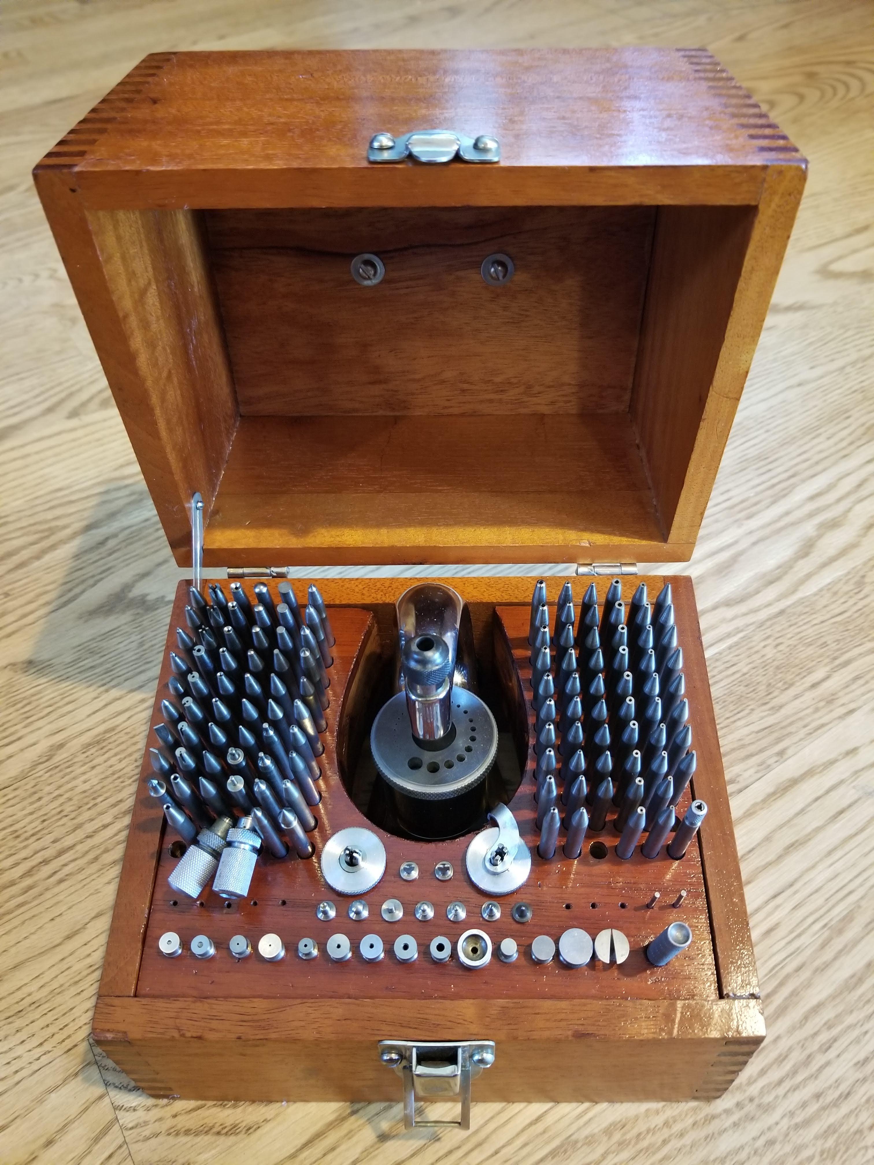

This is the set that I kept:

Great observations gpraceman!  I agree that when it comes to jewel work I turn to a Seitz or Horia tool since that is what they are primarily designed for. But if you only had the one tool, the 18R set can do a lot for you.  It takes time to find tools that are in good condition and complete.  I used my 18R until I was lucky enough to find a Seitz tool that was in decent shape with all the bits.  I still have the 18R jeweling option available as a backup.
Claudio, You should have the two balance staff removers as mentioned, along with the two stakes that go with those removers.  K&D sold them to owners of older sets as a separate kit which you can often find on ebay.  One of the staff removers in the first set was from one of these kits. (The kit is the blue box, which is missing one of the holders). One caveat: Sometimes you need to cut out the old staff using a lathe instead of this tool, or you risk warping the balance.
The sub punches were available in the Deluxe version of the 18R, but were also sold separately.  You are buying a used staking set so it is very unlikely all the pieces are original or even there.  Try and find a set that is the most complete and in good shape, and later you will find stakes or another staking tool that is incomplete that you can use to supplement your set.  You don't need to get an 18R,  just find a staking set you are happy with in functionality and appearance and that fits your financial situation.  I gave a small set of 20 stakes and base to someone starting out in watchmaking and it was all he needed at that point in time.
I did not inherit a completely original set.  My dad acquired stakes and stumps along the way, and so did I.  Several of those stakes and stumps have moved to a different set since I don't use them as often (like working on cylinder balance staffs and making oil sinks). To be honest, there are a lot of stakes I never use.  Good luck, take your time, enjoy the journey!

Thank you all for all the great information.  I did ask the list of stumps and stakes in the first link provided, and I was told that it is not available, so I am staying away from it.  The other 18R seems to have pitting and some rust on the center of the die plate, so I am staying away form it.
I decided to wait around and see if anything else pops up, and I will probably look for a 600 set or perhaps an 18/18A set.

In terms of 18R Deluxe sets, this one is the most complete one that I have seen, if you don't mind dropping that much money.  They even provide a list of the included stakes.  I do see some rust, but it doesn't look bad.  I'd strip down the frame, derust and reblue the appropriate parts.  Derust and steel wool the other parts, then lightly oil.  Should clean up well.
https://www.ebay.com/itm/146132207061
I still think, that a better option is a non-deluxe set, paired with a Seitz set, roller table removers and balance staff removers.

For those that don't know, the 18R Deluxe set has a collection of different K&D accessories sets.  The label on the staking set holder gives a clue to the K&D part#s for the accessories sets (roller table removers, balance staff removers, jeweling, reaming, sub punches, canon pinion tighteners).  You can occasionally find such individual sets on eBay.
Personally, I would not store a centering punch tip down.  Proper centering is key, so that tip should be treated with the utmost care.

To me, that set doesn't need that much work.  Soak the parts in some Evaporust for a day.  Rinse with water and immediately dry them thoroughly with a hair dryer.  Spin each stake in a drill and rub with them with some fine steel wool.  Check the holes in the stakes and stumps and clean them out with a fine needle or broach.  Put the parts on some paper towels, sprinkle some oil onto them, then rub them around, leaving just a fine coat of oil on them.  With any vintage tool that I get, I do a derusting, cleaning and oiling as needed to make sure they will usable far into the future.
I believe any of the Invertos will have a floating die plate.  For those, the central hub that the die plate spins on seems a bit undersized, to allow that floating.

What about this set:  New set.  Although it appears to be tje first item listed by this seller and that migh be a red flag.
claudio
Looks to be a very nice set.  Seems to only be missing one of the reamers, which would make it the most complete set that I've seen.  Hadn't seen a set with a K&D plate on the front.  I do find the screws in the case lid a bit odd.  Certainly not cheap, but I have seen sets not as nice go for more.  That'll probably be gone fast.
That the seller doesn't have any sales history is concerning, but you do have some protection from eBay.  Might want to ask the seller for some additional photos, like a closer view of the stakes to see what the condition of their tips are.  If the seller cannot provide more photos, that would be a huge red flag.  I had found a nice staking set on Etsy but did a search of eBay's past sales and found the exact set there.  Seller had just stolen the photos and description.  I found other items from the seller that were just copied off of eBay past sales.  The seller would not provide additional photos to prove they were in possession of the set.
If you do end up getting a set and have it shipped to you, the seller needs to carefully package up the set.  You can't just throw some packing material in the case and hope that pieces will stay in their place.  That would risk breaking parts, like the reamers.  Parts should be bagged up and protected with packing material.
The wooden boxes of both my staking and jeweling sets have weakened and wobbly joints I've been meaning to repair. I would just assume this was a quick fix for a similar issue.
Probably so.  I would have just used a needle applicator to inject some glue, but that's me.
If there are no red flags, I would say that's a very nice set for the asking price.  If I was in the market I would snap it up!
