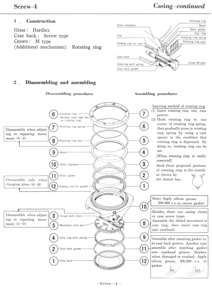

Thanks for the info on chapter ring - I think I'm right in saying both slim and fat diver/Willard's share the same 320W10GN00 crystal and gasket set up, with a different method of attaching the rotating bezel?

I'd forgotten the dial/chapter ring seats the crystal gasket as well... assuming it's correct I think I'll have to strip and repaint the one (I hope is) in the case.
Leaving these here to help me later on... (Think it's probably from the later 6106 sports divers but it's the same approach I think)
Seiko6105CrystalRetention.png.36eeac741254cfe41f297c35bcc56d54.pngSeiko6105CasingGuide.thumb.png.75d27f4dc03ce2e2531b428ed4d2a089.png
Edited by tIB
9 hours ago, AndyGSi said:
Looks the same as this.
It does, almost, though that's actually added to my confusion around the dial ring setup - that's as I remember it from my 8110, though the diagram I posted above (and more importantly parts I've seen for sale) has the dial ring going deeper into the case with the glass gasket seated on top of it (as opposed to on top of the rear edge of the dial ring and the case itself as shown in the diagram you posted). If you compare the dial ring in that picture and the one I posted (from a different model I think) you'll see what I'm rambling on about.
The dial ring I've seen are listed for both models but maybe there's a difference between the 8000 and 8110? The parts catalogue I looked at has them as the same part though afaik (unless I'm reading it wrong). I've actually seen three different parts numbers listed for sale as the dial ring for both models so I'm not sure what's going on there.
Not to worry - I'll see where I'm at when the case lands... Assuming the correct ring is in there I think the simplest thing would be to strip and repaint.
Edited by tIB
