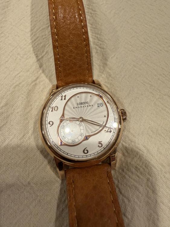

Rock climbing another passion of mine kept me busy and away from watchmaking/watch repair for a while.
Now I am back a bit forced. I dropped one of my watches and broke it.
Attached a couple of pictures of the patient. It is a Chinese watch with a micro rotor. The watch fell and the second hand is now not in its place and moving around in the case.
The watch is still ticking and as far as I can tell after a couple of hours keeping time correctly (I haven’t but will put it on the timegrapher).
I hope I just need to put the hand back in place.
I will likely try next week as this weekend I’ll be away climbing at Cathedral Ledges in New Hampshire.
I’ll keep you updated and add pics after I open it.

Unless that is a shadow, the jewel might be cracked. But the pivot looks good and hopefully the floating hand has not marred that fine dial. I have not seen one of Lobinni's watches up close, but they sure look great in photos. I am really impressed with the quality of that gilt numeral 4 under macro.

Well I haven't been able to remove the movement and dial from the case yet.
the back of the case is held by some screws and I could remove it.
I also could remove the stem.
There are 2 "screws" which appear to be eccentric with a little cut out which I turned. One is visible in this photo next to the micro rotor and the other one on the other side close to the balance (recessed in a hole in the train bridge).
I expected to then be able to drop both the dial and movement out of the case from the back but couldn't.
I am afraid of breaking it more so I put it back together right now
Are they other pictures I could take which could help figuring out how to uncase it.  That is always something I have been having problems with.

Those are the dial feet screws.
Looking at the size of the dial I expect it's a front loader.

Opened. Indeed a bit scary. I didn’t find any better place to start than another (I was hoping for some kind of divot. So I went between the lugs hoping any mark would be seen less I used a scalpel bit applying force with one is not great as still as a little gap opened I stuck in a case knife and twisted.
As usual (and not surprisingly considering it is a more complex watch and I have stopped working on watches for a few months) I have messed up things a bit.  I think when I pushed on the setting lever axle to free the stem I must have done so a bit too much as the stem is now not working (it is not winding nor setting the time which it was when I started).  So I now have no other options than to take it apart at least up to the keyless works to fix that.  The part which worries me most is disassembling and reassembling the calendar parts.

OK, I have put the watch almost back together and it is almost working...
What are those two almost you will ask.
First one is that the date is not working.   When I put back the keyless work I tested the date settings and it worked once then stopped. Something must have moved out of place when I was trying to set the date.  I don't know if it is because I tried without the dial which would have kept some of the date works down (the little wheel which moves the date is my main suspect) or something I didn't assemble properly.
The second almost is to put the bezel back.  I guess I need a special tool, some kind of press?  I think I am missing what is needed to put back the bezel and the crystal.
Otherwise, the watch runs and the hands are put back in place.
The two timegrapher pictures are before (-105s) and after (+22s) mostly the lines are clean and I took advantage of having the watch open to adjust a bit.
I did run into 2 problems which I managed to resolve:
1) I had a very hard time to reinstall the balance.  The third wheel takes a lot of place and while I was sliding the balance beneath it correctly the balance spring was going above instead of underneath.  Once I realized that was the issue I managed to put it back together correctly and it started beating
2) The dial wouldn't go back on the movement.  It turns out the feet were slightly bent.  It took lots of effort to bring them back to vertical without breaking them.  I guess I need to buy a special dial storage container otherwise if I put it face down I am afraid to damage the dial face and face up, well I just learned the feet tend to bend.  Do any of you have a trick for that.
