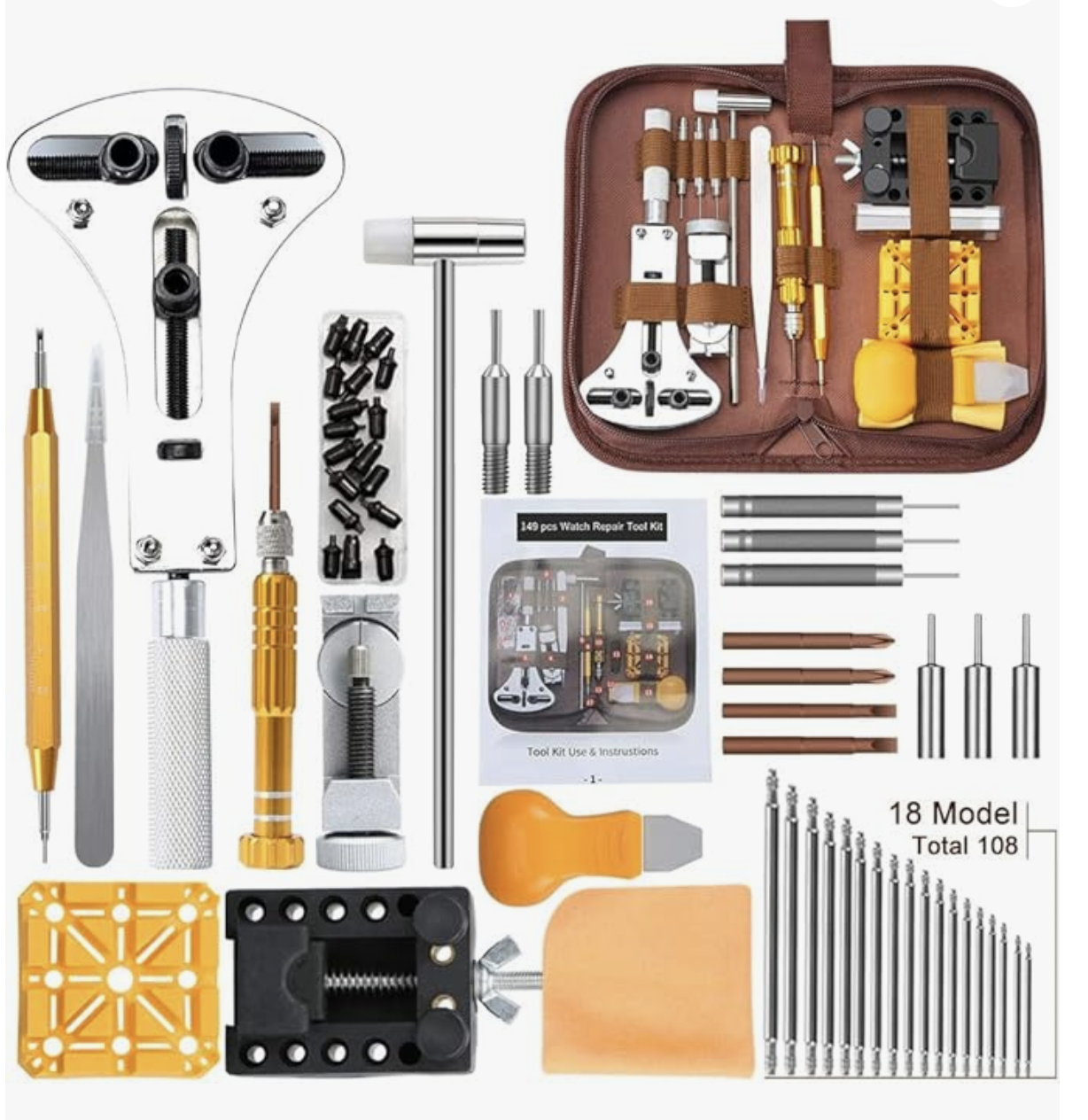

Looks like Catherine might not be frequenting the forum any more, but I'll post this for future reference.
My first watch tool kit was a cheap (price and quality) assortment from Amazon.
It has everything Catherine was looking for, but most of it has been replaced by better quality tools, so I really don't recommend this route. Out of everything seen in the photo, I still occasionally use the following:
  • hammer
  • screwdriver (used only on the rare occasion I need a  small Phillips bit)
  • case holder
  • bracelet link removal tool (which I modified, I should really invest in a good one)
  • pry opener for snap case backs
Everything else has been replaced with good quality tools, many of which cost more than the whole kit from Amazon. Tools in the kit that were of exceptionally poor quality included:
  • spring bar tool (replaced w/ Bergeon)
  • slotted screwdriver bits (replaced w/ Bergeon screwdriver set)
  • screw-down case back opener (replaced w/ LG watchcase wrench)
  • tweezers (replaced w/ Dumont)
