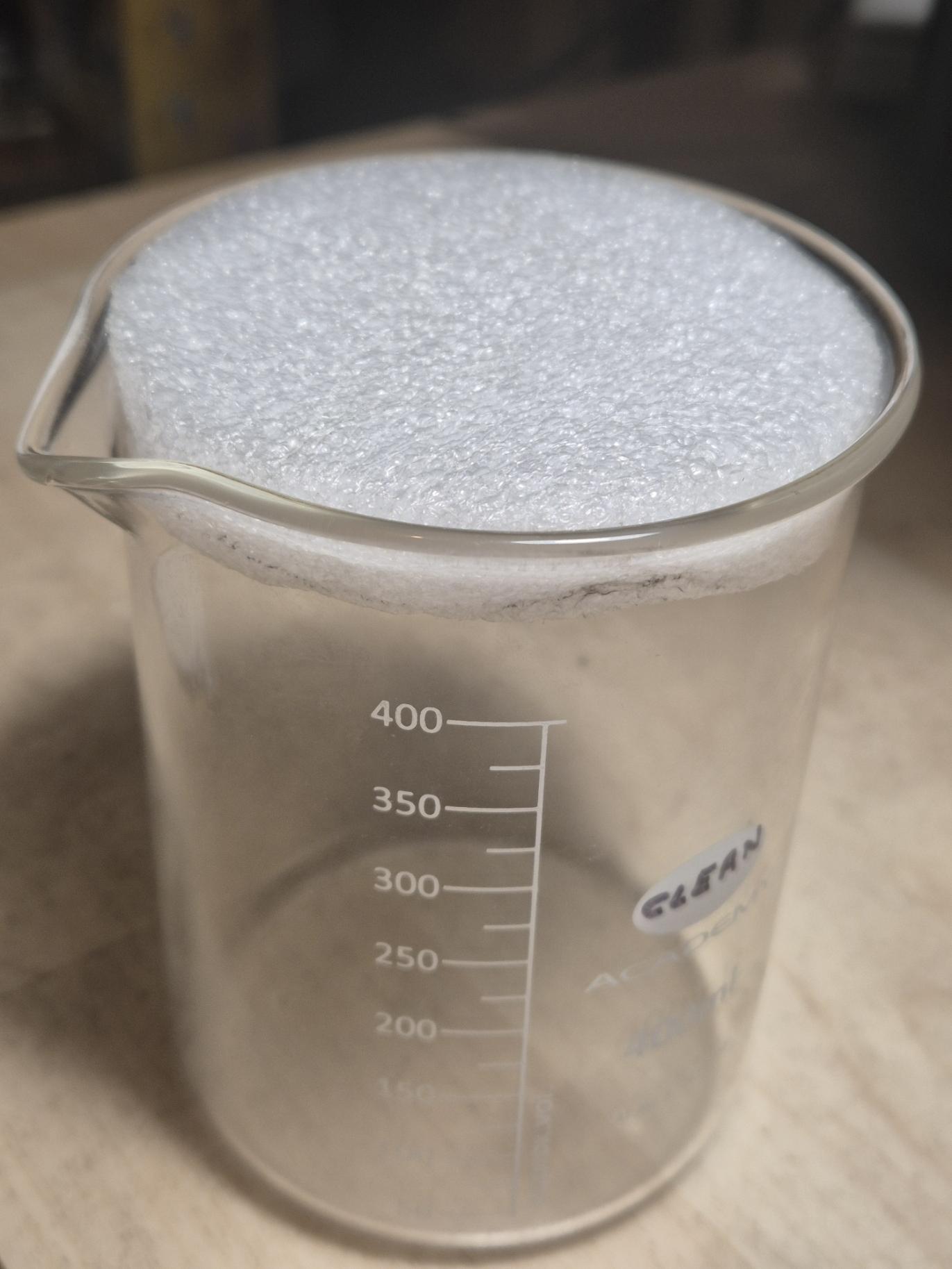

I cut some foam to use as a bung on the beaker to cut down on the smell. I use Elma solutions. I guess the formulas are similar to L&R?  The WF Pro cleaner doesn't smell much, but the rinse Suprol Pro absolutely stinks.
I just picked up silicon tops from Amazon for my 300ml  beakers. They come in various sizes so I suspect the next size up would fit you beakers.  Seems to work well, and according to Wikipedia silicon should hold up when exposed to petroleum based fumes.
