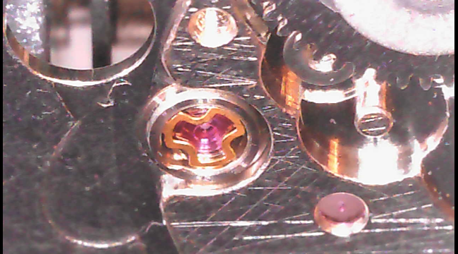

Well, I've inspected the Diashock jewels and they look fine. There is a small divot in the lower cap jewel which I will replace, but that was there before my error. I cleaned and oiled them and put them back in then installed the balance with the train and pallet removed, and it appears to be swinging freely.

I'm still not sure what happened with the accident, but I'm leaning towards thinking that I displaced the pivots from their settings without actually breaking anything. What I've done since:

I'm aware that turning the lower capstone over might fix this, but I'd rather fix it properly if I can. It's my understanding that the Diashock setting is friction fitted to the mainplate so I should be able to adjust it with a jewelling tool, right?

(Sorry about the upside-down photos.) I am going to get a new cap jewel for this setting as the current one has a divot:
I should probably wait until I have the replacement before I do anything about the end shake in case the new stone has a different thickness.
@GPrideaux, You have 2 simple problems.
First one is obvious and it is that the main plate antishock device has moved, sunk down. This leads to the great axial free play of the balance and it's rubbing on the pallet fork bridge. This is easy to repair - just press the antishock back. If You have staking se - use it, wide flat punch is needed that will lay on the periphery of the antishock device. Just press, don't use hammer. But, the same thing may be done without the staking set, with proper looking tool There is nothing to adjust there - Just press it to the end.
The second problem is that in the DU position, balance doesn't oscillate free. Well, first rectify the main plate antishock and then try again, but take good look at hairspring side pivot and the jewel setting. Seems that there is something wrong there.

Yes, as @caseback says, the endstone thickness doesn't matter at all. Of course, it is true if the spring is able to press on the stone. If the stone is too thick, then the spring will have to be bent alot, if it is too thin, then the spring may not reach it and press the setting.

As caseback says . The capstone thickness does not influence the height of the balance. The capstone sits with its flat side at the same position, i thicker stone would merely put more pressure on the shock spring. I would still try flipping the stone out of curiosity, the center of dome side will protrude past the capstone's normal seating position and will still givel good oil retention capillary action. Just an experiment to try for whenever you're in a hole. If the shock spring wont lock into position with the same ease then obviously dont force it.
Ok, I now understand that the Diashock setting does not have parallel sides that can be height adjusted: it has a fixed height and needs to be pushed all the way in. I have a Seiko 7S26C donor movement and I used it to experiment with my recently acquired staking set. I pushed the Diashock setting out of the mainplate, then pushed it back in. Then I swapped to the 6105 and gave the Diashock a good push. I couldn't feel any movement, but with the pallet and balance reinstalled I can now see light between the balance and the pallet bridge when it is dial down and I'm hoping it has moved it enough.

What looks like that divot in the endstone? I doubt that it will lead to enlarged axial free play, but may be it will eat some amplitude. The stone can be replaced, but can be lapped too. Didn't You try if the movement is working now???
The axial free play is regulated by bending the cock. Of course, bending is just a little and the balance must be out of the movement. The bending is at the cock base, not where the antishock is. There are some other ways like kerning the place where the cock lays, but I will not recommend that. The antishock settings (as far as I know) always seat flush to the end and are not shifted for regulation in any watch movement.
