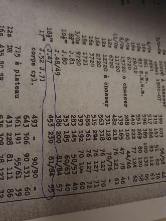

I believe but I'm not 100% sure that the Ronda catalogue has a column "mod" and code "B" is used for non-rivited staffs. My printout doesn't have a legend explaining the different model codes..
The dcn catalogue apparantly shows a "/" between de F and G value to indicate there is a taper. Mind you, the Ronda and DCN dimensions are not always the same as you can see in the photo's.
I attempted to measure the distance between the cap jewels and came to 2.78 mm. Some of the DCN staffs in stock at Cousins do come close and are marked "à chasser" with F/G measurements, which I'm now convinced means they are tapered and friction-fit like you suggested @caseback.
I'll order a couple different ones and see how it does. Thanks everyone!
