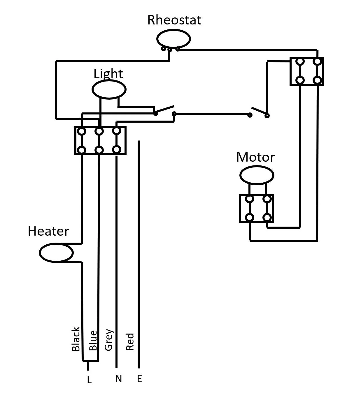

Sooooo…. Picked it up, no plug on it so couldn’t test it and worryingly some cowboy had extended the power lead using two different cables.  Im no electrician but looks dangerous to me… so now doubting if it is a runner at all!!

4 hours ago, AndyGSi said:
Not sure what flex has been used to extend the cable or how it was wired at the plug but from the
below from another website (trusting these colours are OK) it looks like the N & E were swapped.
Should be simple enough to bell out and check.
Surely this isn't the wiring diagram for the machine bought Andy. Theres not a single correct connection to that extension.
Bigjay.....make sure you trace those wires through the machine and label them up with our current cable colours. Or rip it all out and start again,  regardless of what you do plug it into a circuit with rcd protection please.
It all depends how it was wired at the plug but expect that's why it's been sold as the
seller made presumptions based on the wire colours and couldn't get it to work.
Edit
Looking at the video my major concern over the wiring would be that the earth just appears to be connected to the rheostat.
Edited by AndyGSi

11 minutes ago, Neverenoughwatches said:
Its a fair bet to assume the plug wiring has been done correctly for the old UK  colour codes, which might result in live feed to the casing,  oh my !
Anyone would just label up the machine's wiring correctly , wouldn't they ?
If the plug was wired as Red-Live & Black-Neutral as the Red only goes to the rheostat
then yes I'd expect at least the top part where it's fitted to have potentially been live.
In the past nothing was labelled and there was no standard for colours.
An experienced electrician would know exactly which wire goes where. Which leaves diyers in a potentially dangerous position. What does it take to slide some coloured sleeves over the wiring, might just save someone's life.
