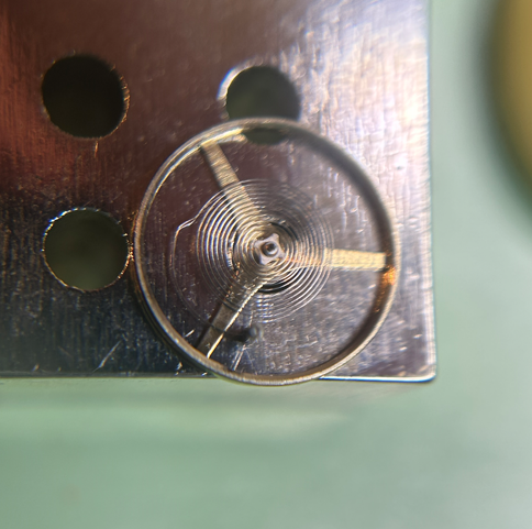

Hi,
Could someone please explain the proper way to adjust the beat error on these ? I've only ever done it on balances where the hairspring collet has a groove and you can just use a screwdriver blade to move it one way or the other. I've managed to move this one (I think) with a strong pair of tweezers but I damaged the hairspring badly at the same time... Hopefully there is an easy way to adjust these. Beat error is around 8+ ms so I can't really leave it like that..
Thanks,
Elie
Adjusting beat error by moving the h/ spring collet is not for the inexperienced.. Here is vid but be aware one tiny slip of the screwdriver and it can be fatal.

Tfy lifting the collet a touch to loosen its grip on staff's collet taper
Thanks for your input. The issue with this specific balance is that the hairspring collet doesn’t have a groove/space in the collet to fit a screwdriver blade, the collet is sort of square with sharp angles.
