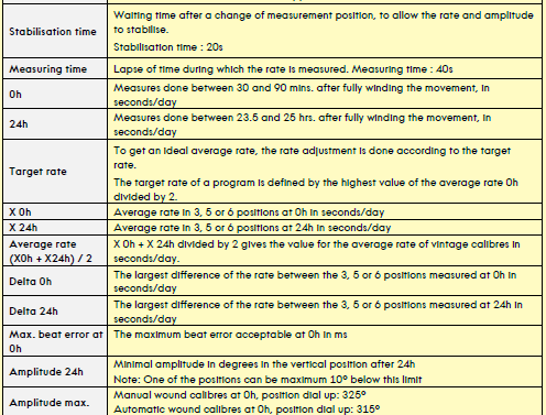

On a 'quality' watch like Omega, most would aim for 270° amplitude or more (the last 620 I serviced I got 295°). For a beginner, I would say aim for 240°+. It's not so easy on small ladies watches like this, as the small size means that any imperfections have a bigger effect. Also watches with smaller balances are generally less accurate.
A drop in amplitude from horizontal to vertical position of about 40° is expected.
DU and CD positions look great, but the -32s/day looks to be Crown Right : which is not a position the watch is usually in. What does it look like Crown Left (one of the test positions)?
For the 620, Omega don't show an initial amplitude when wound, but list a required amplitude after 24h as  160° 😲 (which is enough to send many who post here in to shock).
It also shows the Delta 0h as 40s. This is the difference between the lowest and highest values in the positions tested, which are 3 for your watch : DU, DD, Crown Left.

Timekeeping specifications are always interesting and now that people have nifty timing machines that are affordable amplitude is now number one at least on the discussion groups.
Then timing things PDF is attached with how to do all the nifty calculations if you really want to get obsessed with nifty calculations. It's so much nicer feel the timing machine that does this for you but typically there very expensive especially if the microphone rotates around to all the various positions.
Here is an image out of a vintage timing machine manual for timing specifications. Notice no amplitude as cheap timing machines that measured amplitude did not exist. That's also why you cannot find listings of lift angles for vintage watches unless somebody today measured that which is easy to do because they didn't have a nifty timing machine that could do amplitude
Then while some of the Swiss companies do have timing specifications for their watch most of them are Swatch group which means you'd not going to see the entire sheet at the best you might see a snippet. In the case of Omega I think almost all the watches have been time except they do have a generic category. So this would basically be timing for a nice all of the watchThen of minor amusement depending upon which version  in other words they kept updating this the Stabilization and measurement time seems to very. With no problem with their longer if you go too short on these you can end up with timing issues. Like moving the microphone really fast and not allowing it time to stabilize that will be an issue and usually if you run the timing in a position longer things will stabilize and be better plus of course you can change the averaging time in the machine to longer time interval to smooth things out.
