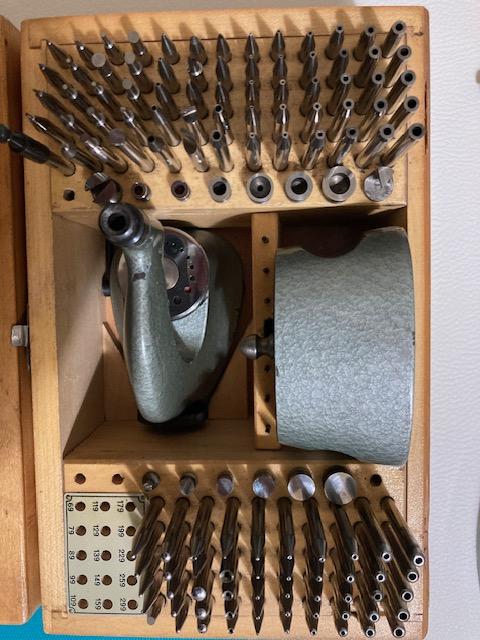

As of today I stand corrected - I just picked up my new Boley Staking set 🤩 (from a private seller -> his grandfather was a watchmaker). Do you think it possible to use it instead of a jewelling tool to press out and in the jewel?
Great staking set! I have the exact same and love it. Congratulations on an excellent buy.
Is the jewel aligning with the metal? If so, maybe you could. If it's not, there's no way you can control the depth of the jewel with the staking set.
I've never used a staking set for jewelling, but I think I've heard others do it. But obviously, a Seitz or Horia jewelling tool should normally be the safer choice.
Not this type really, It's not something I would attempt, I'm sure there are those that do and certainly did do it without a jeweling tool. Friction jewels do need to be positioned accurately and set to the correct depth required, which is why the jewelling tool is used and was created, amongst its other uses.

@Knebo: great to know that you have the exact same type of staking set. However on mine there are some empty positions Anvils(?) + the numbering 179, ... 109. Do you have an idea what could be missing on my set? Do you have some pictures? My guess is that my set is from the 70´s or do you by chance know a preciser date range? Thanks!
Hey @cor9brg
Don't worry about the missing stumps/anvils. Not so important and you have plenty of sizes (plus the flat stakes that can be used inverted). I actually have more missing ones in those inner rows.
The pocket in the front right (69-209) is for reamers. I think these were an add-on option because most sets I've seen (including mine) don't have them. I have reamers in my Seitz tool, so no need for me.
Here is the manual:
Boley set.pdf
(I also don't have the jewelling adapter. My Seitz for that again.)
