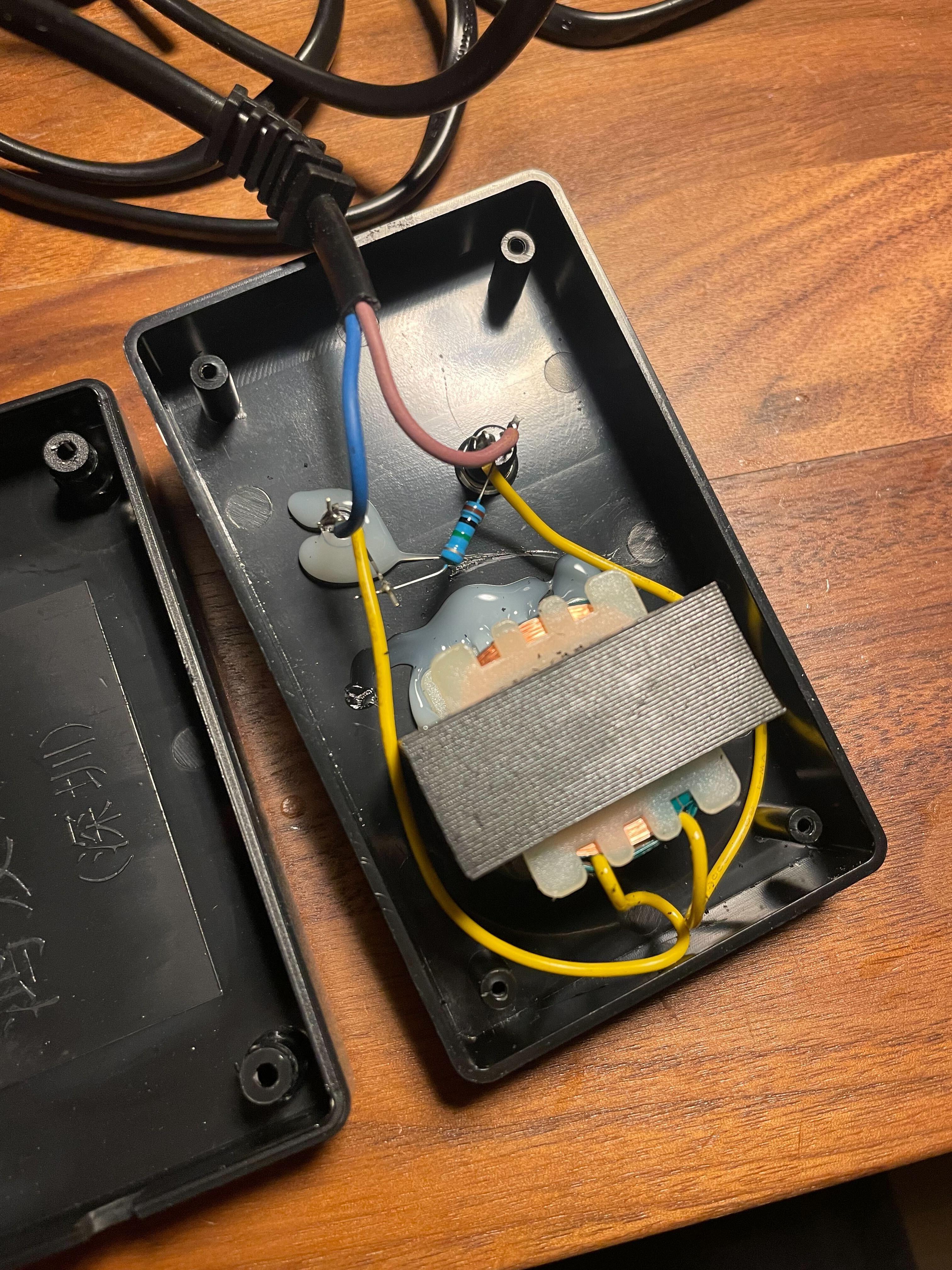

@JohnR725 the demagnetiser came in and here it is with the lid off. Nothing too crazy but looks like a transformer to generate the electrical field, a momentary switch and some electronics that I assume is doing the switching for the collapsing electrical field.
I put my tweezers on it to see if it worked as they cause everything they touch to stick to them. A couple of things to note:
1. it moves the tweezers as it activates. Clearly the crosshairs are there for a reason to make sure the object is centralised.
2. I moved the tweezers 90 degrees in between button presses. No idea why I’ve just seen someone do it on YouTube
3. it completely removed all magnetism. Result!
Edited by neevo
Unfortunately this device is not electrically safe and could not be sold in Europe (certainly Australia, too) legally. However no one cares.

You can see the input wires to a transformer and then full wave rectified so at low voltage and DC it's perfectly safe.
I am afraid you miss the problem totally🤔
Beyond, these devices use rectified mains voltage, which is doubled then (~600V).
And a transformer is visible nowhere.
Frank

Sorry Frank, I don’t understand you here. There is a honking big transformer right slap bang in the middle of the unit.
Tom

Looking further into the photo I suspect that they have just wired the primary of the transformer to be the magnetic coil. Looking at the remaining components there does look to be a rectifier cct of 4 diodes. Maybe the potted box at the bottom right corner is a capacitor (hefty one).  This would lead me to think this is some form of capacitive discharge cct. Not at all sure if there is any low voltage side with potentially 240V rectified going to the switch.
Tom

I expected this would be a transformer with the rectifier diodes on it's output.
Be interested to know the voltage on the bottom of these diodes.
Would also be interested to know what voltage this Cap & Relay are?
Edit
Just realised from the number on the side of what I thought was a transformer is actually a polyester cap
Edited by AndyGSi

what I was curious about is how closely does it resembled the Elma. I have one lurking around here is supposed to be fixing it just didn't quite get around to it. Then I know I posted the pictures on the discussion groups there lurking someplace. Then occasionally thinking about it yes it is a different circuit board because there is a rather live sizable he physically large motor starting capacitor that they were using the charge up to discharge through the coil.
Basically with any of these units you want to keep your fingers away from things. They usually charge up a capacitor with depending upon where you discharge and lethal voltages and then discharge it through the coil C as well be careful not to put your fingers in a place where it could go through you. Similar to the old photo flash circuits found in cameras you can charge up a really nasty voltage and those capacitors before it fires the flash tube. Or it's really amazing what you do with a couple of tiny batteries and a capacitor.

The most likely dangerous fault by far is one of the mains wires coming loose inside the unit and touching the chassis of the button. There's no other metal on the outside of this unit as far as I can see. I'd consider replacing the mains wire with one that carries ground and grounding the button chassis.
