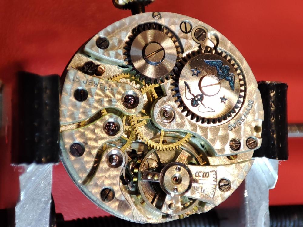

The watch has a 10.5''' AS movement bearing the overlapping TR shield - I read in an old post from the late great Ranfft that ESA used this "almost only" in 1936. The case is a gold Dennison Cachecase hallmarked 1929. The watch was bought new in Newcastle, England, and the only other branding on it is a "Rotary" logo on the ratchet wheel.

This was my Great Aunt's watch so I'm being very careful. At least I can stop the gold case from being its doom for one more generation! I'm busy servicing it - hopefully it'll be a nice talking point for my wife to wear on special occasions.
