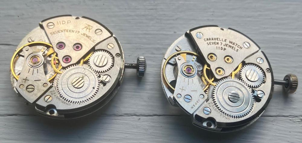

Winter in NH.  -3c this AM.  Wood stove warming up the shop where I have my starter workbench.   I will list my tools at end.  In truth, I need a push as I am unsure what direction to embark upon next to develop my skills.  Youtube videos make things look easy.
I bought a ST36 and tore it down, reassembled 2x.  I have revived some quartz movements by buying donor movements and swapping movements.  Good lessons on hand replacement!  My next step was to acquire low cost Caravelle watches on eBay using the "Homer" movement aka Citizen 0421.  They seem to come in 7 and 17 jewel construction. No date, no automatic, simple.
Some arrived with broken parts, rusted parts.  None of them ran for long.  I tore down 1 all the way.  I left the main spring alone due to lack of tools.  Put it back together and it runs for 1 minute, 5 minutes and then the balance stops abruptly.  I did not lube anything.  I bought 9010 but...have not used it yet.  Cleaning.  White stove fuel.  IPA.  Pegging.  Quickly dipped the shellacked items in IPA, air dry, reassemble.  Click spring kicked my a$$!
Lessons learned.  Keep my work area clear, uncluttered.  Parts holder...I got the icecube tray type...deep...hard to see into each compartment, might try something different next time where parts are all easily seen.  Sticky summer, parts would stick to hand, arm.  Don't leave parts on mat.
My starter stuff.  I don't think it is a lack of tools.  Lack of diagnosing skills.  I was thinking of getting a better iPhone magnification tool to share what I see and get tips, advice.  Switch to old Waltham pocket watches?  Or, tear down all my 11DPs and build one from all the parts?  Buy a missing basket, buy the cleaner solution and get a real clean?  Have my local watch guy just clean and service my main spring?   I am stuck.
Horotech screwdriver set, Dumont tweezers, Timegrapher, Bergeron 4040, Rodico, Pithwood, Bergeron hand tool, L&R Master but no cleaning basket or solutions yet.  Craigslist lucky find.  Cheap oilers, many loupes 2.5 to 10x. Cheap demag.  IMG_4663.thumb.jpg.584142539b440f87bda86f6234e4142a.jpg

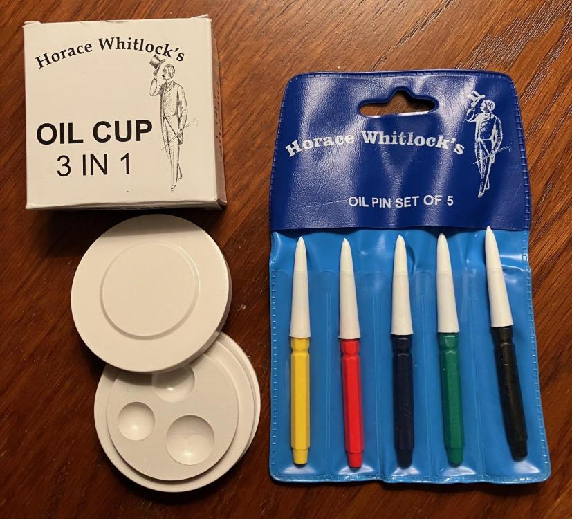

So, I used my cheap oilers and my 9010 for the first time
Does this mean you've never been lubricating your watches when assembling? If not, you should really focus on practicing that. Correct oils/grease, oiling points and quantities are a big and fundamental thing to learn.
Well...  Correct.  I have not begun my oil/lubrication journey.  Not sure where I read that beginners should just strip, clean, reassemble dry and see if the watch will run.  I guess this is the "safe zone" moment as everyone thinks "what a dummy".  I can handle that.   Below is what I have for oiling.  9010 and this beginner set.  I assume the colors have a standard meaning.  Smallest to largest is Black, Blue, Red, Green, Yellow.  More learning.  Lubrication is such a debated topic.  If I were to ask what to put in the last two cups, as a next step to 9010, will I get 8 different responses? Some grease I know.  If I recall I concluded 9010 was a first best decision and I guess I kicked the grease decision down the road.  Seems the time has come to buy two more to start.
This came with a clock I picked up at a garage sale.
The oiler colors are not really standardized, though I might guess the black one is the finest. Maybe.
In addition to your light 9010, get some HP 1300 as a medium oil and Moebius 9501 or 9504 as a heavy grease for sliding and high tension keyless works parts.
Or Moebius D5 and Molykote dx as the cheaper alternatives to those, though the 1300 and 9501 will have a longer lifespan in your watches.
But the trio of a light oil for the balance and fast wheels, a medium oil for the slower wheels and rotating parts outside the train, and a grease for high tension or sliding parts is mostly sufficient to get started.
You should be able to find a service guide for the 6497/6498 movements which will show you exactly where to put those three lubricants on your ST36.
Here, I'll save you the effort ETA 6497.pdf

The title of your thread included "next step". I'd say, this is most definitely your next step. Without any lubrication, it's not surprising that watches don't run, or stop after a little while.
Find the smallest oiler (probably black) and work with that one only, for a start. Better to apply small quantities twice, than overdoing it at the first go. Adding is easier than removing.
I agree that this is sound advice on the lubricants to get. I got the same ones and they'll last until I die. Don't think about price per gram or ml. Only the absolute price of the smallest available quantity matters. You'll never need more than the tiniest bottle. E.g. CousinsUK sells 2ml of HP1300 for 17.55 GBP and 20ml of D5 for 27.95 GBP. So HP1300 is way more expensive per ml, but in absolute terms it's cheaper. And 2ml will last you a lifetime.
You may be partly right with that, but I don't think there's a debate about the 4 essential types of lubricants:
- thin oil = 9010. Check.
- thick oil = e.g. HP1300 (which, I think, most would recommend)
- grease = 9504 is excellent, but not the cheapest (but I think, it's worth it)
- special oil/grease for the pallet fork = 9415. Unfortunately, there's a forth. I've heard that some people use 9010, but it's not ideal, I think.
...and when you get to automatic watches, you need a breaking grease. Later..
..and Epilame/Fixodrop. Well, this may be another debate.
