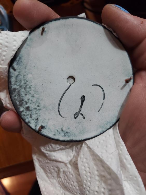

My mom has a chinoiserie clock ("Chinoiserie" is the term for the paint/decoration style on the case) that she wanted me to take a look at. She's pretty sure it's an Asprey, but the only markings on it are "Made in England" stamped on the underside of the case, and the same printed on the enamel dial.

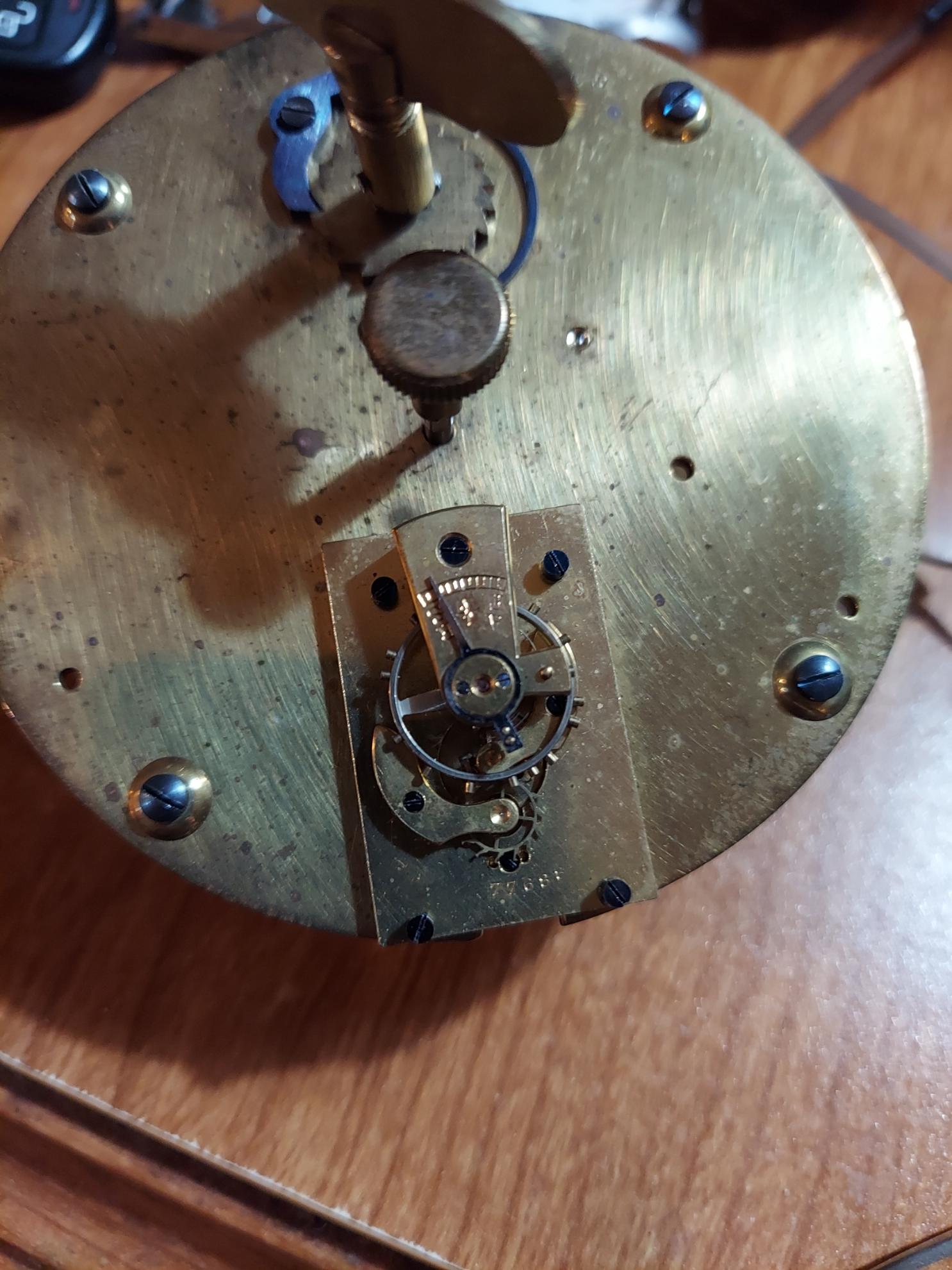

Pictures below. I was instantly interested in it because it has a watch-type balance and escapement that hangs on the outside of the rear plate. The escapement and some of the movement is jeweled.
I can't find any hallmarks, but the back of the dial has some kind of mark I don't recognize. I'm not sure if it's relevant or just a batch mark for when it was being made or something like that.
The clock is really pretty. It doesn't run, but it really wants to- if you nudge the escapement it ticks for a few seconds, then stops- I think it's probably just in dire need of a good cleaning. The wheels all turn when the setting stem is turned, the balance, escape wheel and pallet fork all look great. The pallet fork jewels seem fine also. I swear it's like a pocketwatch writ large.
It's a left-hand wind. There was a lot of wind in it when I got it, and letting the mainspring down was nerve-wracking. The key is screwed on to the winding stem and I used it to hold it and let it down slowly. Only barked my knuckles once.
I've got it partially disassembled, but I haven't dived into removing the plates and getting the inner movement open. I believe the plates are lacquered. They're shiny and completely without any tarnish. There's a little pitting on one of them, but not significant and not near any of the parts.

Clock is totally torn down, with the exception of the mainspring, which I left in the barrel. All the movement parts seem very clean and are totally undamaged. The pivot holes are pretty dark and look dirty, but they're not worn as far as I can tell under a loupe. The pivots are all intact and look clean, although some of the wheels are slightly tarnished. It's an extremely simple movement.
I think I can just wash everything in very hot soapy water, scrub it with a softish brush (toothbrush maybe) and then dry it with a hair dryer. I'd like to disassemble the mainspring but I don't have a winder at the moment.
The only jewels turned out to be in the balance and escapement assembly, on the little plate hanging off the back.
Interesting thing: There are absolutely zero identifying marks on this movement. I half-expected to find hallmarks or other stamps on the parts inside the movement, but nothing at all. There is a serial number stamped on the back plate, and on the balance plate. The little bridges that hold the escape wheel and pallet fork have numbers on them- single digits.
But that's all. It's a mystery who made it, and although it looks a lot like an Asprey I'm starting to think it may not be, because I've not seen one that doesn't include their name on it somewhere.
No telling if this is an Asprey they normally are marked on the dial. What you have is an 8 day time piece with  an enamelled dial roman numerals and the hands in the style of spade. Sometimes they are called drum clock movements as the whole lot just slides into the case and held in place by screws. It has a platform escapement of low quality because of lack of jewels, escape wheel pivots and pallet pivots are not jewelled, so look for wear on pivots and pivot holes.
Cleaning this type of movement. The platform should be cleaned in a watch cleaning machine including the screws. The clock movement all the brass parts should be polished, I always used Brasso and polished up with a clean rag then washed out with petrol and dried. There is no need to lacquer the plates as no one can see the movement. Use pocket watch oil on the platform and a good clock oil on the movement. You should remove the mainspring with a clock mainspring winder, check the spring for wear at the ends and make sure it is in good condition, if it is out of shape and looks tired replace it. I would say this is Edwardian the chinoiserie is poor and there isn't much of it most clock movements from that time lacked the quality and finish of clock movements from Victorian times

Thanks for the info. It does have jewels in the escapement and balance assembly, including the pallet fork, but not in any of the rest of the movement
I'm not going to apply lacquer, but I would like to keep the existing intact.
Got the clock disassembled for cleaning and found the bottom balance pivot is missing a jewel- the cap jewel is there but not the pivot one.  It will run for several minutes even without it.
