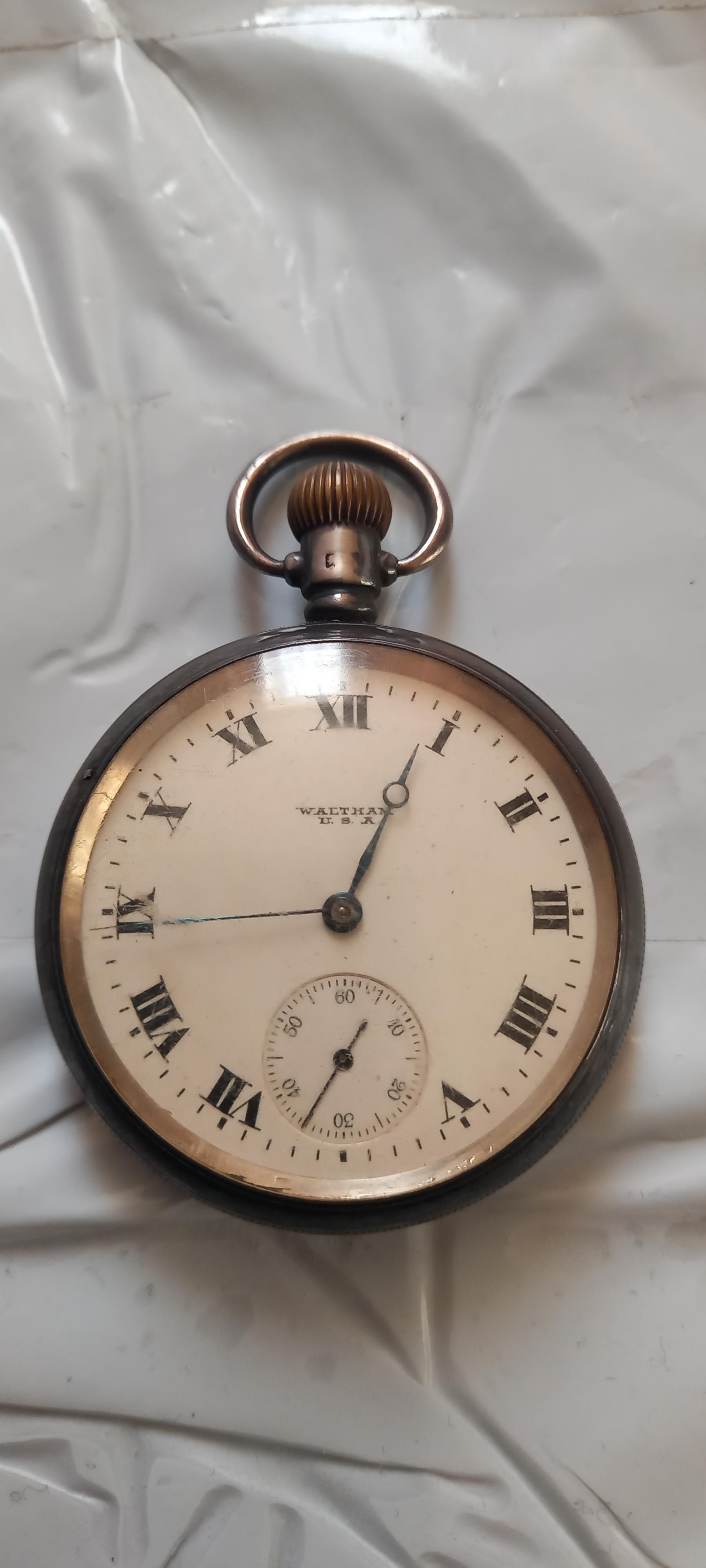

My first Waltham
Welcome to the Waltham club Rich !

2 hours ago, AndyGSi said:
Looking at the hallmarks I'd say 1924.
Thanks Andy, the production run on that 1908 model serial number is estimated to 1919, so a little discrepancy with the case date. Unless it was sat on a shelf in either UK or USA stores waiting to be ordered and cased up, I will check to see if the case has any numbers relevant to the movement.

Thanks Mike, the movements just look so quality compared to nearly all the Swiss stuff I've worked on. Yet to view it in detail with magnification.

Scrolling along, your last photo came as such a surprise to me, as I am not used to seeing an American watch like this with an English-style dial like that. The broad blocky Romans; you'd never find a dial like this on a Waltham over here.
What about the hallmarks in the case isn't that more of an English thing also? Both Waltham and Elgin exported oh block of watches especially to United Kingdom where they actually had a distributor. Elgin got even more creative with their exported watches as they sometimes don't look like American pocket watches that are more like three-quarter plate watches. Many times the only have the serial number and on rare occasions the England distributor will actually engrave their name on it hinting that they actually made this watch when they did not. So basically United Kingdom should have a lot of Waltham and Elgin watches if you know what you're looking for.
I definitely noticed the hallmarks but assumed assay was just part of import requirements (or the case was English made to begin with)

The case could quite easily be English seeing that Dennison was an English company based in Birmingham who later opened shop in the USA.
Tom
There are no serial numbers on the case itself that tie it to the movement, which would have been nice. Only a matching caseback and bezel four digit code for those two pieces of the case. So the 5 year production difference between the movement and case could have a few explanations.

If the case is original then its likely that it would have been made in the UK as standard to avoid the import duty of precious metals. Providing that this watch was made for UK export and not carried into the UK by its owner. I thought since it's assayed here then it was made here.

It could be either, but doesn't make sense to have the case made overseas and have to pay an import duty. Unless the buyer specifically requested the case to be made by Dennison in America and then assayed in the UK after importation, that just seems like a crazy idea. So almost certainly had the case made in the UK. Interesting that you mention the dial style is not synonymous with American owned pocketwatches. The dial has Made in USA under the bezel edge besides along with the Waltham name at the top. Another inducation that it was specifically aimed at the UK market that was used to that style of dial marking.
7 minutes ago, AndyGSi said:
If the case was imported then it would have the import mark.
Thats new to me Andy , I didn't know assaying towns had a seperate import stamp. Its been worth the thread for that information alone 👍

I had to look at the history, because Aaron Dennison (American) was a world traveler and his name ended up in or on a lot of American, some Swiss, and apparently at least one English company. Wikipedia says the Birmingham Dennison Watch Case Company was the supplier for Waltham's London office.
This is especially interesting because while I would expect "Made in USA" it to be under the name, having stamped it elsewhere does seem like an indication it actually was made over here. I haven't seen another dial like that for sale.
I thought I would remind everybody of something. Typically when buying a pocket watch we assume it comes with a case but in the early days of American pocket watches they did not come with a case. There were several reasons for this initially the watch companies were not in the manufacturing cases for their watches. Then there other companies manufacturing cases so when you purchased your pocket watch you picked out the movement and Then you can pick your choice of cases. This was true in the early days at some point time they would start the case up their watches but not right away.
So knowing of this more than likely the movements were exported without a case. Then there were cased up in the UK and I don't know one other parts the world how they handle that. I do know they had export agents quite a few countries including the UK.
Oh and then of course there's the other problem with pocket watch cases they wear out with time and often times people will swap from case to case. A lot of times if you look at the outer edge where the case holding screws go you'll see that there'll be other marks where they be another movement had been the case before.
@JohnR725 indeed, my grandfather told me of when his father took him to a jewellers shop to get a watch for his 21st, something of a family tradition, he got to choose his watch, dial, hands and case also whether to have the jewellers name on the dial. This is a Swiss movement and a Dennison star case. In different conversations over the years I do remember him telling me of people replacing worn or damaged cases. I do think that in this modern world we forget that at one time watches really weren’t the remit of hobbyists but an important day to day tool.

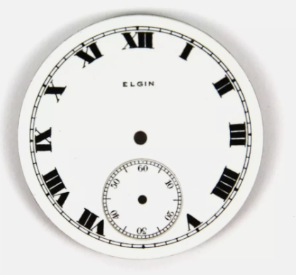

I've been combing ebay tonight and while I have found a couple of block Roman dials like yours, they are a teacup spilled in the ocean compared to the more common thin Romans and various typical Arabic numeral styles. Now I'm going to want to build a watch with one of these. I dislike the tall, thin Roman numerals on most American watches but these have a nice presence.
A 12 size including "U.S.A", a 16 size without it, and also an Elgin (I found even fewer Elgins overall)
