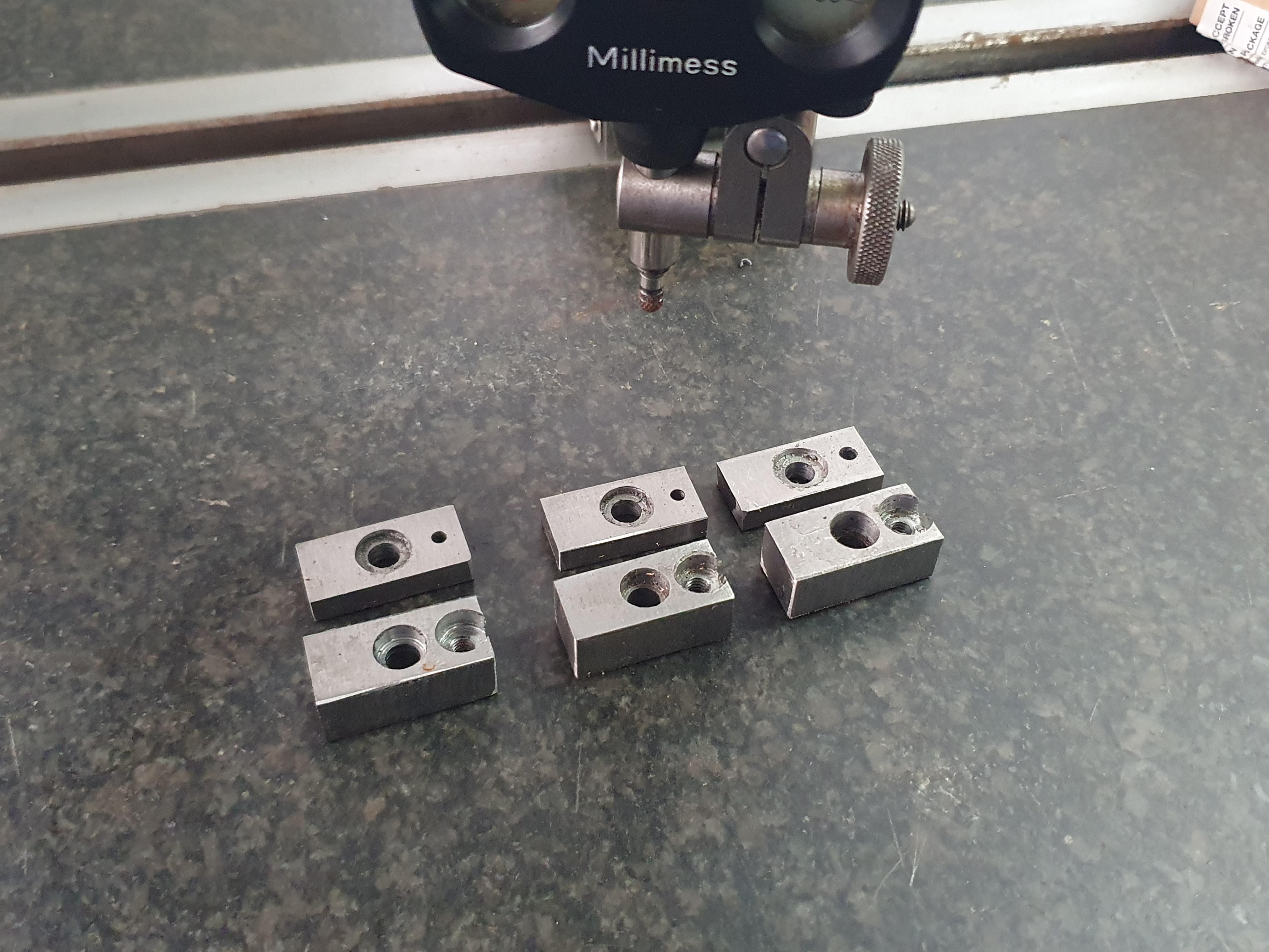

The clamps will probably be machined from ground flat stock to skip some steps, but I could use coarser stock as well as I have the tools needed to do the grinding myself (surface grinder, granite plate)🙃.

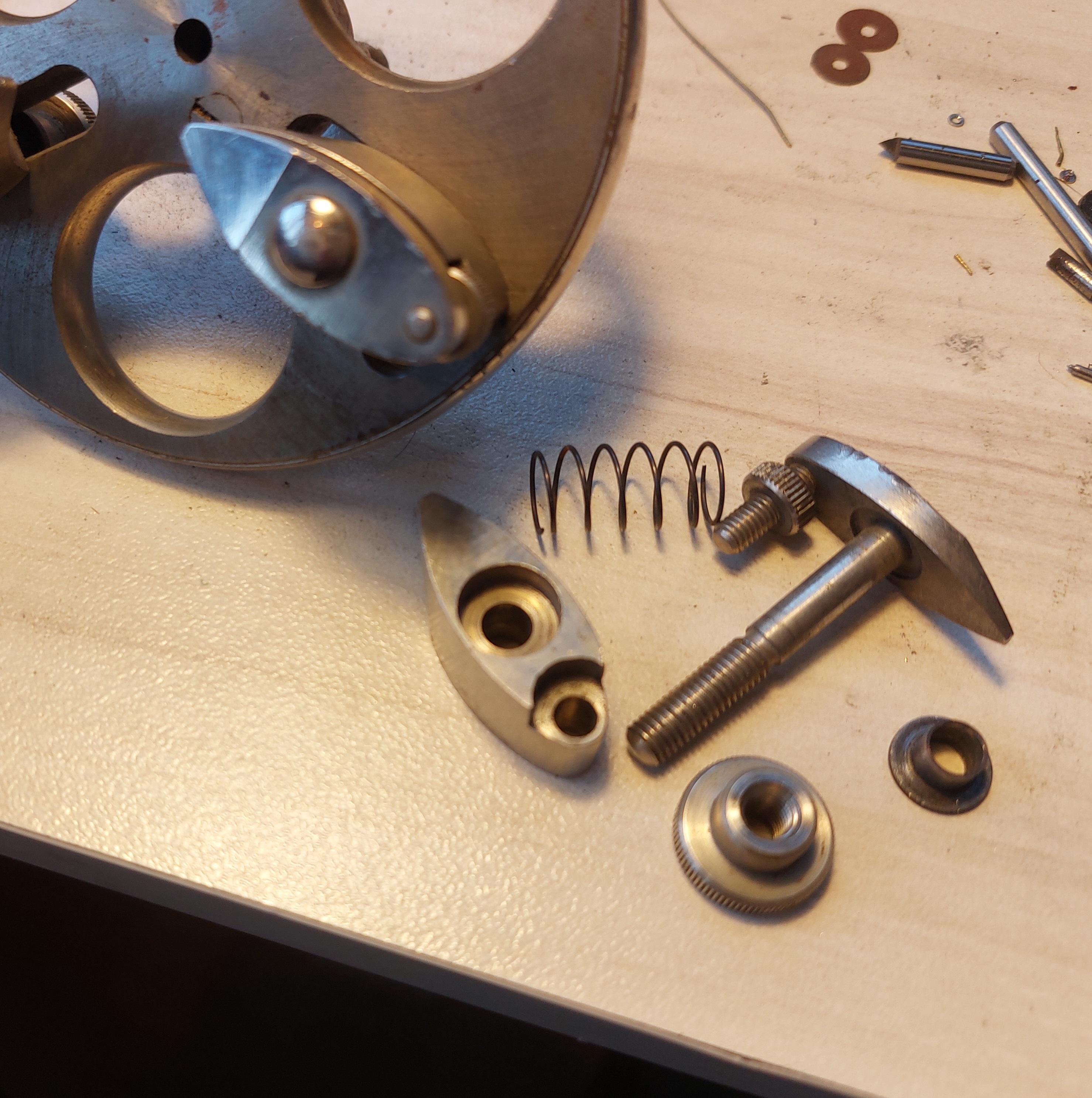

All the clamps I have used have been a variation of some sort of this one in the photo (two clamps there, one assembled one apart). The jack screw is to allow the clamp to contact the part parallel, which increases the clamping area and also reduces the chance of dinging the part.

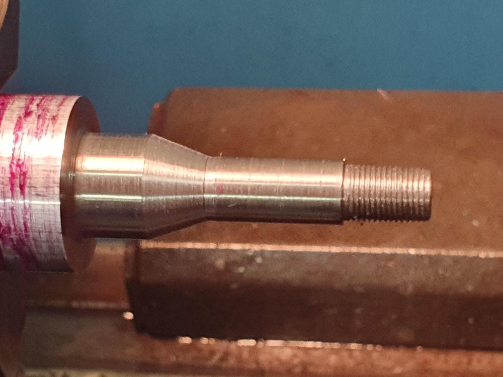

I do do quite a lot of faceplate work, and many years ago figured out that I prefer the setup in the third pic. The part is glued to a brass support (second pic), which is centered on the plate optically and held with simple clamps. I can glue and unglue newly made and delicately finished parts with no damage, and also handy for small or odd parts (I think that's a LeCoultre 409 mainplate on the support).
Is there an advantage with this set-up compared to just a big brass wax chuck ?
Well, it's essentially a big-ass (haha) wax chuck. The advantage is being able to glue parts on conveniently; I use super glue (Loctite 480), then the brass block goes in acetone and a few minutes later the part is off and clean. Since I knock around the block to get it true on the faceplate the part is never at risk.
I used to do a perpetual calendar where every hole for a jewel in every bridge got "uprighted" in the faceplate. 11 on the movement side, about that many on the dial side. Mainplate I would screw down to a similar brass block that was purpose-made (I did a lot of these); I could do all the holes in a couple of hours.
