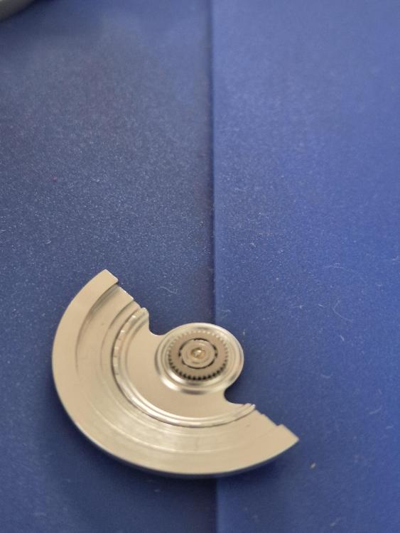

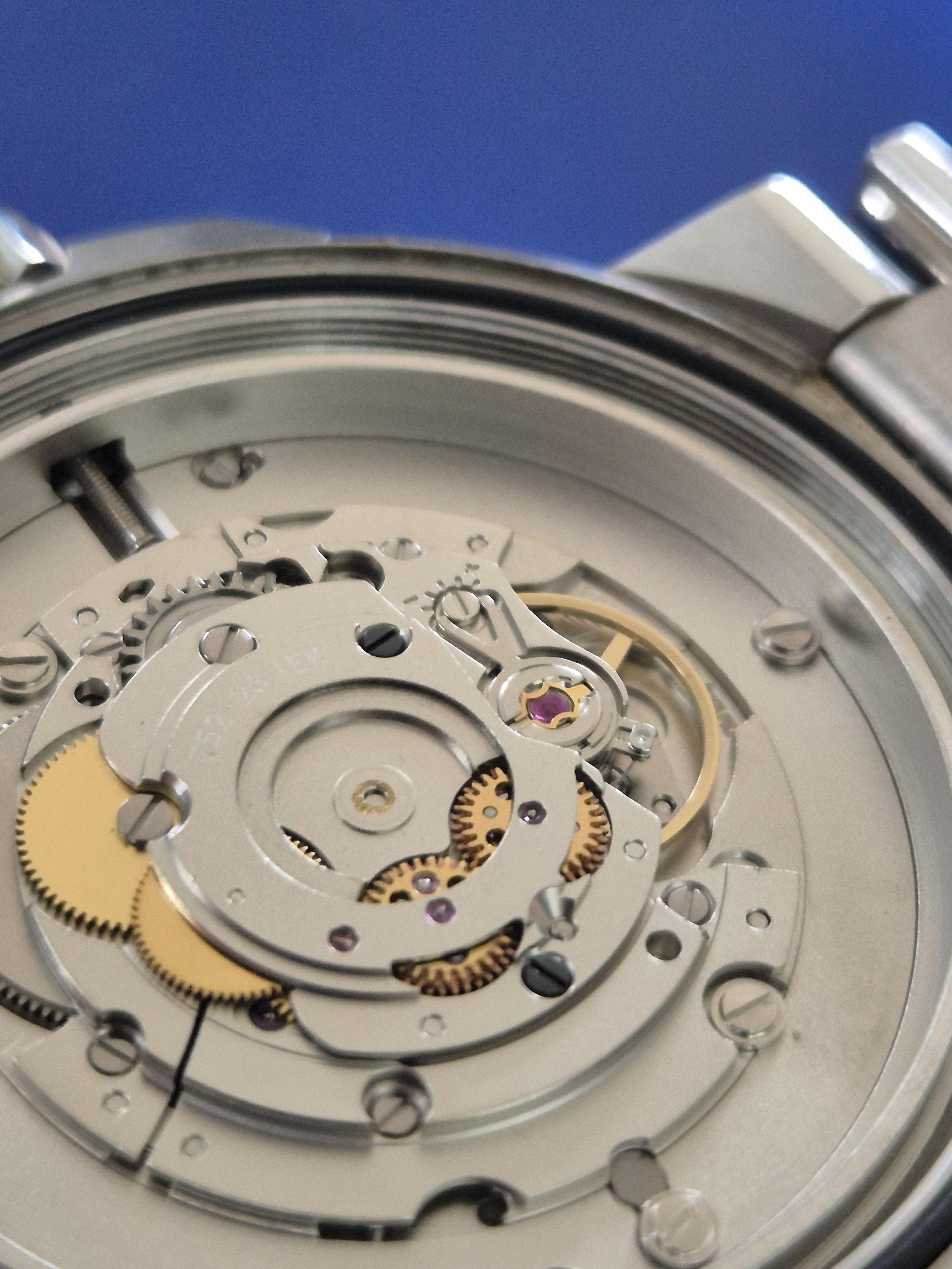

Anyway, I used it this week and I noticed that it stopped after 2 days of wearing it more than 12 hours per day. I tried to shake a little bit to make it start but stops after a few seconds. When I tried shaking it for 1 minute, I noticed a clanking sound inside which I never heard since new. When I opened the back since It's out of warranty I noticed the rotor was loose and when I tried to screw it in I can't lock it.

Trying to work out how it was fixed in the first place.
It almost looks like it was glued in place?
Edit
Is the screw still in place on the weight?
It looks like the boss has broken off the automatic bridge.

Thanks for the reply. Yes. The screw is still in place with the weight/bearing.
My watch was never opened since I bought it new from the watch shop with 3 years warranty until 2022.
Do I have to change the whole thing or just glue it back?
The raised part in blue ( boss?) is missing. Maybe it ia still attached to the screw. Can I try to remove it and just glue it back with superglue?

I expected that's what's already been done once before looking at the residue on your photos.
Depending where you are and what experience you've got it's a simple fix to replace with a new bridge.

Maybe the resolution on my phone is not high enough, but I don't see any glue residues. It looks more like metal fatigue or defective brass.
Was the watch dropped, received any hard bang or abused in any way? If not, Oris should replace this as it is defective manufacturing.

The watch was never dropped/bumped.  I only very occasionally wear it and stays inside my watch case most of the time.

Yes looking closer again it does just look like a metal fracture.

Looks like the bearing has sheared off at the shoulder 😥, thats a real shitter for the OP. Bit of a weak design there, a black mark for Sellita unfortunately, why not a full thickness bush ?
