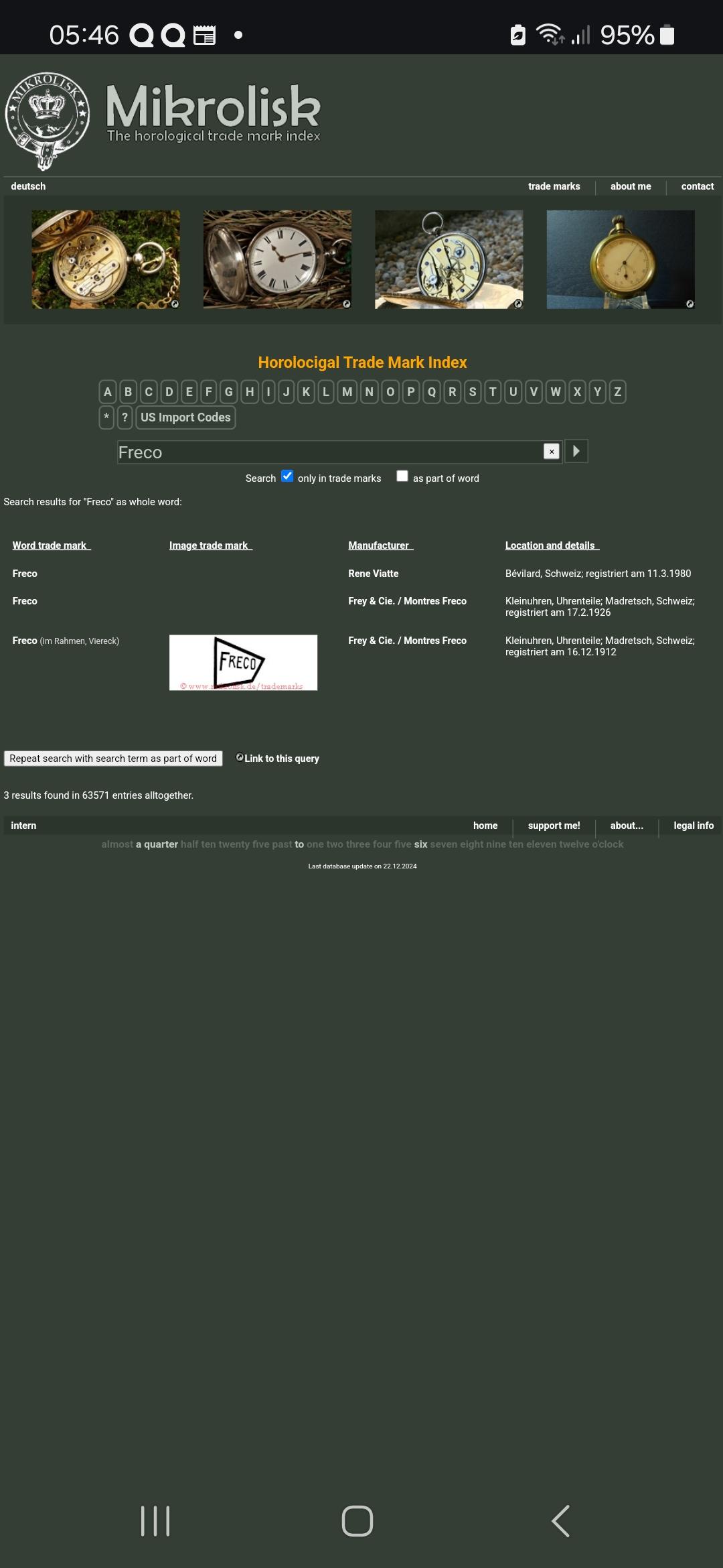

What movement is this?
Good question! No caliber number is visible on the movement. As you can see it's a Bulova movement on a Frey ebauche. The trapezium stamp near the balance says FRECO. There is what appears to be a serial number stamped on the dial side: 147604.

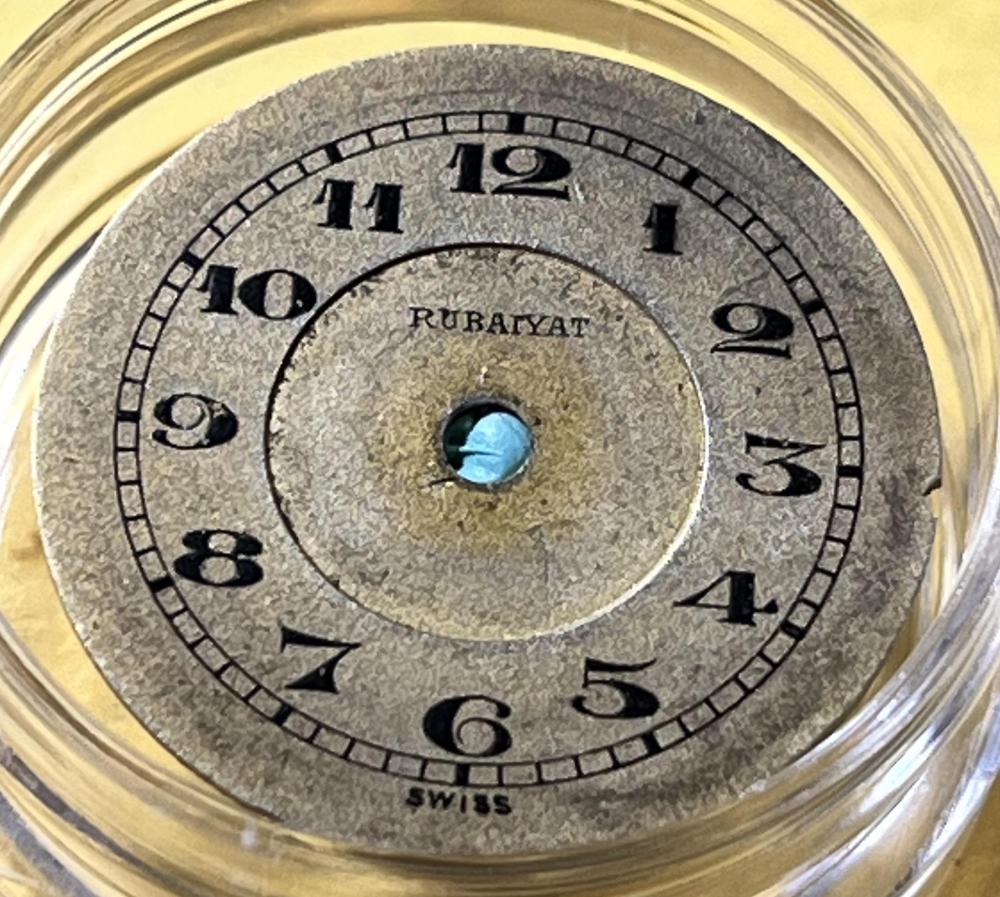

The dial also gives no clues beyond the brand name Rubaiyat and the word Swiss, which together with the "Bulova W. Co" on the movement give me an approximate date. (As best I can tell, the Rubaiyat brand wasn't used after around 1921, and "Bulova W. Co" was replaced by "Bulova Watch Co" in May 1923.)
It's possible there may be some more markings hidden by bridges, but I'll be surprised if that's the case.
The case has serial number 1020981. Matching Roman numerals inside the bezel (981) confirm it as original to the case, and there is no reason I can see to suspect the movement, dial and case are not all original.

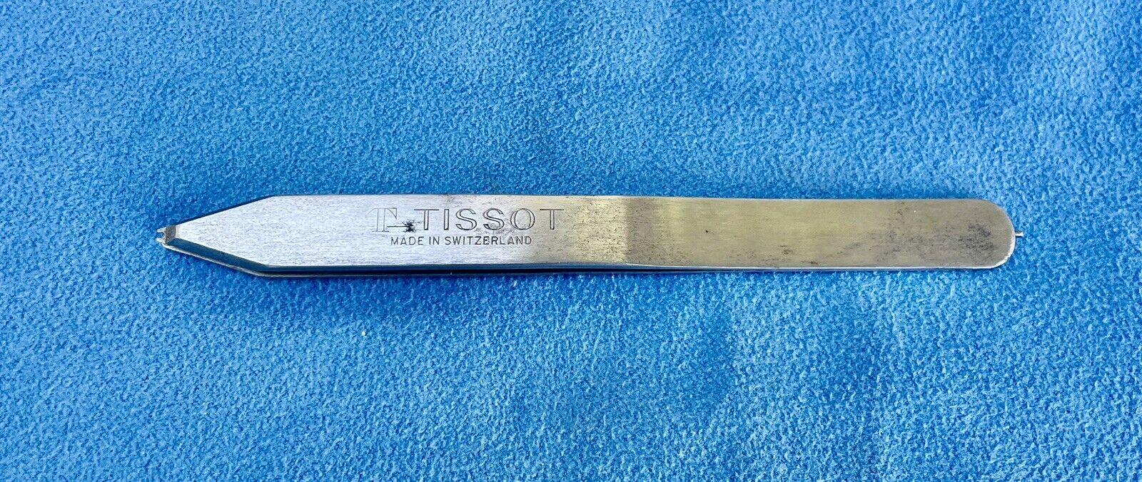

50 minutes ago, linux said:
Just pulled this from ebay:
It was listed as: pallet fork tweezers
If they are then I dont know in what way they are used.  I have that same pair of Tissot tweezers.  Very thick and sturdy, the tips have a fork and a pin and also a pin at the end of the handle. The tips are much too big for stud pin removal,  the lateral pin in one tip would interfer with a pallet fork. I have asked before what they might be for , there was no answer.
So you're saying they cannot be used to pick up a pallet fork (which is what I assumed they could do)?  Or are you saying you don't know how they could be used on the balance?
Both.
Ha ha.  So I'll scratch that off of my "tools to possibly get in the future" list" 🙂
I have actually no idea how they are used. Because they are so wide and thick I use them for checking barrel arbor sideshake and barrel pitch about its axis.
