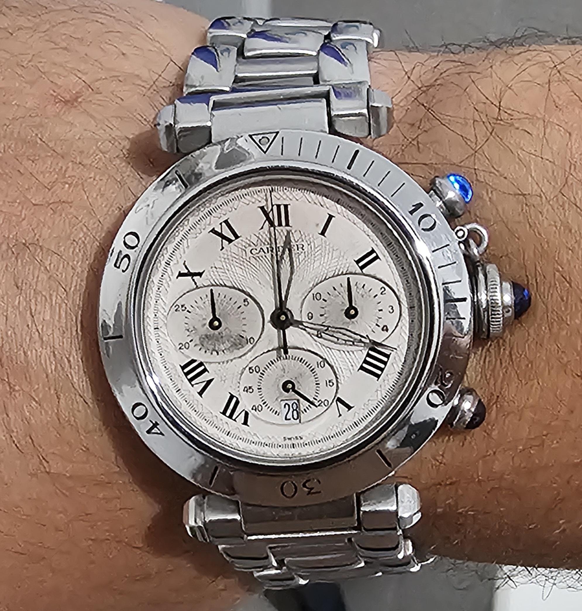

My cartier pasha 1050 1 from the 90s stop working . The chronograph function works but the time does not . I replace the battery but still same problem , i didn't find much information about the movement on the internet. If anyone knows the problem or know what causes it i would appreciate the help .

I repair watches for fun but I haven't seen anything like this, I think it would cost a lot of money to have it serviced at Cartier, I don't know if it's worth it and that's why I'm trying to repair it myself.

What test equipment have you got and can you post photos of the movement.
always helpful when asking questions about a watch is to give us a picture of the watch movement so we can see what you're talking about. his is because often times the movement was used in other watches and may conceivably have a different number that were used to seeing.

Hi, thanks for the reply
Here are some pictures of the movement and my watch, I know it was used also by Omega and Breitling

Omega and piguet appear to be using the same movement or similar movement as I do not know how exactly they are the same with a different movement number. I'm attaching the parts list from one of the companies in the service bulletin from the other. See you can see how they compare.

First of all thanks for the help and yes it is exactly the same movement
At a guess the movement needs a service.. However being a quartz it might respond  by freeing up the movement with one of these.  I have had many successful results with Quartz movements  using the “ Mechanic Line Free” function that simply spins the hands to free up a gummed up movement. For a cost of approx £24 worth a try. IMG_0944.jpeg.b96b73f32bbc4cb8b7151502da9d6154.jpeg

You need to be careful doing that on a Chronograph movement depending what facilities it has to reset the Chronograph hands.
