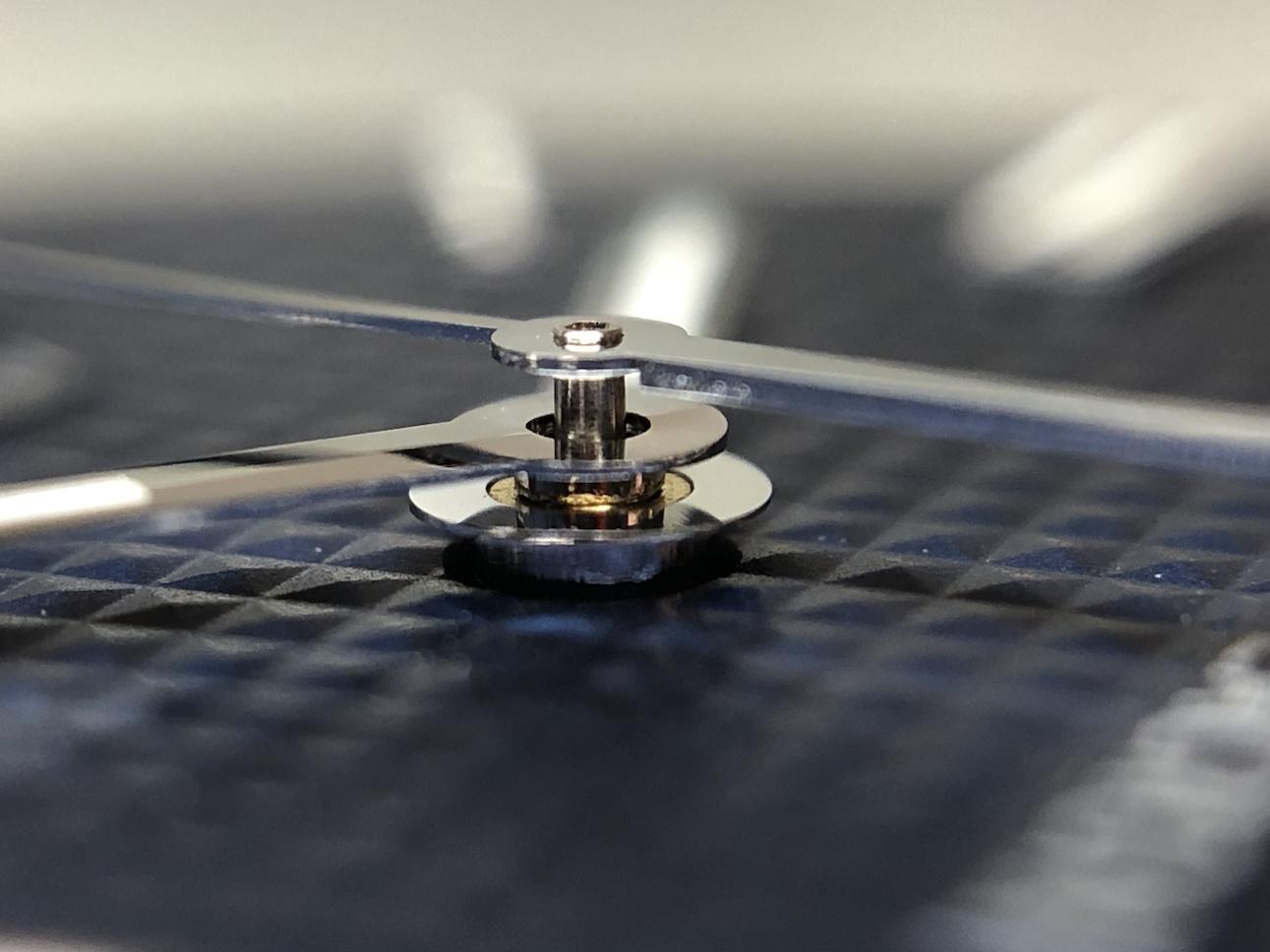

When I attempted to remove the hands using hand levers, I discovered that the angle of the levers wasn't steep enough to detach the second hand. Surprised, I took out my Presto tool but had to apply more force than expected.

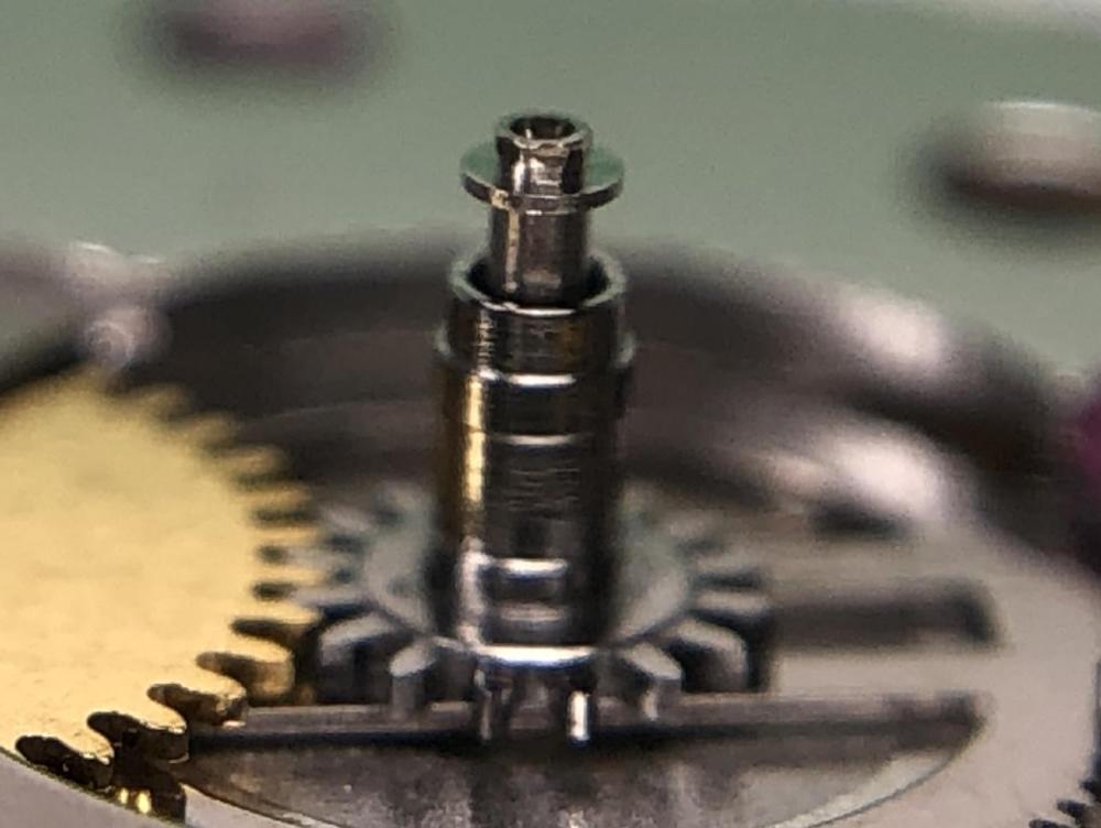

It turned out that the second hand was attached unconventionally. As shown in the images, a tube has been placed over the second hand's pivot, likely secured tightly, as the hand itself detached rather than the tube.
I feel uncertain about handling this and wonder if anyone has encountered something similar and how I should proceed with the disassembly and reassembly.

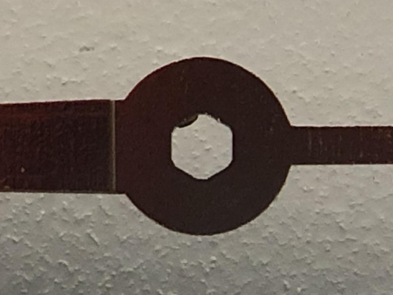

I dont quite get the locking bit though, the hole is hex shaped....how would it turn to lock ?
Could that tab just have broken off the tube ?
My thoughts were that the pinion doesn't look round and the gaps look about the same size as the tab.

I'm unsure how to proceed from here. At some point, I'll need to figure out how to reattach the seconds hand. Perhaps it can simply be pressed back on. I checked whether the hexagonal hole in the hand would now fall down on the tube, but it didn’t. I believe (or at least hope) it might still be possible to press it back into place.
The immediate issue however seems to be removing the tube from the pivot. I hope it isn’t glued or permanently attached to the pivot. If I can’t remove it, I don’t think I’ll be able to separate the fourth wheel from the cannon pinion and the main plate.

I don’t think that is the pivot Andy but the seconds hand tube sitting on the pivot. Common issue when second hands/sub-dial hand tubes are very tight.
@VWatchie I don’t think the caliber is very relevant tbh, more how do you get the second hand tube off without breaking/bending the pivot, maybe a pin vice would do the job.

Yes, I agree—this is the most pressing issue right now. I could attempt to use a pin vise or possibly try prying it off with hand levers, resting them on the upper edge of the cannon pinion.

I'd use a plastic disc in place of the dial and try levers.

Have you got an old credit card that you can drill a hole into or push a pin through and drop the card over the cannon pin.

Wouldn't that further compress the tube against the pivot, making it even harder to remove?

@Knebo I don’t think so as there is a ring on the tube, gripping that should work

I'd then expect the ring to deform when gripped and pulled.
