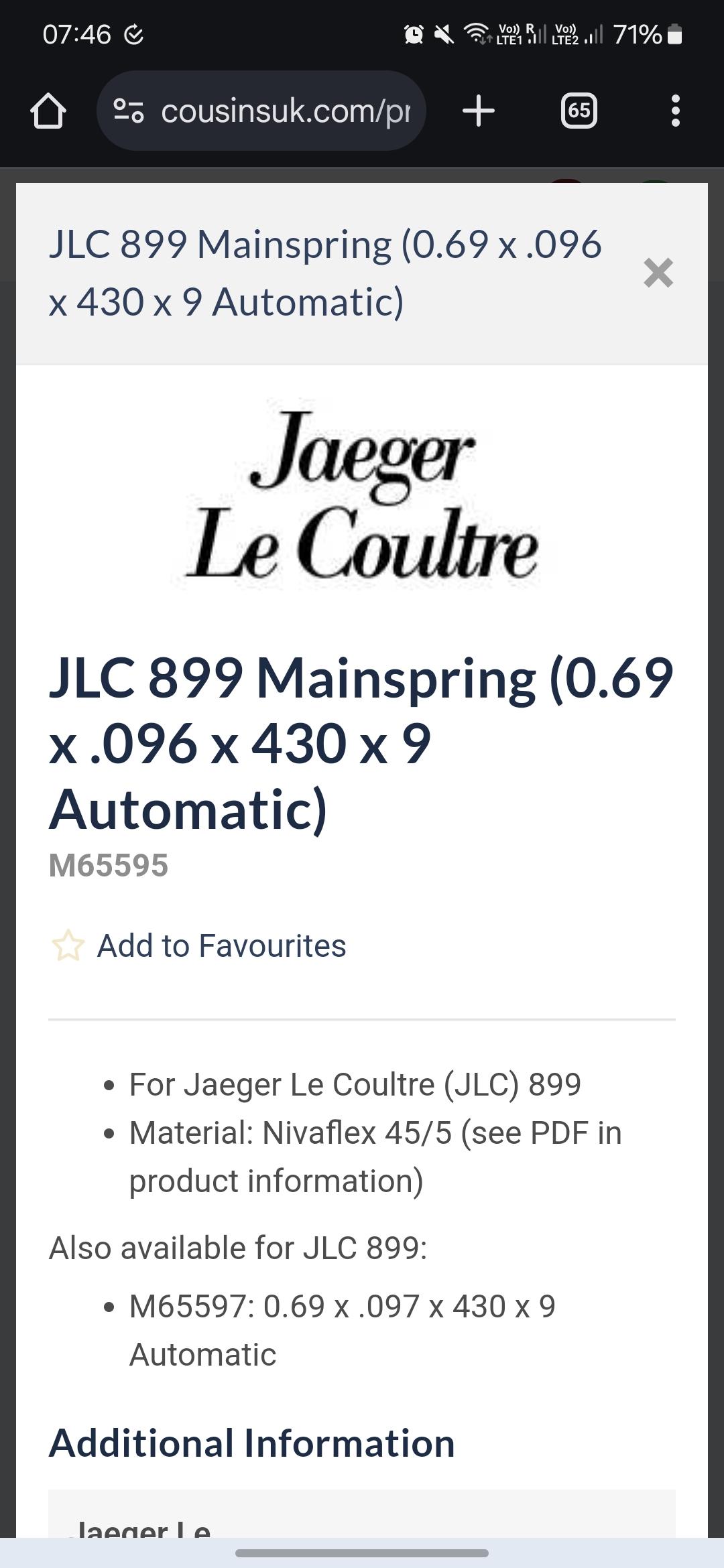

Thanks for the attention to detail. Unfortunately, I messed up the old mainspring in my attempt to wind it in my mainspring winder. I only have right-hand winders and the mainspring was left-handed. Furthermore, the inner coil for the arbor is very small in relation to the barrel size. Due to those two issues, I ended up distorting the old mainspring very badly. Can't reuse it.
It's bizarre, though, because the mainspring I got from Cousins was supposed to be an original JLC spring for the calibre.
This is an 899 not an 889?
Oops, wrong screenshot. I double checked. I got the correct one, for 889. (but they are pretty much the same anyway)
This is the correct screenshot:
I know the one that you removed and trashed Knebo may not have been the original, but how does the size compare to these two ?
Unfortunately, I can't compare it anymore since the new mainspring is in the barrel. But the difference can only be small. It's a remarkably small spring, barely taller than the metal retention ring (it was hardly protruding from the ring, which even made it difficult to align it on the barrel to press in).
