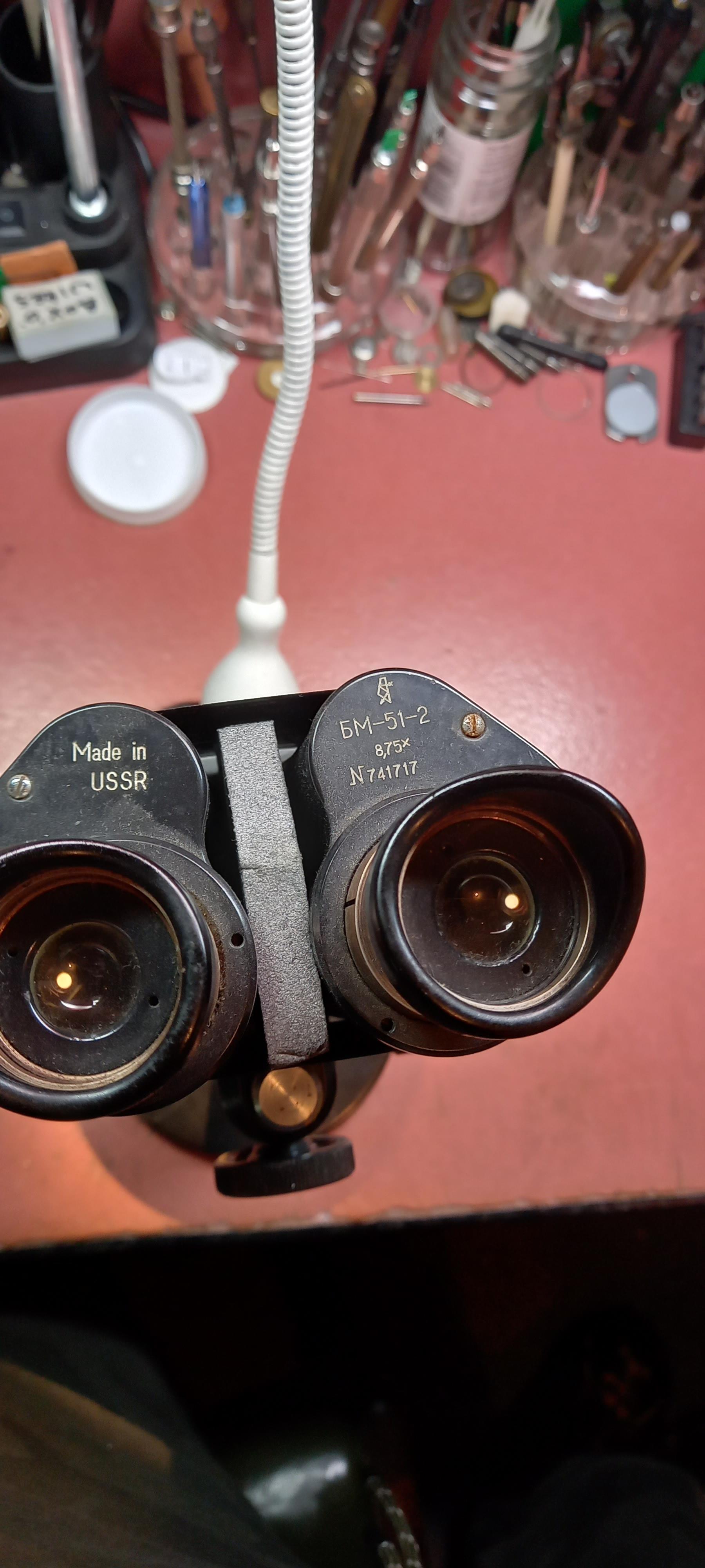

Is any binocular mic worthwhile or need to be choiceful?
I’m literally just getting in to the hobby and really struggling using loupes. They are uncomfortable to use and I just rely on eyesight for the most part. However some things are impossible to do without a loupe.
I’ve been toying with the idea of buying one of those cheap digital microscopes but also been on the look out for binocular microscopes.
Is any binocular microscope an option or should I be looking at specific ones only? For example, this one is near me but doesn’t have anything other than the 10x eye pieces.
Like Andy says, without the working distance underneath the head makes any microscope unusable for movement assembly.  There is 10 inch under both mine, I would think as a minimum you need 7 inch considering an average pair of tweezers is 5 inch in length and then there is a movement holder reducing the height on top of. You can just about get away with x10 magnification, but that wont give you a full view of an average movement,  I think about 18mm field is visible on my cheap Amscope type. Those don't seem to be available with x5 , i did buy some x5 separately but the field of view was the same as the x10. I also have some Russian biological biscopes, for the cost, I think they were 40 quid af the time originally for my wife as she had an interest in the hobby a couple of years ago. I'll see if I can dig them out, maybe some cheap on ebay as a starter set.
A common microscope setup is the Amscope, with 10X eyepieces and 0.5X Barlow lens.  Giving up to 22.5X magnification and 170mm working depth. You need at least about 150mm working depth.

The key words there are "up to". You usually work zoomed out such that you're working at around 3.5X or so. Sounds like NEW may even have a 0.35X Barlow for that sort of working distance. Also, he's probably pretty tall, or has some special seating/work surface situation going on.
That one pictured is a Russian model that seems to be fairly commonly available in the UK for inexpensive. Can't get them here, and shipping cost negates the price attractiveness.
What you want to find, first and foremost, is a reasonable amount of magnification with the most critical figure being how little you can get. Second, and almost as important (some people use scopes for inspecting only, and don't work with them), is working distance. That's mostly in the Barlow lens where less than 1X gives you more working distance at the cost of a reduction in magnification. Third most critical, unless you happen to find something that's just jam packed with all the accessories, is the ability to get parts like eyepieces and Barlow lenses.
Read through the Stereo Microscope thread. It's worth the education. Toward the end, there are a number of links and such to various scopes that are all pretty much the same thing white labeled under different brand names. Familiarize yourself with the form factor of that, and you'll start seeing them everywhere. Can't say you'll find a used one pop up for cheap in Australia, but it'll give you a clue for what to look out for.
