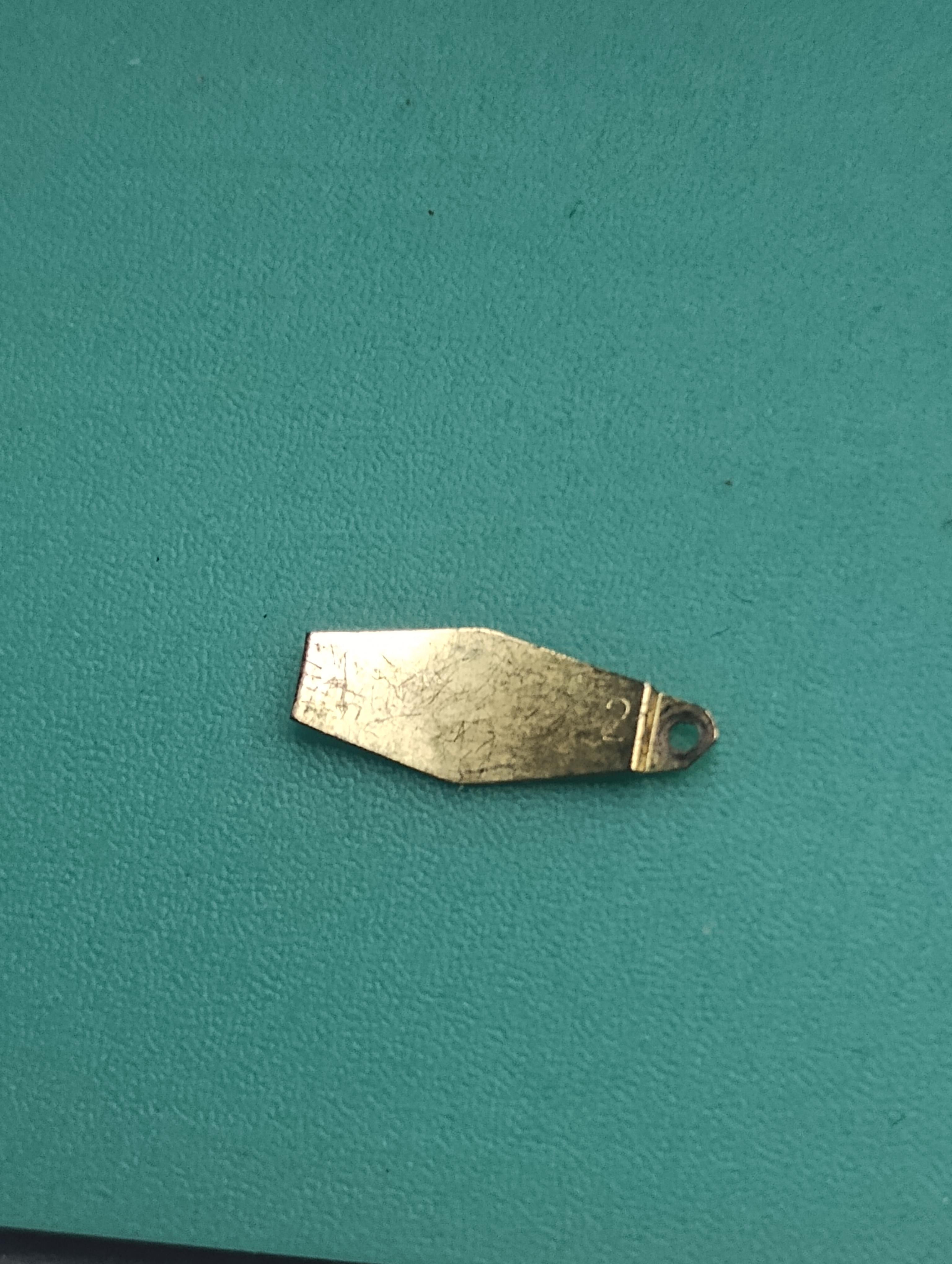

Cartier 81 how to check if it works?
Hi
The battery clamp was defect when i bought it. How can I test if the movement works before I buy a battery clamp?
Can I use a digital multimeter?
There is reaction when I put the red and black needles on the battery + sign and on the upper end the magnet thing

Just use a pair of metal tweezers to bridge between the battery and when the clamp connects.

Yes that's the idea but not sure if you'll need the correct size battery as I don't know if it is just the base that needs the +ve contact.
Have you got any other test equipment apart from a digital multimeter? Ideally it needs to be an analogue one.

I dont have the correct battery in stock, but know from previously it works with smaller battery. I unfortunately dont have analogue instrument. Hmm dont know what to do from here🙉
I think the Cartier 81 is a 2 hand movement and pulses only once every 20 seconds.
If you don't have any other test equipment, adjust both of hands together, then connect the battery and wait for at least 1 minute and see if the hands moved apart.

Still not working🤐

Maybe the circuit board is the problem?
Because I see some wear on that circle to the left from the number in the bottom.
Should I use the conductive pen here?
And I have also checked the upper to sides of the coil with the digital meter, I guess its ohm to be checked? But no response.

It does look like there's damage to the pad and track next to it but if the coil is open circuit then that's your first fault to resolve.
I bet you are right. On the right end of the coils, I see something irregular as if somebody smashed in a screwdriver. So I believe this is a very costly repair if I ever go on with it.

If the break is near the end then there is a chance to reattach the coil from that point. It will affect the resistance.  I have never repaired one this way but I did have a go at unravelling one end a few years ago. Delicate steady handing cannot be overstated.
