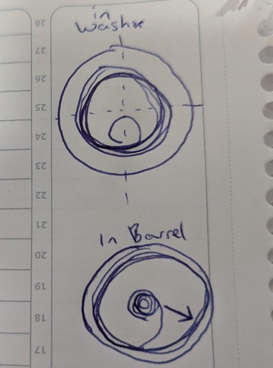

I installed it last night after a battle. I did unwind it from the washer to clean and relubricate it with 8200. It was not set at all - one coil inward and then reversing into a huge S curve. Pictured along with the old spring I removed.
And I regret unwinding it from the washer. I found it very difficult to install - as a T end, to get seated into the tiny hole in the barrel edge. The spring's strength meant it took several tries to transfer from my Marshall pocket watch winder, even if the hole was perfectly aligned. When snapping out of the winder, the T end would jump free of the hole in the barrel. And multiple wind attempts inevitably deformed the inner coil so it wouldn't hook onto the arbor. I had to manipulate it to get that back into shape but have lost confidence that it will be good enough long term.
@JohnR725 I know you have a lot of experience on American watches. Have you dealt with a spring like this? I didn't take a photo while it was still in the packaging washer, but the inner coil was never centered and does not reach close to the center of the barrel at all. It was coiled out at the edge with the rest of the spring, so when installed, the barrel arbor has to force the inner coil over to the center. This seems to me like it would cause a lot of wear on the barrel and lid. But this is a Hamilton original spring so I want to trust they knew what they were doing.
After the trouble to install it, I have only seen a modest amplitude gain from like 210° on that old spring up to about 225° horizontal. So I have more work to do because it I'd like to keep the verticals over 200.
Here's what I mean about the inner coil being far off center. When in the arbor is installed, the spring is putting a lot of outward force against the arbor holes in the direction of the arrow.  Maybe this was normal but I have not encountered it before. I think this is the first time I have installed an old stock pocket watch spring.
If you left the mainspring in the washer you definitely would've regretted that. Anything that has a protruding T type mainspring the best way to do it is with a mainspring winder. But as it's a common enough subject I have pictures
This is for an Elgin spring wind it in but leave a little bit out. How much you leave out depends upon the barrel of the spring too much is definitely a problem to try to get it all in see what a leave out as little as possible this is about right.
Next picture is a little hard to see but rotate until whatever sticks out is over the hole. Then you want to push it into the hole verify that it is indeed in the hole in other words Turn it over and look make sure it's there. Now you absolutely cannot press it out at this time because it will jump it will always jump unless either with your strongest biggest screwdriver or the back into your tweezers whichever works best do what I show in the picture. Hold the end in place and push out the spring. Only if you hold it in place is it going to stay otherwise it will never stay word supposed to be.

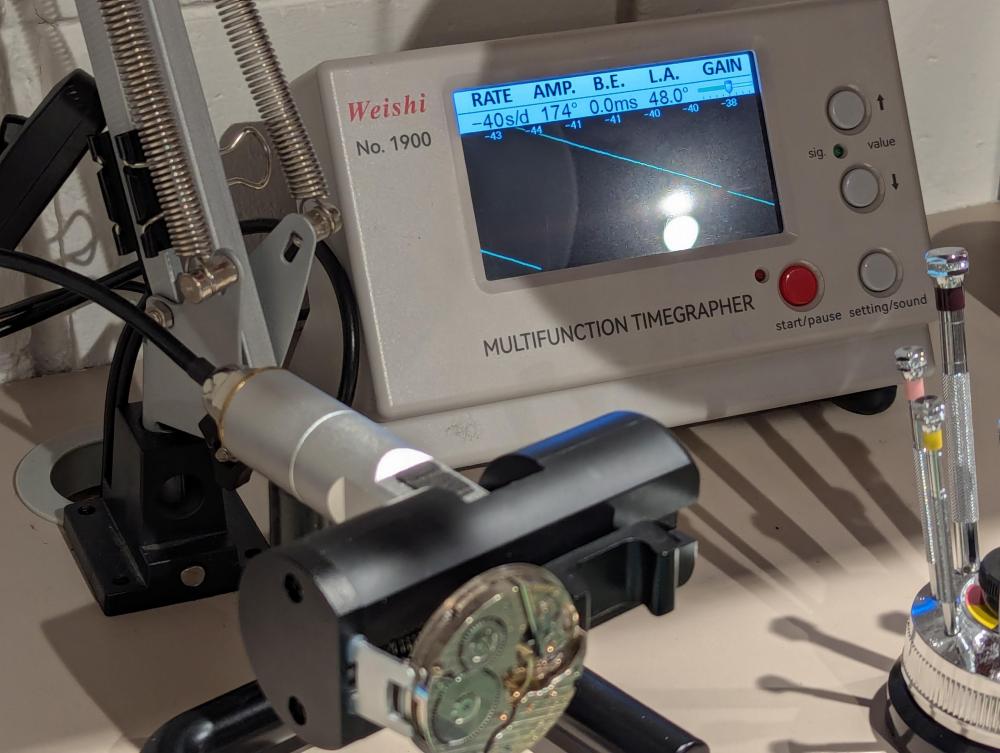

You didn't mention the beat and I was like to see pictures of the timing machine just because?? Things like amplitude should be a little bit higher but seeing as how the watch keeps time over 24 hours and it's a gift. Somebody will be extremely happy when they get the watch and it's really not gone matter that much Then usually if you are having pivot issues you would usually see a much more dramatic difference between dial up and dial down is usually one of them is really bad not just both of them bad they could both be bad but typically not.

and thanks for your reply! This is the info I needed. I tried installing the spring several times because I was having such difficulty. The best I did was to leave the T end out about 5mm of the winder, enough that I could see it and set it into the hole, but I did not try to hold it in place with a tool. Seems obvious now.
Hi Michael,  since John suggested it would have been a bad idea to fit the spring straight from the holder into the barrel....I am curious to know how you removed it from the holder to begin with ?
Hi Rich - Removed the spring from its washer? Same as I would from a mainspring barrel - lifted the inner coil free with tweezers while pinching the rest between thumb & finger, and gradually walked the spring out without drama.
48 minutes ago, mikepilk said:
If it is close to the hole, you can usually push the spring round far enough. I use some brass rod, filed flat on the end to push on the T end bit that sticks up.
This is what I ended up doing on a few of my install attempts. I think only once did I get it in the hole directly from the winder, but had to remove it again to reshape the inner coil. Except I used the butt of my brass tweezers.

Happy to show it off. It took me half a day to get it there but it is dead in beat. Pictured DD and PU at about 2/3 wind (its worst position right now)
PXL_20250112_134039836.thumb.jpg.168324e0c44e334a20d65e74cad71fe8.jpgPXL_20250112_134338734.thumb.jpg.ce6f90847f57d7f6d0c9d5c4eaec9242.jpg
