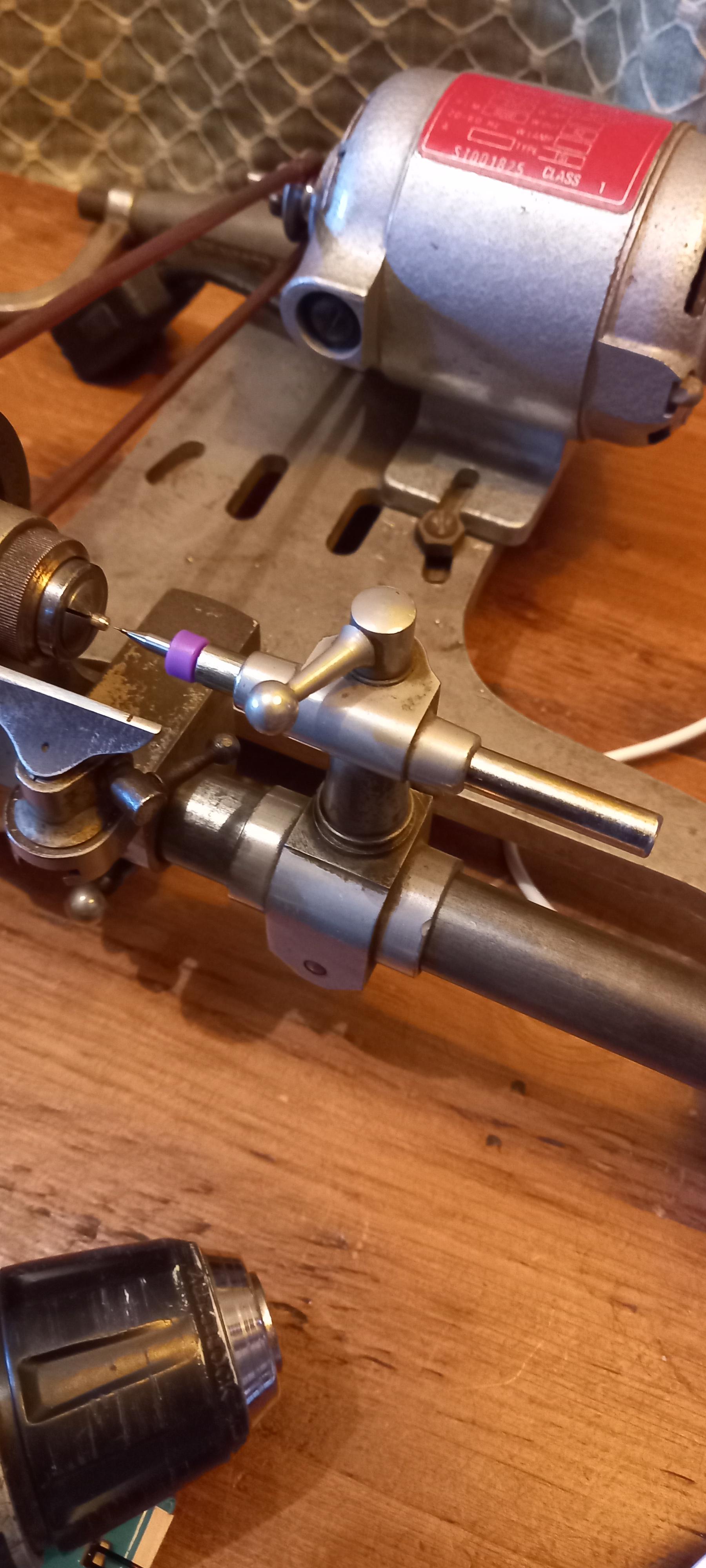

I just purchased a Peerless 2 lathe and it is missing the runner and lock for the tailstock. Can anyone provide me with the dimensions and specs for each of these so I can have them machined? I have had zero luck fishing “The Bay” for any used parts that would fit. I want to hold a drilling setup for pivot work.
In my experience, each tailstock runner is a different size. I needed a new one, and ended up buying some tool steel to make my own. You may need to go that route. The lock is pretty easy to make, just need to make the stock fit the hole, then file the notch in it so it can lock the runner

From what I've read, Peerless are a little odd with a tailstock runner of 0.300" or 7.62mm. McMaster has O1 steel in 0.302"; it would take some time but you could lap that for a nice fit. For the lock it would be worth asking over on the NAWCC Tool Forum, someone will have one they can measure.
This is the exact size of my Moseley, and the exact route I went, even down to the 01 steel I got from McMaster Carr. I ordered I think 6 feet of 01 tool steel in that "30 caliber" size. That way I can make many different runners, with dedicated attachments. You will need to lap off 2 thousandths off the diameter, which doesn't sound like much, but it takes a while to do it accurately. You'll need to turn it between centers. I have another lathe that I used for this purpose.

Is a drill chuck accurate enough for pivot work or is it best to create a special runner to hold the drill shank with a set screw or something. Any photos or descriptions of an 8mm lathe pivoting setup would be appreciated!
I would say that no, a drill chuck is not accurate enough for pivot work. The best practice is to make a drill socket, ideally for each drill bit. And if you are making your own runner, you then can set the taper to a known angle of your choosing, and match the sockets to it, as outlined below:

ER8 collet holder with 8mm shank directly held in the tailstock of my Wolf Jahn 8mm lathe:

Thats exactly what i did this morning 🤣,  a little alteration on what I already had. I dismantled a tv stand for one of my customers before xmas and I kept the rods that held it together . Checked last night and they were 7mm.  🤔 Ah-ha I have just the job for you guys. Some junior hacksaw cutting and one 1/8" hole later.....tadahhh...1 very accurate pivot drill runner 👍.
