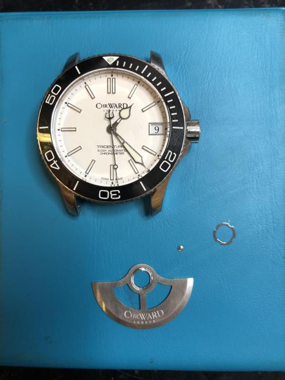

Excellent timekeeper, really like it, gets a hard life.
Been back to CW 3 times now, just aint doing it no more.
They had it longer than me in 2023
So...Today I took the back off, and hey presto.
The winding rotor bearing is shot.
Wobbles like a kids playground roundabout.
So how to i upgrade this.
Do not want to send back to CW.
It will likely fail again.
It is a 5 ball bearing affair. Pretty shocking anyway to be honest.
Any one any experience with these movements.
I know it is an "In House" movement.
But it is my hope that they didnt design every bearing from scratch.
Ideally a jewel bearing or even a bush.
The "5 ball" bearing that is installed originally is not up to the job.
Any experience greatly appreciated.

Just having another look at this and are you sure it's an SH21 as there's nothing showing for an Automatic version?
Edit
Just found that as you expected it's a later add-on and causing nothing but problems.
I'd just remove it and stick with the hand wind.

Only fair to upload some photos.
Only thing i am unsure of at present is the spacer/washer shown on the open case photo.
I did not remove this myself.
It must have fallen off the bottom of the rotor on removal.
Hands up. I did not notice this.
Until i was opening the case a few moments ago to take a photo...
That was lucky...

Update.
Success.
SW500 bearing fitted to original CW C60 SH21 Automatic rotor.
Using original bearing retaining/lock shim.
(Using bearing shim lock tool (From Cousins UK / Modified (Filed down)  to suit this bearing + Shim).
All went well.
Small spacer/washer mentioned in earlier photo goes on after the rotor, under the rotor retaining screw. It is recessed for screw head on one side only.
Rotor spins perfectly, without vertical deflection in any position.
And the 42 tooth gear which is the underside of the bearing meshes perfectly with the winding gear of the movement.
I think I just fixed my own watch myself for the first time.
Dont know why i didnt think of it earlier.
Can´t do everything right...
But better that a 10-12 Wk wait, each service return.
Twice in one year (2023), all under warranty, but still vexing.
Now as far a rotor bearings go, i am self sufficient.
And we now all know that a Sellita SW500 Rotor bearing (7-Ball) is a valid fitment, and as far as i am concerned, a valid upgrade, to the original (possibly older, and now no longer fitted by CW), 5-Ball item.
