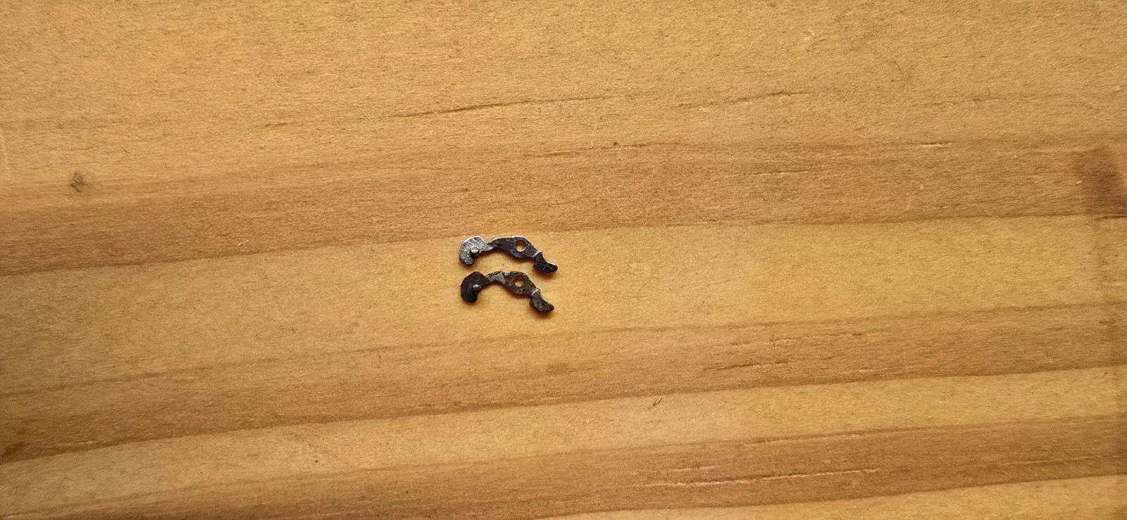

I have been trying to finish a service, but the keyless works is not activating the time setting feature. I have made a video to demonstrate the issue.

3 hours ago, nevenbekriev said:
Looks like this lever is bend up, so the small intermediate wheel that stays on the post is up.
Thank you and nice catch!
Can you point me out the best way to straighten this lever? I can give it my best shot and if it fails order another one, but we are talking 40 days to the little thing to arrive from outside my country.
Not sure how strong these are but you maybe able to flatten it by hand.
Where have you tried buying from and is this more to do with your postal service than the seller?
It looks like the recess it fits in, in the watch main plate, is level? (no depth changes).
If so, one possibility is a staking block, a metal block with holes in? You can make a temporary one by drilling a suitable hole in a really flat bit of reasonably thick steel.
Put the lever on the block with the pin in a hole just smaller than the width of the lever (so the pin itself has no force on it) and use a bit of brass and a small hammer to gently flatten the lever to the block?

Can you tell us how you fixed the problem you had? It's useful to everyone to see the ways that worked (especially without a staking set).
It was nothing special. As pointed by @nevenbekriev, the lever above was bent. Since I didn't have the tools to fix it, I found a donor movement on eBay and after it arrived, I unrusted the lever and installed it.
It was not the best option, but it was dirt cheap. After servicing, the whole watch cost me about 20 USD and I have loads of spare parts from the donor.
