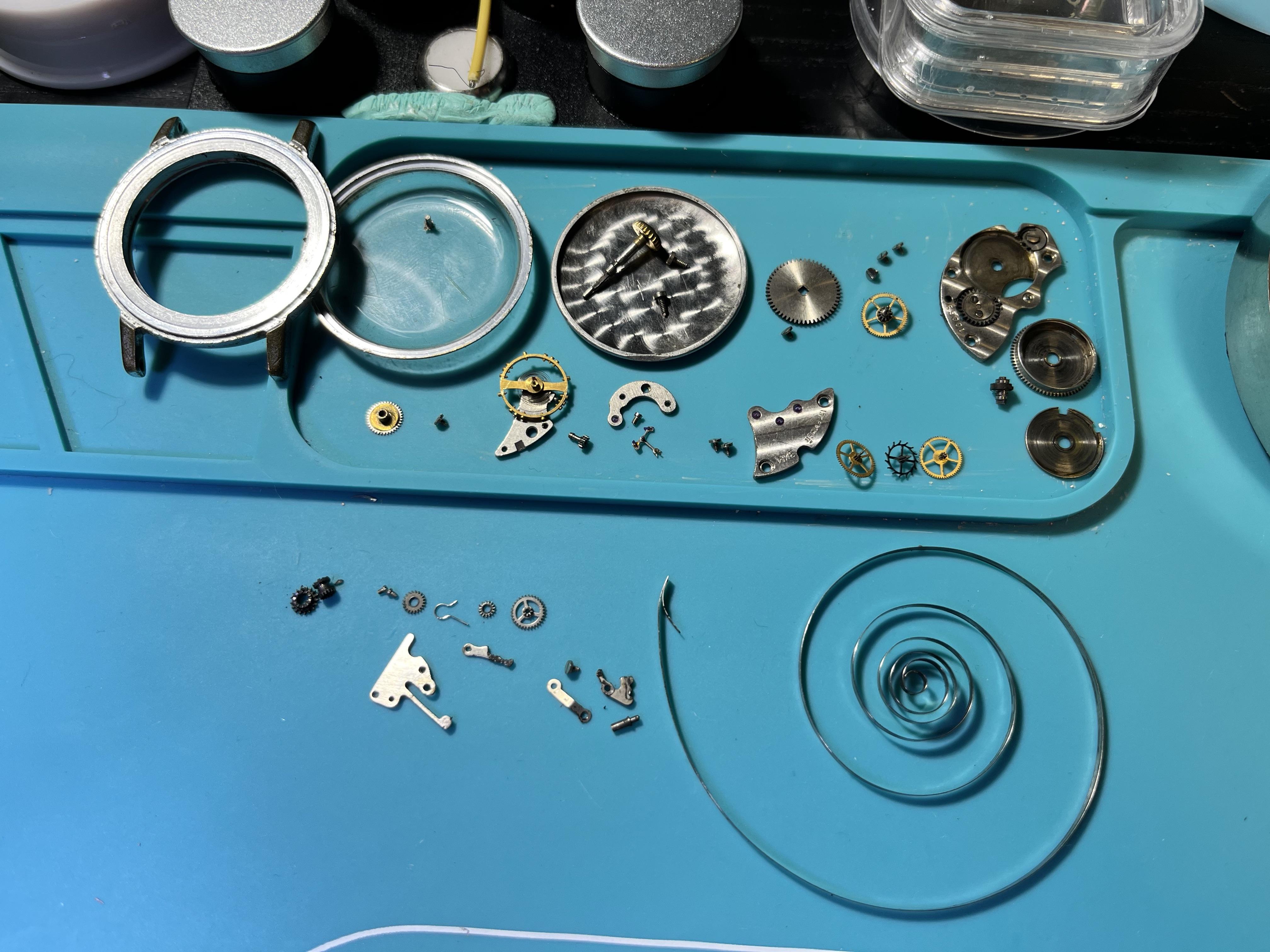

I've been working on a Russian Zim 2602 movement and got it from not running at all (caked in old grease and oil) to running pretty nicely. I thought I'd have issues with the mainspring being set (see pic) but I'm getting good amplitude, even after 24 hours.
Disassembled movement showing 'set' mainspring

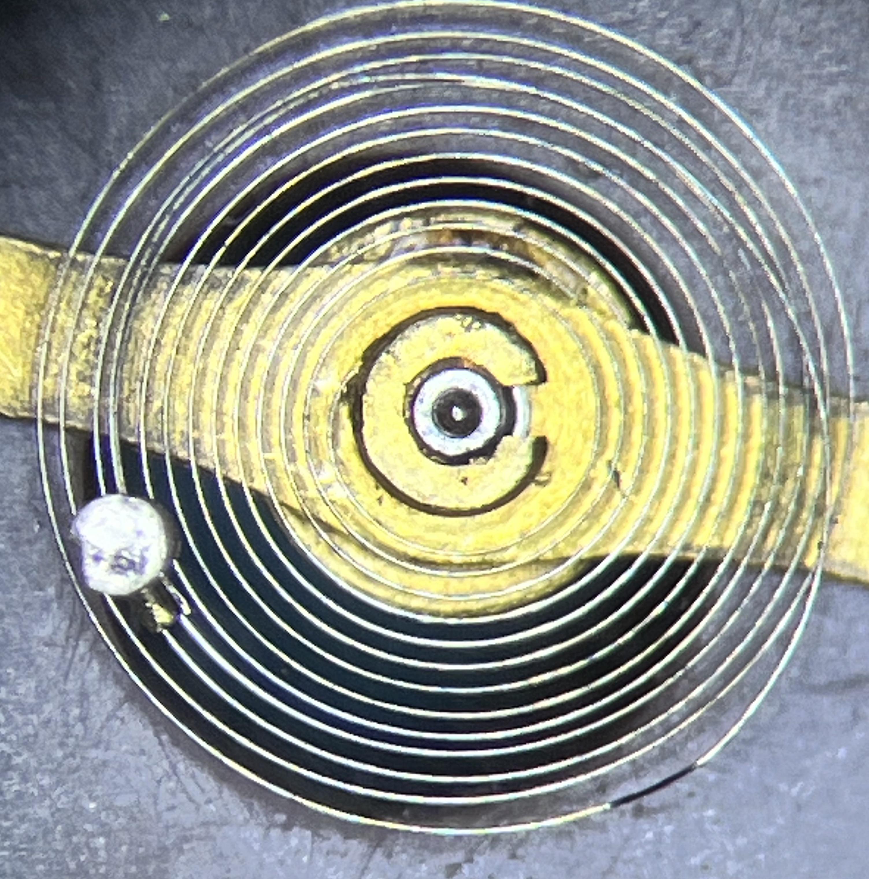

I'll post some images of the balance and spring shortly.
Here's the balance spring from above, in motion in the running watch (with not much wind in the mainspring, hence the low amplitude).
Here's a static image with no power in the train:

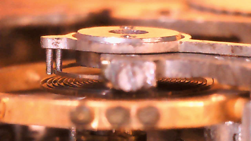

A view from the side:zim2602balspringside.png.a6f250ab02f796374315d465dce64bea.png
The imagery above is using my digital microscope. The ones below are iphone through the eyepiece of my stereo microscope.
With the balance removed, a top view:
Not perfectly concentric in places, but I wouldn't have thought that would be bad enough to explain what I'm seeing.

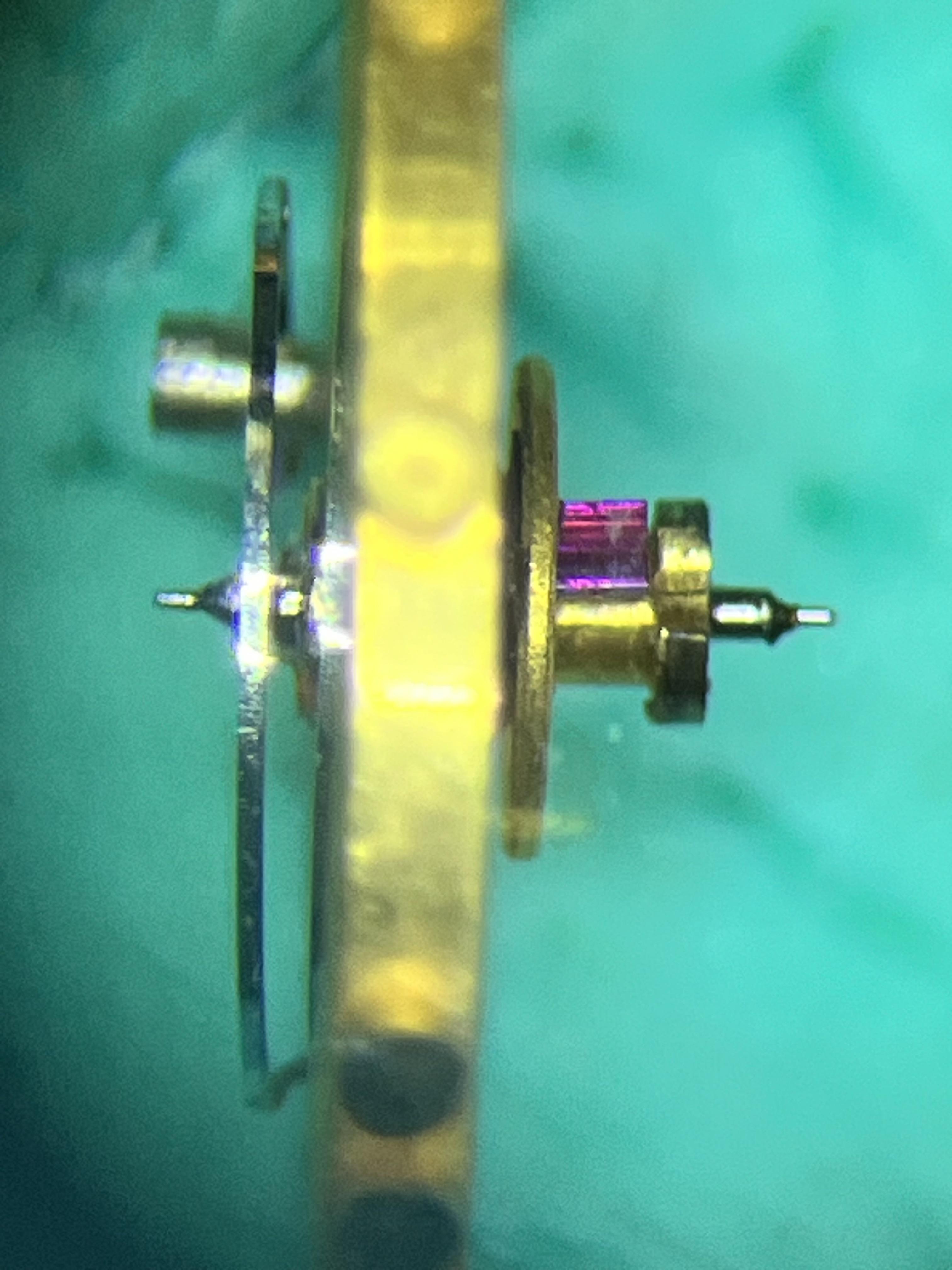

Pivots: pivots1.thumb.jpg.e205372312dcfe749316e9d336aee725.jpgpivots2.thumb.jpg.663ba99b842b0ce1acbe9043159f0512.jpg
(The black ends on timing screws are where most of them have had their tops filed off at some stage.)

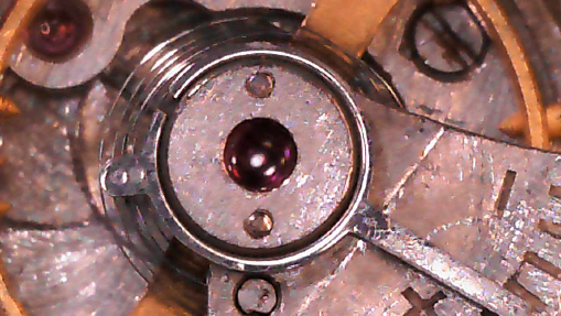

The pivots look ok to be, but ... am I imagining it? The impulse jewel doesn't look quite straight. It's not loose, though ... I touch it gently with tweezers and it doesn't move.
And I think that's a crack in the safety roller.
The focus isn't great (I need to learn to take better pics with the microscope) but that's definitely a crack.

@GPrideaux it might just be the photo (or me) is the upper balance pivot worn? It looks smaller in diameter to me and not polished and smooth. Most I have poked around the pivots have been the same diameter both ends and, at least to me, these look different.

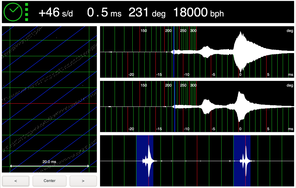

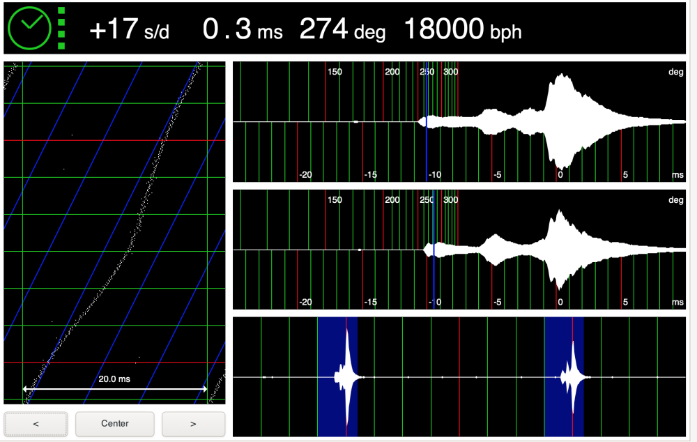

Some explanation of the images below:
  • Top line: stats. Should be self-explanatory. I have lift angle set to 42 degrees for these.
  • Left panel: graph of watch rate. Red horizontal lines are a minute apart; green horizontal lines are 10s apart. A healthy watch running at a constant rate produces a straight line here. A non-zero beat error produces a pair of parallel lines. The blue oblique lines have an angle that matches the rate shown in the top line (which is averaged over several seconds). These disappear if we're more than about 70 seconds fast or slow. The trace tracks down the screen in much the same way as if it was printing on paper tape so the most recent measurement is always at the top.
  • Right panel: traces of the sounds picked up from the microphone: tic, toc and both. The last sound, when the lever strikes the banking pin, is set to zero on the upper two graphs so that the amplitude can be read off the scale to the left from the start of the first sound (when the impulse jewel contacts the fork). The third graph shows the full period, tic and toc, with the regions shown in the graphs above shaded in blue. This is particularly useful when running with less than about 100 degrees amplitude when the software will treat the second sound (unlocking?) as the first and give inflated amplitude values that must be ignored.
As well as the numbers in the top line I'm mostly looking here at the graph on the left to see how steady the rate is. I showed the pendant down results above; here are the other five positions. These were recorded about 8 hours after a full wind.
DU - not straight but not awful: du15Jan.thumb.png.fcb33b8d98d4ef4f1807dd5ee3b3d53d.png
DD - a bit faster but still pretty straight: dd15Jan.thumb.png.b019b98c0589eac15eb2eda58064b2d9.png
Pendant Up - more than a minute slower than dial down, but still nice straight traces: image.thumb.png.0c3b9dd3538ecea6e5fe4a69d421bf29.png
6 Up (or whatever we call this) - this is troubling, not just because it's around two minutes a day slower than the horizontal positions, but it's also irregular, fluctuating between about -110 and -60: image.thumb.png.4eee9b8e713b6a1a6471524df3df673a.png
6 Down: image.thumb.png.0b13ffbc1a86570eb8f2547f9e9fe40e.png

Perhaps. It does appear smaller in the photo, but it's hard to be sure because the focus is poor and the lighting is different on the two sides. But if the pivot were really smaller than it should be I would expect that to be evident in excessive balance side shake. When I checked balance side and end shake, side shake was negligible (as in I couldn't see/feel any) and end shake was just enough that I wasn't concerned.
My 2ct:
pictures are too blurred to judge the condition of the pivots. But both don‘t look good at all (worn). The upper, right, looks tapered in 2nd pic (very bad). The lower pivot looks slightly bent, if true will put the balance out of poise.
With such issues I would change the staff.
The hairspring seems not belonging to this watch: its collet was forced open unduely. Consequently all weight screws had to be filed down excessively.
