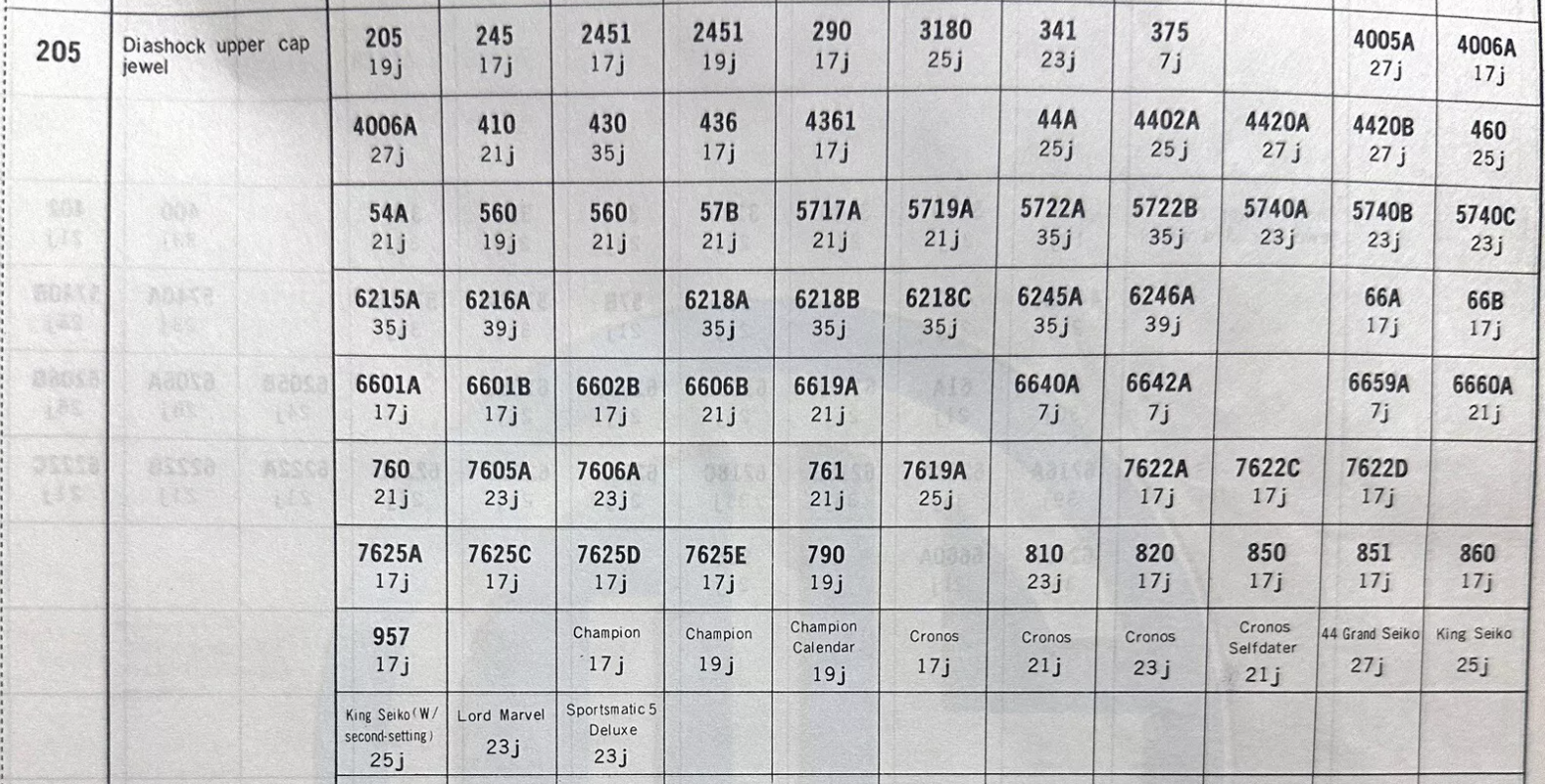

Just had a closer look and the jewel and frame don't look too bad but is the spring fitted the correct way round?
Edited by AndyGSi
Andy: Well, I had no idea it mattered which way the KIF spring was resting. That's something I'd probably learn in a class. I've watched hundreds of hours of YT videos, but nobody mentioned it. Thanks! It spins freely for a few turns, so that's an improvement. No movement in the jewel. I'll report back once I have the pallet fork.

Well if balance spins for a few turns, this is nothing. You should have 100 full oscillations (turn left  + turn right = one oscillation) if balance deflected to 180 degr. and released.
It is not so important which way the shock spring is put. This is when the cap stone is correct one. See, in the setting, there is dedicated place for the cap stone to fit. If the stone is small, then it will fall directly on the hole stone, which is not correct, as there should be distance between the stones. Further more, if the stone is too thin, the spring will not be able to press on the setting (the spring presses the stone) and it will be able to wobble (as in You case). So first source correct stone. But something makes me thing that something else is wrong here and needs investigation. Are You sure that the balance is correct for the movement? It looks very much like if it is not.
Can You explain what is wrong with the pallet fork? Nothing on You pictures helps to understand.
Neven: I was just checking cap stones online and I can see size but not height of the stone. For example: http://www.julesborel.com/products/Seitz-Endstone-Cap-Jewels
I measure 1.1 mm with a digital handheld caliper, for what it's worth. I can buy an assortment of 0.3 to 1.3 mm cap stones on eBay for a lot less than JB. I can use some advice here. I'm learning as I go.
I'm certain the issue is in the balance, probably the cap stone. As for the pallet fork, I can't get it to seat in the jewel and the tip looks broken. There's a tiny piece missing. I don't have a known good pallet fork though, so can't say for sure.

I am not sure the problem is the cap stone. Actually I am sure it is not. @caseback gave You advice to remove the balance cock jewel setting and spring completely, this is good to do and see if the balance will get free in DD position. I don't see on You videos the upside pivot under the cap stone. This can mean that the pivot can't get in the hole of the stone in the setting and if so, this will explain what happens. Are You sure that the jewel setting is original/correct for the movement? Do You have another movement? With complete balance cock? When You say You have another balance, is it oscillating normally in the other movement?
Thanks for your suggestions. I replaced the 310660 balance with the balance/cock for the donor exact match movement. Now it spins freely for about 25-30 seconds. That's a big improvement. Maybe 310660 is a generic number for a broad grouping of balances. This is way over my head. I still need to insert a pallet fork. The hairspring looks like it's bent in one spot. I need to have a closer look.
