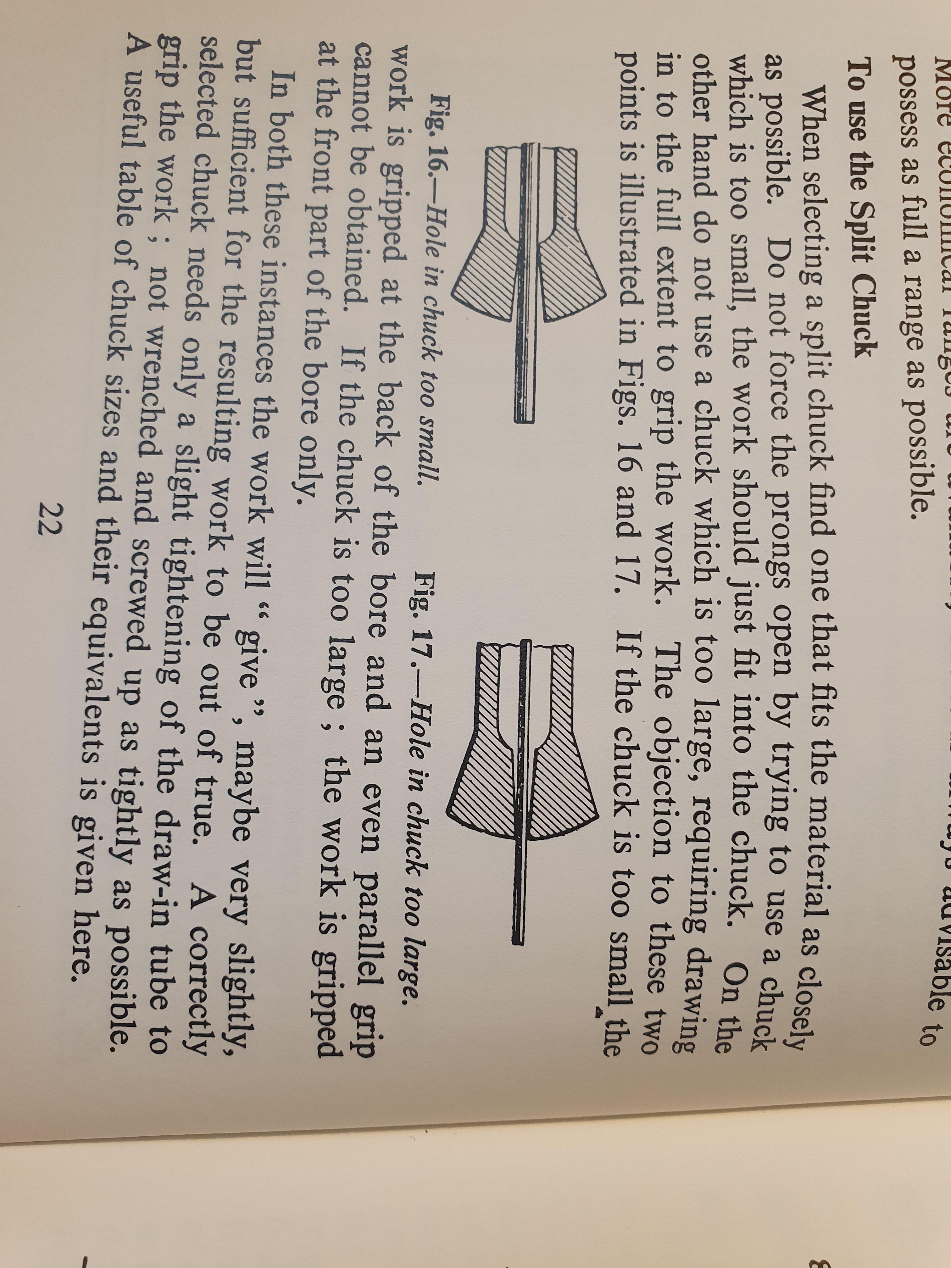

I need to read about the expand/contract capacity of my WW collets. Since my smallest is 0.50mm, i.e. what is the largest and smallest diameter it can grip, to inform my shopping list. I don't think I will be buying a full set of collets, but I do know that I will need to grip 0.2mm-0.3mm wheel arbors in the shorter term and otherwise I will probably just buy as I need.

The way these collets work there is not a range of material held, a 0.5mm chuck is for 0.5mm stock, not 0.4 nor 0.6. Using it for anything more than a couple of hundreds (0.048 - 0.52mm) will cause damage to the collet.
You want the collets to be as close to the diameter of the material as possible. Forcing them open will damage them. Screwing them tight as well. And they won't hold the piece properly if you do.

You're gonna get some wobble if the collet size does not match the workpiece.  Collets are 0 .1mm incremental you might get away with a couple of hundredths over size on workpieces ? maybe a tenth or two  under size depending on what size of collet you are using , my bigger ones start to increment to 0.2 mm when they reach 3mm .
Basic rule for the type of collet used in watchmaker lathes, i.e. that close at the end (and not all over like ER), is you can go undersize a little with the stock, but not oversize. If you put a piece that measures 1.90mm in a 2.00 collet, it will hold OK. The collet will actually collaps a bit further down the bore, not complete contact, but decent. If you put oversize stock in, it's being held at the rear of the collet bore, and to get the front to close much at all isn't going to happen- so the stock is wiggling all over the place.
One rare instance I might put oversize stock in a collet is holding a staff by the roller diameter. This is a taper, so I might put one that measures 0.45 in a 0.4 collet, as it kind of "matches up".
Great info @nickelsilver thank you.

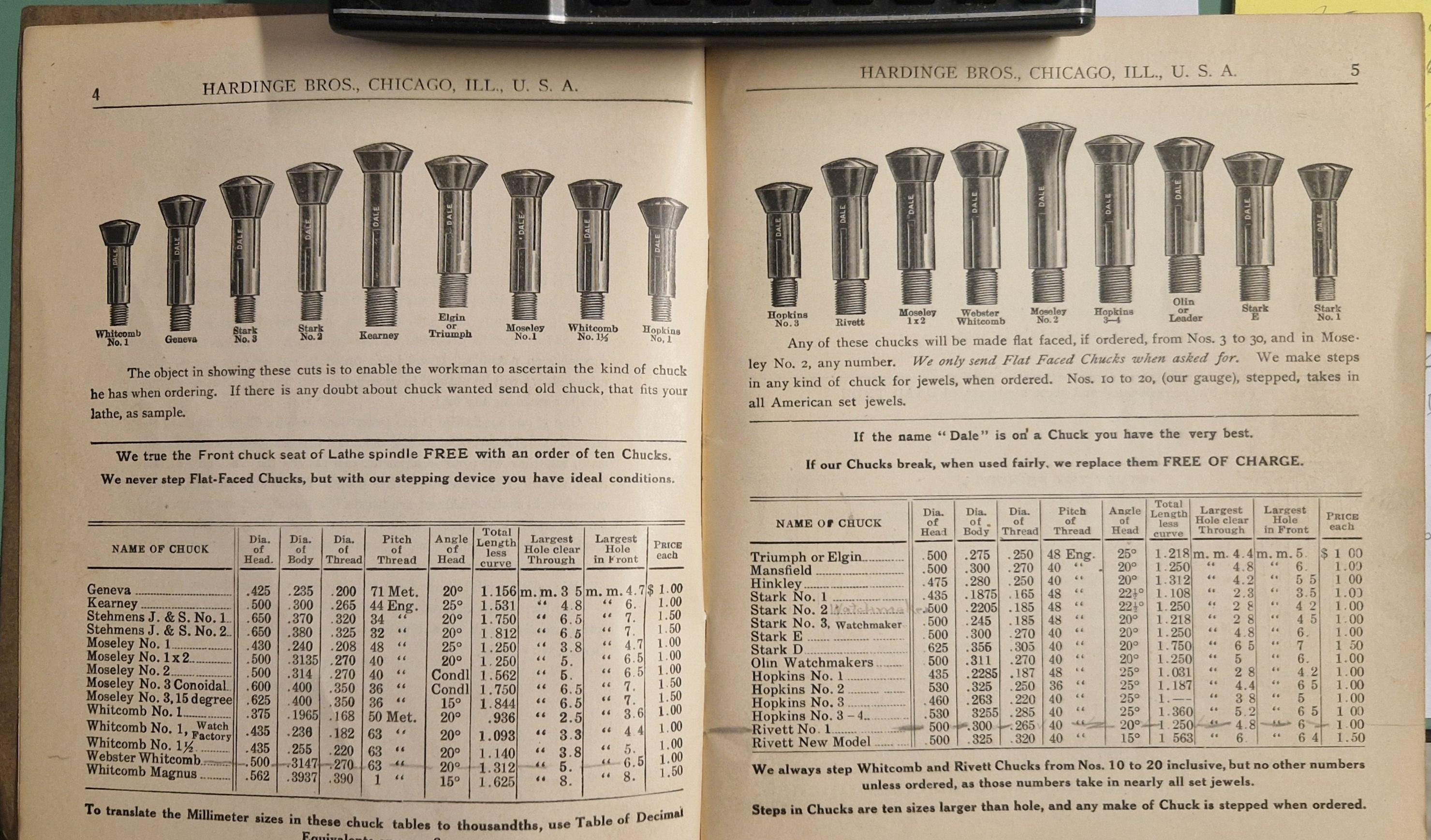

The American Watch Tool Co. made Webster Whitcomb lathes, which are really the origin of the "American style" 8mm lathe, with 50mm center height, and their corresponding collet is the prototype for most other 8mm collets. The WW collet has a body diameter of 0.3147", or just a hair over 7.99mm. This is to fit the bore of the headstock, which should be bang-on 8mm.
The thread pitch as listed by Hardinge (another high class maker of lathes as well as collets) is 0.63mm. It is sometimes listed as above as 0.625mm, or sometimes 40tpi (threads per inch) which is 0.635mm. Schaublin, the current maker of the best 8mm collets, have a pitch of 0.625mm. I have used G.Boley, Boley-Leinen, Levin, Schaublin, and some others in my old American Watch Tool lathe with no issues (it was last century but I do remember!). And also do so in my Leinen "WW82" lathe- guess where the "WW" comes from?
The AWT Co. morphed into Derbyshire early last century, who are apparently still in business. Your tip-over rest looks like a Derbyshire.
Mosely came up with another collet style, with a curved head they called "conoidal". These were also longer in length than regular WW 8mm collets. Later they made similar length collets with a more standard straight taper. I would avoid them overall; high quality but they are too far from standard to be practical.
In theory tailstocks for AWT Co. machines are interchangeable. As they are on (later model) Leinen machines. Levin, who made superb machines supposedly on the WW pattern, are a bit all over the map and don't really interchange in my experience.
Your bed length looks fine. 12" was pretty standard, and looks like what you have. My Leinen is also 12", and it's never been a problem in decades of use.
Here's an image from a 1913 Hardinge catalog showing the different collets they made then (it expanded later); you can see there are a number that are "around" 8mm, and many others larger and smaller. Best to get a seller to measure the body diameter as closely as possible when buying.
