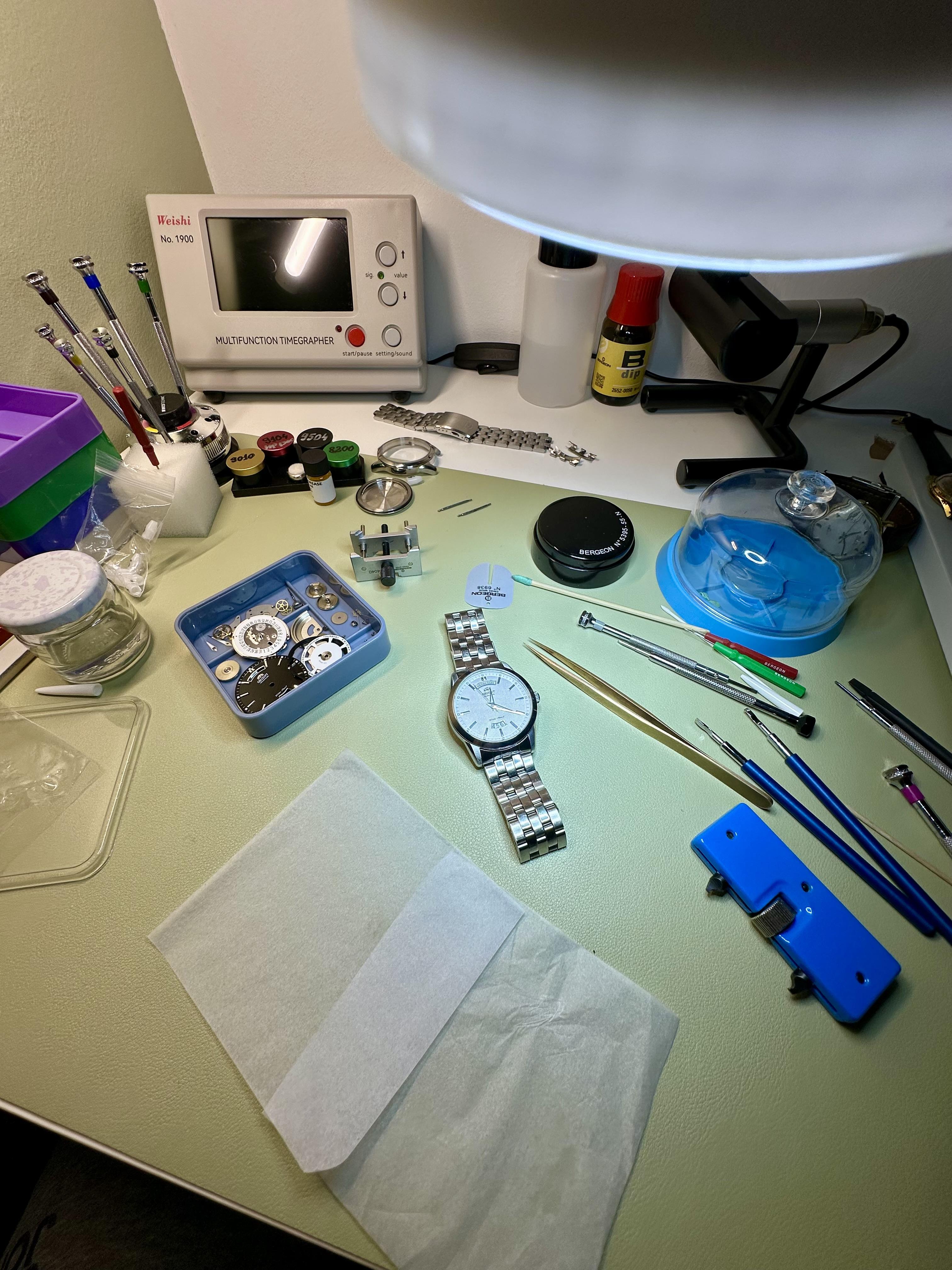

I am absolutely thrilled to announce that I finally fixed it !!!! Only took around 2 months and several parts ordered that either didn’t fit or had other faults, a lot of trial and error, somewhere around 150€ spent on parts. The good thing is that I have a bunch of spare parts for this watch now 😄
I regulated the watch with dial up and dial down for now since it’s very late, but I believe there should not be major differences in other positions.
Dial down:
Dial up:
The aftermath 😄
Edited by dancad
  • Like 5
