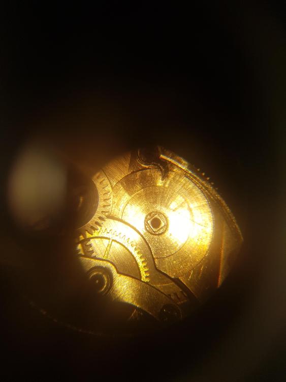

Ok, as per pictures I have a smiths rim set and wind on the bench, swimming in oil but all sorted. The fault I have is the mainspring bridle has lost its tab/notch/hook, like a hebdomas pocket watch the mainspring is fitted to a bridal in the barrel which slides around on full wind onto 4 notches in the barrel wall, thus stopping damage to the mainspring by over enthusiastic winding. So my questiion is this, what is the best way to create another hook in the bridal, my thoughts are along the same lines as making a new hole in the mainspring end, annealing etc, but what and how to make the hook?? I have a pair of barrel hook pliers that work great in soft brass but won’t even scratch the bridal, what I don’t want to do is whack a hole into it and not have a hook. the pictures are of the bridal ( broken) and a hebdomas ( complete ) incase you are wondering what I’m on about. And a few of the serivce. Thanks for any advise. -

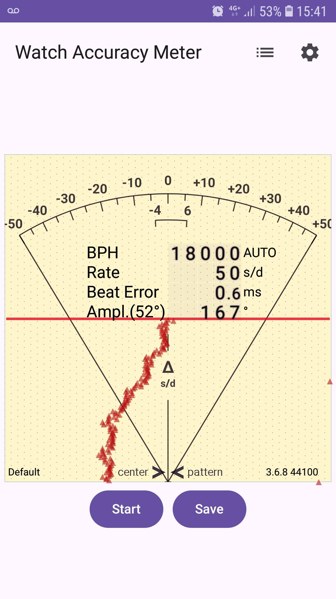

By nickelsilver · Posted
It's either bent or hung up on something or both. The hexane won't hurt it, and hanging from a balance tack indefinitely won't hurt it. If the spring is glued to the stud there's a chance that the glue was softened and the outer coil stuck to the stud. Haven't seen that happen, but I suppose it could. Don't know if hexane affects the glue used either. -
Hello all. some help required here from the community please. I serviced this movement, which was running reasonably well, but the balance spring which was running healthily before I started, after cleaning in hexane for 30 secs, is all bunched up at the stud. I did store the balalance on a tack thereafter for a day. could the spring be strained under gravity? I demagnetised of course, and the balance is squeaky clean. some help would be much appreciated. Thanks, Tony G
