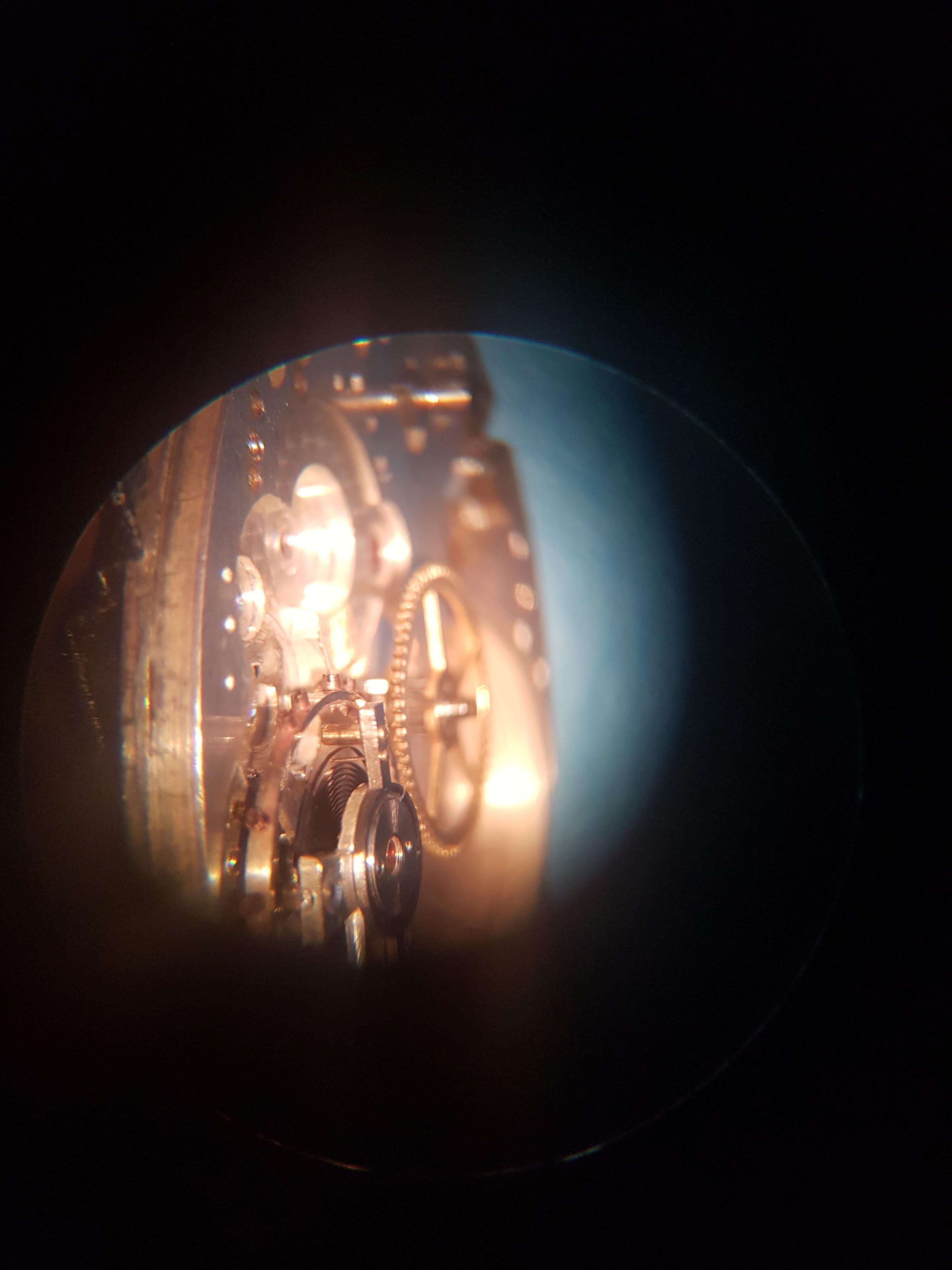

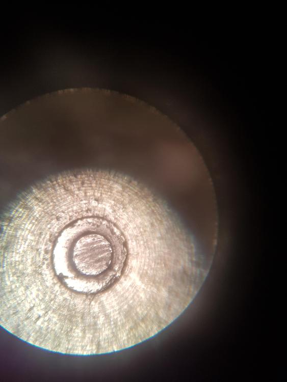

Struggling with 1917 watch
By watchweasol · Posted
Nice clock. Try annealing the broken bridle end making a hole in it then riveting it to the spring using some brass wire.as long as the outside surface is smooth it should slip easily, not forgetting the grease -
Hi. What’s the movement. ETA. 7750 etc as a service sheets would be handy to have for reference.
