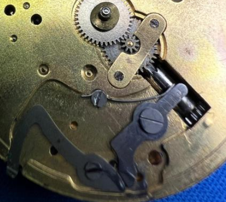

I hope someone can help me with some info on this movement.  As you can see in the pictures, it says "Illinois Watch Case Co." on both the dial and movement.  Knowing they didn't make or have their name on any movements (that I know of, anyway), I was intrigued and picked it up cheap.  I have not been able to find any info on the web at all.
It is a seven jewel lever set hunter movement, size 16s, serial number 3001624.  The 'engraving' appears to be stamped or cast, rather than cut, when viewed under high magnification.  There do not appear to be any other marks on it other than what is in the photos, but I have not torn into it yet to know if there is anything hidden.
I'm guessing it is a 'Swiss fake', but any information would be appreciated.  Anyone seen on of these before?
yes it kind of has that Swiss look to it. Plus of course Swiss early on really did like counterfeiting American watches so that's just kind of the vibe I'm getting from it.

Some aspects of this do look American - the movable banking pins for example I don't think you would find on a Swiss movement ever, especially not one of the "fakes". And the structure of the lever set keyless is really American looking. That makes me lean more toward a private label run for the case company than Swiss fake, but I don't recognize the bridge layout and that does look a little bit Swiss.
I am going to flip through the photos in American Watchmaking by Michael Harrold to see if I can spot a similar one.
Actually, I spotted an auction for a Waltham model 1888 with the same layout you have there. Scrolling through all the variations of the 1888's none has an exact bridge match but a lot are close, with a little more pointy bit between the ratchet wheel.
My bet is you have a Waltham private label, even if it isn't an 1888. Though it would be less surprising to see an Illinois private label for the Illinois Case Co. The only thing is, your serial number doesn't match for Waltham in PWDB.

The set lever does not really look like Waltham. Lots of small American companies were born and died quickly between 1870 and 1900. I'm wondering if any of them operated more as an "OEM." The actual Illinois watch company of Springfield was prolific in doing private label runs, but nothing about this watch resembles an Illinois at all.
4 minutes ago, tomh207 said:
Isn’t the safety pinion engraving indicative of an American manufacturer?
Yes but it is also exactly the kind of thing that would get stamped onto a Swiss Fake to mislead buyers. (I still don't think that's what this is)

so I need another photograph from @BirdNerd based on the images you already have it looks like you'll have to remove the two case screws and then remove the dust ring. I need a picture of side view showing the mainspring barrel. to understand what were looking at one unlikely to find a standard brass colored mainspring barrel versus the mainspring barrels that are supposed to be found in a watch of this grade which I pasted below. I find it extremely unlikely somebody cloning watches would clone the barrel itself. that has also trying to find a picture of the dial side of this watch like on eBay but conveniently everybody has their dials on.

Here it is:A3FFC9BC-52DA-407A-BB8D-631F009CE7F5.thumb.jpeg.79e53f431a3b140d5fe2b5fcf4b283a7.jpeg
Doesn't look like steel to me, unless they gilded it 🙂
Let me know if any other views or photos of particular parts would help
and yes that's definitely not a steel barrel. Even if it was plated which I've never seen they visually do not look the same there very different in the construction so it's very clearly not a Waltham watch.

I will take it apart tomorrow and see if I can find any hidden marks.  It has turned out to be much more interesting than I expected...

Well, It turns out the balance jewels are real, so it is a 7-jewel movement, though the settings are pushed in and not secured with screws anywhere.  The picture of the underside of the balance bridge doesn't show the jewel itself very well.  The only other marks on the plates are related to the serial number: repeated on the bottom of the train bridge, '624' on the balance bridge, and a '4' on the pallet bridge. The balance has 'Ball' written on one arm and '624' on the other - don't know if that is of any significance. The serial number shows 'out of range' when I checked the database under Ball (as rjenkinsgb no doubt saw). Hopefully these help narrow down the possibilities!
"Ball" ... for "Ballance" obviously 😜
Definitely nothing about this watch says "Ball" (who by the way didn't make their own movements as far as I know - they put their name on other companies' watches)
That pallet fork is very rustic and the holes in the plate look barely circular. The balance cock matches the serial on the plates though.
