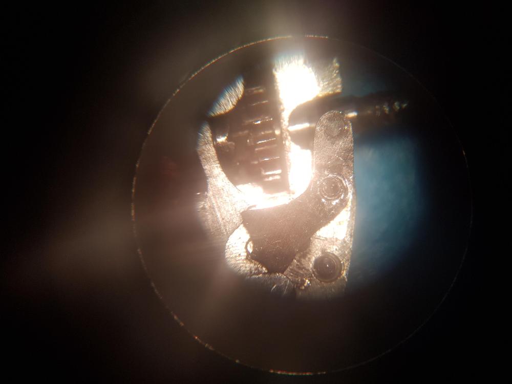

This is another 108 year old watch, a 13 ligne buren. No idea what movement it is.
It runs. The banking pins have been messed with and for some reason the bottom cap jewel for the balance seems to be glued in. But I'll worry about that later.
The main issue this watch has is the little piece, whatever it's called, that retains the crown. The thread has stripped out. Watch is filthy, and it seems someone has tried to glue the screw in.
Any thoughts on how to fix this?
If it was bigger, and that thread was m3 or larger, I'd have no trouble. Id drill it out, fit a bush and retap. But this is a watch, and that is tiny.

The part is called the setting lever. In the standard Swiss numbering scheme it's part 443. IF you can identify the movement you might be able to source a replacement part. (There is a forum here called "Identify this movement or watch".)

They are fine. I took the setting lever out to check and to get a good look at it's shape. I have been searching for setting levers to see if I can find one that matches, and work out what the movement is from that. But no joy yet.

I put the pieces back in loose
Overall
Each side of the setting lever
20250126_161109.thumb.jpg.b5a6700002b17ea886f515150715e710.jpg20250126_161109.thumb.jpg.b5a6700002b17ea886f515150715e710.jpg
The screw. The threads are full of glue, but I think they are ok
It's a simple part, if I can't find one, I'll make one. Just need to be able to tap the thread. I don't even know if watch screws of this age have set thread sizes or if they are all individual.

Measured the screw, 0.77mm. Presumably worn, so I guess it's 0.8mm.
This seems a thing. Taps are available. Cheap tap sets are available. I assume they will come in handy if I keep messing with antique watches.
Need to find out the drill size, but if £10 set if taps and an couple of hours with a bit of steel and a file will sort it, that night be my best option.
If i end up making one of these, what do I need to make it from. Would it have been hardened? It doesn't really feel hardened, I can scratch at the edge with a blade.
It's not a spring piece so doesn't need to be spring steel.
I can make it from mild, stainless, or tool steel. If I make it from tool steel, I can heat treat it if needed.

The hole is already too big for a 0.8mm screw. And the screw in question is the one that's sandwiched between the main plate and the barrel bridge, with the head flush with the top of the bridge. It's not a normal screw (it's a normal setting lever screw though).
So I have no choice really other than to use this screw. The hole in the setting lever is already big enough to just slide up and down the screw. I could try and close the hole up, but there isn't much metal there to squish back in.
It isn’t a proper repair, but one way of getting a watch screw to bite in a stripped hole is to insert a very fine piece of copper or brass wire, to fill the hole slightly and then the screw should bite. The technique has the advantage of being reversible, so you can perform a more robust repair in the future.
When there isn’t much metal to plug or bush a hole for a screw,  you can open out the hole from the inside with a tapered reamer, with the larger end on the inside.
That way, when the plug is drilled and tapped, the screw will pull the plug deeper against the taper.
If this is carefully done, nothing would show on the upper surface.
It is difficult to judge whether there is enough metal thickness for this technique to work in this instance, but it’s worth considering.

First, You don't need to close the hole with domed punch, as this is a hole in narrow strip. There is no enough 'meat' on both sides near the hole, so this thin places will elongate, and the thinner one will elongate more thus bending the part.
Buying tap and die and making the part is good point, but in this modern world the tools are made to sell them, but it is not sure that they will be able to do the job. My attempts to buy new dies once ended with conclusion that one has to make taps and dies by himself.
Now, the watcmaker's die not always look like the normal ones. Often dies are used that are just like a nut made of hard steel. They don't have holes around with cutting edges formed. Actually, making thread there is not by cutting, but rather by moving metal. The rod that You need to make thread on is to be soft as possible and with a little smaller diameter than the thread. So if You need 0.8 thread, then use 0.75 rod.
I will try to explain what to do and thus shorten the whole 'theory', then if needed, will explain more about what is needed.
You get new stem with long piece of thread 0.9. May be several stems, as some may break in experiments. No mater what, just the thread part is needed. Then You harden the thread part and temper it just to 170 degr (just to beginning of appearance of slight srtaw color) to reduce it being so brittle, but keep it as hard as possible. Then You form by grinding a tap out of it. Will show pictures at the end. Then You use the tap to carefully cut new thread in the setting lever hole. Apply oil. If it doesn't cut, then anneal the lever, if needed resharpen the tap. You must cut good well looking thread. When done, You harden the lever and temper it to blue.
Now You need to make a die. You need a flat piece (about 1mm) of soft tool steel. Drill a 0.8 hole, then cut thread in it with the tap. Then You make small champfer on one side like funnel, the other side grind flat, then repeat the thread with the tap to be sure it is clean. Harden the die the same manner as the tap.
Now, You have to make new setting lever screw. The material needed is tool steel rod, soft (annealed) state.
On the lathe, You begin with the threaded part. You turn cylindrical part with 0.85 diam, then form the thread by the die.  Start with the champfered side. Use oil, go ahead slowly by forward-back rotations of the spindle by hand. If it doesn't want to go easy, then the rod is thick. Then it will break in the die and You will have to make new one. If the rod is thinner than needed, the thread will not be full sized. When the thread is ready and looks fine, turn the other side of the die and finish the thread to the end (to the shoulder).
Then continue turning the screw, when ready, cut the slot with thin jeweler's saw. Harden the screw, then temper it to blue. Then You can polish the screw or at least the head that is seen on back side of the movement
