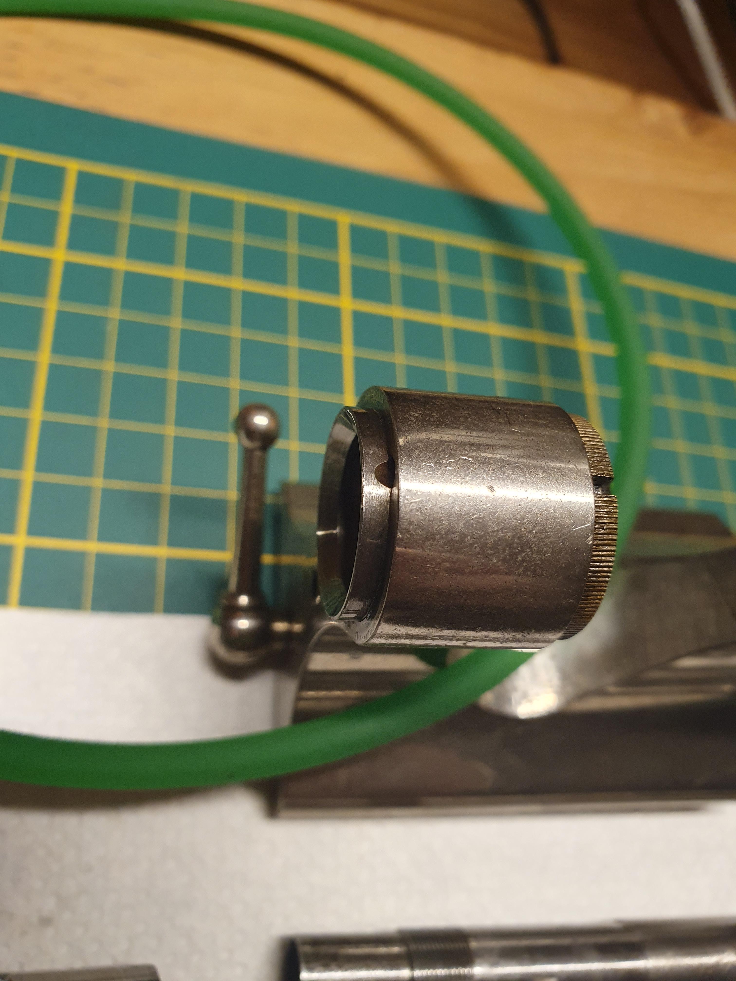

I'm getting my WW lathe setup, and have a couple of questions about the headstock (and one stupid snag).
Getting the snag out of the way first: I can't fully disassemble the headstock because the pulley grub screw socket is stripped out. Does anyone have a suggestion for attempting to extract this screw so deep in a recess? I was confused why none of my allen keys fit, until I can see it has no faces left inside. There's a crack in the bakelite pulley with some super glue, maybe related to this stripped screw. Is it possible this screw is only providing friction, and not set into any flat or recess on the spindle? And therefore I might just tap out the spindle against the pulley without worrying about it?
If I could get that out, I might be able to answer my other questions for myself. They are mostly about what parts should move and what should not move. I can get the spindle moving freely and smoothly, but it is somewhat touchy as to how much tension the cone bearings can be pressed in and that doesn't feel right.
The collet side I think everything is assembled correctly. The oil reservoir hole is positioned at the top. No problems here I don't think:
On the back end, I am a little more confused because parts I expected would be stationary are movable. In this photo, the oil hole is positioned at the top and aligned with another recess for the oil hole in the frame:
I assumed that oil hole would not turn. But I find that it does. Here it is rotated clockwise to the 1 o'clock position. Should this turn? If I thread on the locking nut tightly, this compresses the cone bearings in together and causes friction that prevents everything from spinning as smoothly. I need to lightly tap it to introduce about 0.25mm of play and then it spins freely again.
But the thing that is most surprising and makes me feel like this whole thing is assembled incorrectly is that this brass dust cover, when affixed to the bearing and covering the oil hole, spins along with spindle. I assumed this would need to be a stationary part. Again, if it is pushed all the way on it causes friction that impedes rotation. But if I leave a small gap then no problem. These brass dust rings do not have a split or threads - they just push on with light friction. Pictured, it is pulled away from the frame by about 1mm. If it touches the frame then motion is impeded. That can't be right, can it?
If I could get the pulley screw out, I would be able to disassemble the whole thing and it might make more sense to me. It does move, just  not if everything is pushed together as close as it seems like it should be. I would appreciate any insight the experienced lathe folks can provide here. I probably have this all prepared correctly, but it just doesn't feel like I expect and I don't want to damage it.

The oil hole on the back should be stationary. This is alarming.. If the construction of yours is indeed simular to mine (which I think it does), that part is the "outside cone" of the rear bearing and it should not rotate. A rotating oil hole would also be lubricating the area around the lathe including you: not a very sensible construction.
Edited by caseback
Yes, the rear bearing in the headstock should not move. And the oil covers should friction onto the bearings pressed into the headstock, and not move with the spindle either. They are usually split, but it could be you some that are just a friction fit- but, they shouldn't contact the spindle.
As you can see in Caseback's photos, the spindle has a divot for the pulley screw; so no tapping out the spindle if that screw is in place. You could try an extractor for broken screws, it will hopefully grab on the (now smooth) hex opening.
The rear spindle bearing is usually a light press fit on the spindle and is keyed. You will almost always need to knock the spindle out with a brass drift- just be careful not to damage the key, which is usually integral with the bearing. Also be careful to line the key up with the keyway when reassembling.
The loose rear headstock bearing needs to be addressed. Once it's all apart and clean get it in place and tap it home with a soft faced hammer, if it seems secure it should be alright, but in the event it still wants to move, you can use a little bit of Loctite sleeve retainer like 638 to hold it. Just the smallest amount evenly distributed, a band maybe 2-3mm wide. If there's too much it will almost certainly not fit all the way in the opening correctly.

@nickelsilver If I am understanding you, the part with the red arrow should be firmly attached to the frame but it moves very smoothly. What I am finding confusing here is that if the part with half of the oil hole marked red is not supposed to rotate, then it would mean that these must be two separate parts so that the piece keyed into the spindle's groove  can move independently. But these do not look like two pieces to me, it looks like one piece at the green line unless they are so perfectly seized together. And the motion is so smooth it doesn't feel "wrong", unless the brass caps are pushed all the way against the frame, adding a little more friction. Now if the green line should really be where the rotation occurs then these must be 2 parts seized together.
Since there is an oil hole in the shoulder of the frame (light blue) that can align with the little scoop in the part that does rotate, the oil does have somewhere to go without spilling out. That scoop just funnels the oil in (to @caseback point about flinging oil out in rotation).
If I give the spindle a little tap, I can shift that piece (which I think is one piece) about 0.5mm and I believe if the pulley could be removed I would be able to tap it all the way out. So my primary task needs to be getting that grub screw out.

Progress! I removed the grub screw by pushing into it with an allen key while turning. It's now stuck on the allen key but I'm not worried about that.
Yes, the cone is seized into the bearing, which was not firmly attached to the frame. I suspect this is actually how the previous owner was using it, because it actually does spin pretty nicely in this wrong state. Next issue will be to figure out how to separate these without damaging the surface of the bearing where it should mate with the frame.
I put a lot of penetrating oil on the outer joint where they meet and on the inner joint and will leave it overnight. Maybe if I can clamp the bearing part in a vise surrounded by grippy rubber I might be able to twist it off. Or a dowel of exactly the right diameter to rest on the edge of the cone inside and tap them apart. Maybe I try to drive a razor blade into that seam with a brass hammer. I'll give the oil some time to work.

Thank you. I can't test it right now. But also failing any of these, I am thinking the same thing I would use to remove a seized on caseback - a bead of superglue on the outer rim to attach a socket to one end and maybe glue the other end to a flat metal surface so I can twist them apart.
UPDATE: Yes I could spare the 30 seconds to test a brass hammer before I go to work. It worked! They jarred apart and separated, the surfaces look pretty good, no damage and a tiny bit of surface on the outer flare. And lot of oil.
