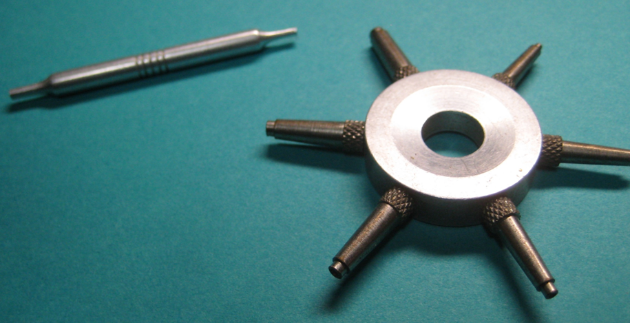

Then this is what the tools for pushing the jewels look like. But you could use anything that's round just a push on the edge of the settings preferably not your tweezers as you leave marks on the brass depending upon how hard you have to push. In other words the friction then there supposed to push out by hand you don't need any tools other than something to push on them
