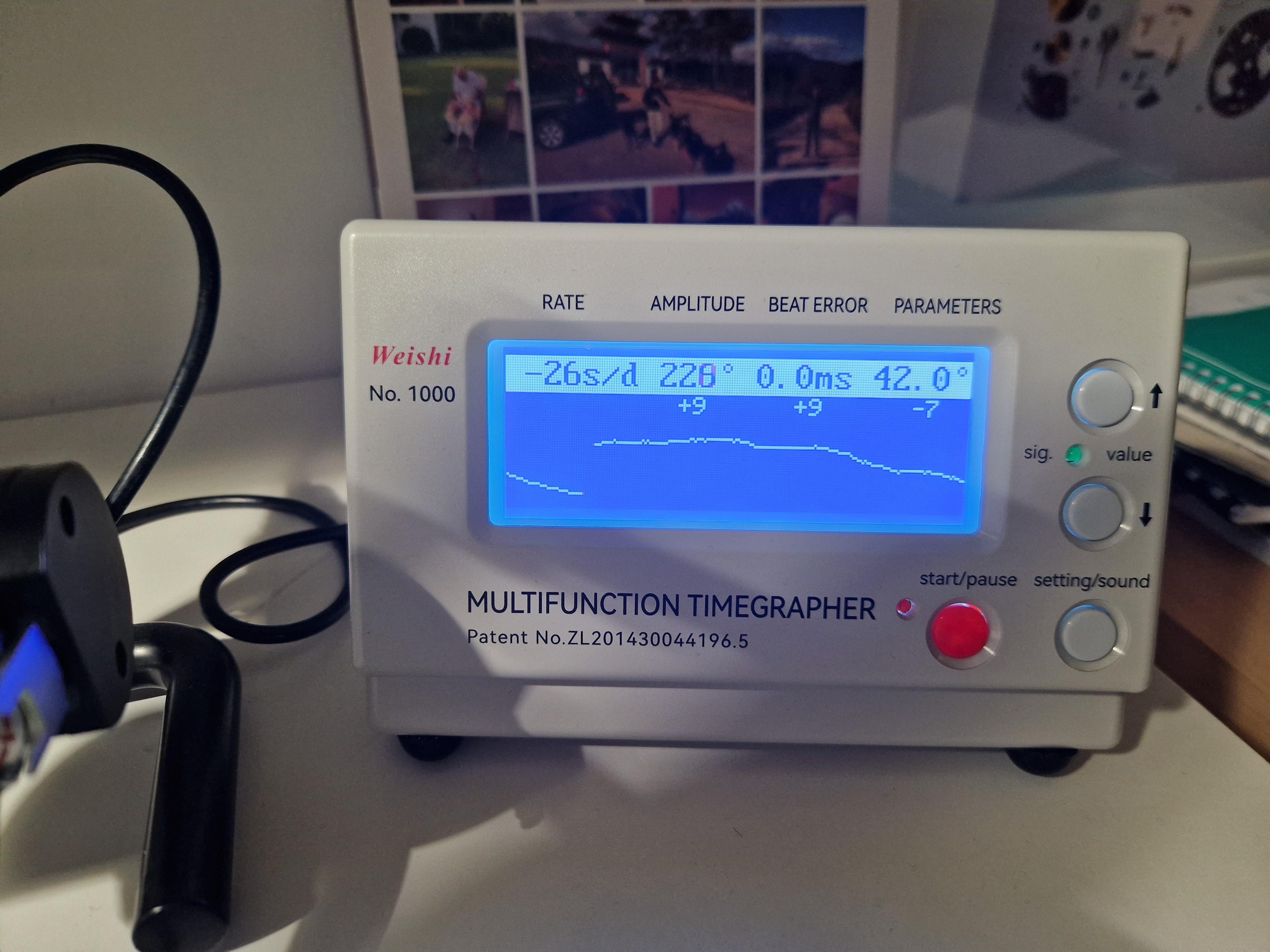

weird stop-and-go timegrapher readings after balance staff change and pallet stone refitting -- Vostok 2414

I can now confirm that it was the balance wheel / hairspring mix-and-match. I know, most of you were sure already, but I was still a bit incredulous about the MASSIVE deviation (close to one HOUR per day). But yes, that was it. I put in a balance from another 2414 and it worked very well.

Next challenge was unexpected. Every once in a while, I was getting traces like this (especially in vertical positions):
So back to fault finding..
Identified two things:
i. centre wheel has quite a wobble, out of flat
ii. a LOT of endshake on most train wheels, particularly the 4th wheel. On the latter, it actually resulted in the oil creeping from the jewel diwn the pivot to the pinion spokes. The pivot shoulder was so far from the jewel that there was no capillary action left to hold the oil (notably not even HP1300)
So next corrections:
4. Managed to bend the centre wheel into a good flat shape (in situ)
5. Adjusted the train jewels with my Seitz press. Very little endshake now.
In sum, pretty much every aspect of the train and escapement needed fixing. And I did it 😇
Now, I'm delighted with the results:
Vertical direct comparison/improvement to the above:
And dial up:
This shitty, excuse me, Vostok has taught me a lot!!!

You certainly have a right to be! Congrats!
16 hours ago, Knebo said:
3. Bending the old/correct hairspring into good shape in both dimensions (concentricity and flatness) -> success
I've been trying this many times but never really succeeded. For some reason, Archimedean spirals confuse my brain. I know they have an absolute centre, but I can't find it for some reason. The only time I truly succeeded in manipulating a hairspring was by @nickelsilver helping me out by drawing arrows in an image of where to push. I feel very envious that you are ahead of me! 😉
It seems you got it just right! In my experience, however, there's such a thing as too little end-shake especially when working on these Russian movements where the tolerances are pretty crude. It's a bit like shoes, just right is the best but if that's not possible it's better with a little too large than too small. Anyway, it sure looks like you nailed it!
And should very much be so. I've probably had nearly a hundred Vostok movements on my TM, even brand-new movements, and have very rarely seen results like that. A bit of roller coaster is simply the norm for these movements. So again, congrats! 👍
Yes, they are great to learn with, but let's not forget these movements were never meant to be marvels of Swiss precision, but inexpensive and practical enough to be afforded by the masses. For this reason, and IMO it would be unfair to call them anything derogatory. A few decades ago these movements were manufactured by the many millions every year. It's a general misconception that the Russians are unable to produce quality in anything. The quality level is a very deliberate choice, and there are plenty of examples where Russian technology far exceeds Western technology.
