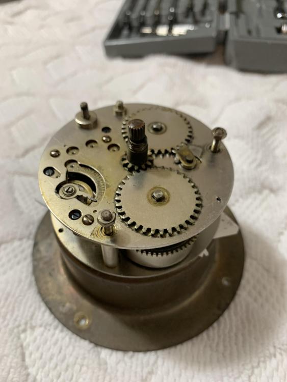

Help with Seth Thomas mantel clock

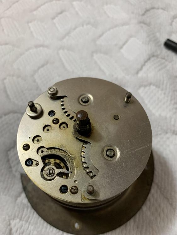

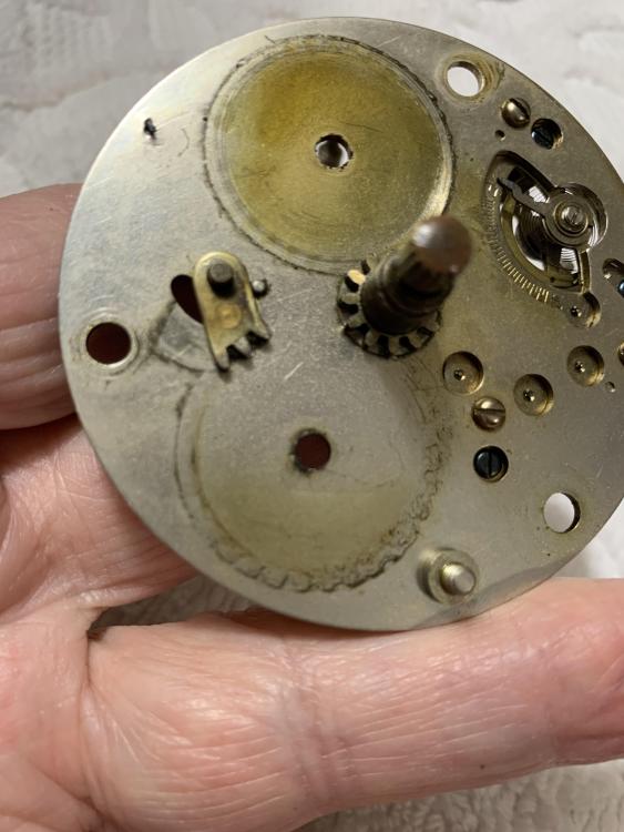

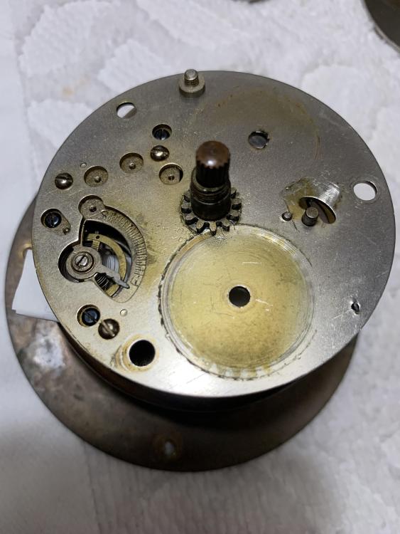

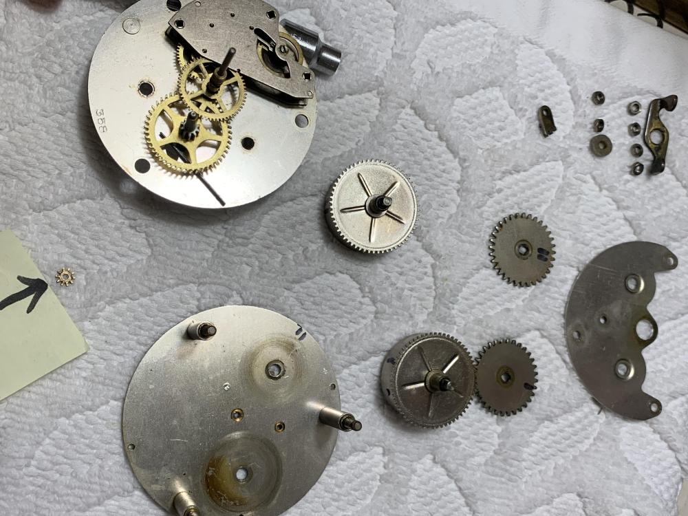

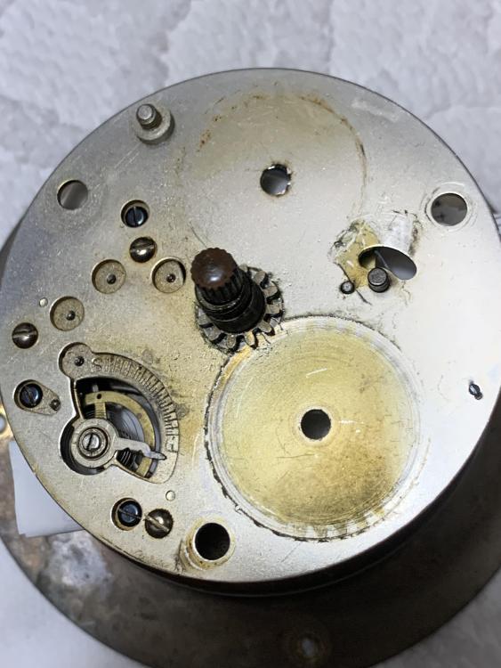

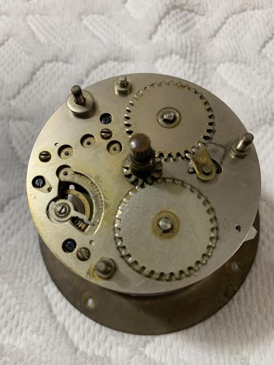

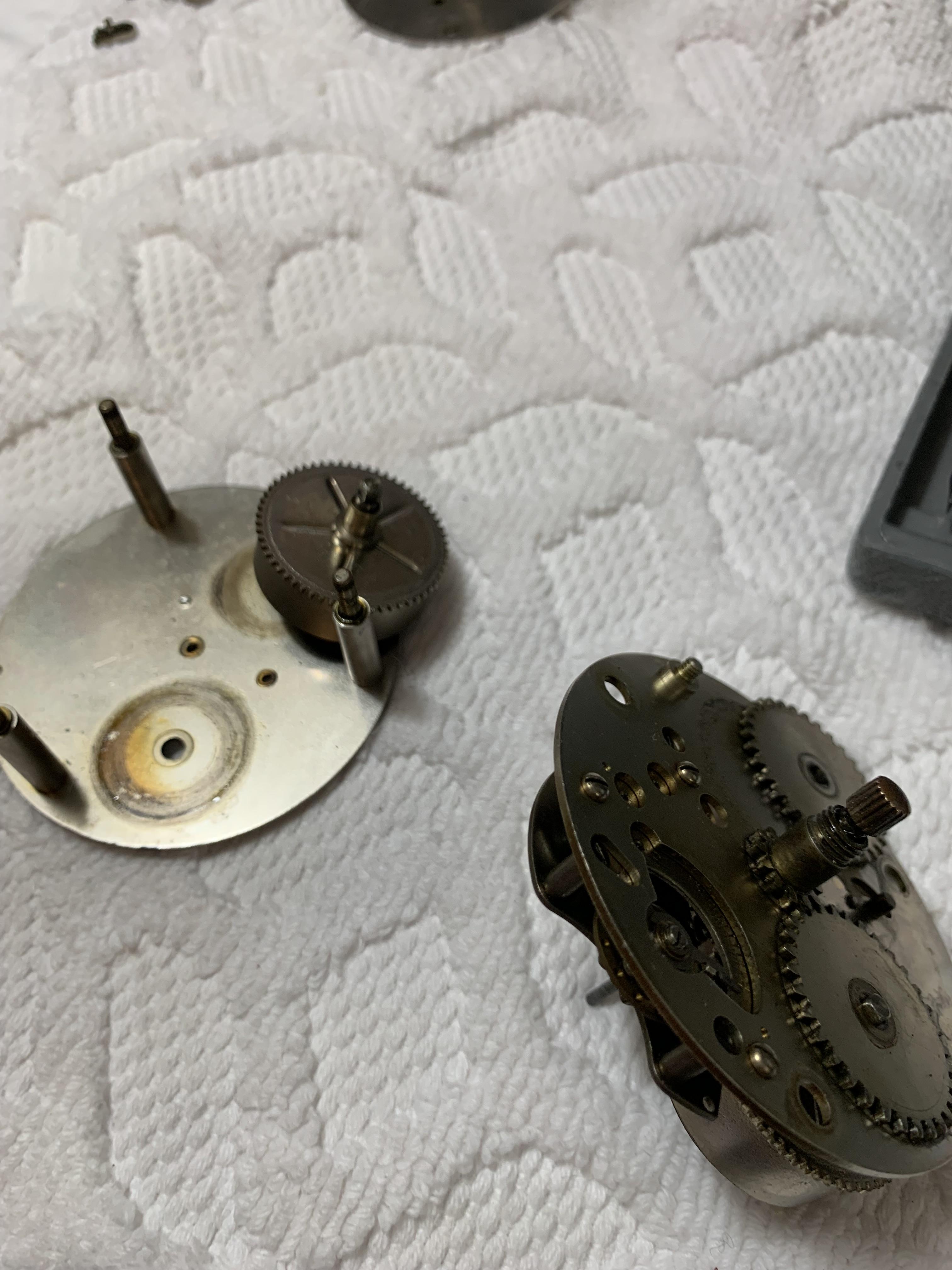

It appears to be a Seth Thomas 358 from an inside stamping.  After watching every Youtube video that I could find yesterday, this morning I took it apart.  Was not sure how to relieve the mainspring so I removed the half moon plate, then removed the nuts to the three studs and the mainspring relieved itself (to my surprise); I do not believe it was wound up much.  Still do not know how to relieve but see a black metal sliver (bottom of pic 5) and wonder if this is it?
The small gear in pic 8  (see arrow)- cannot remember where it goes.  Cannot find any residual marks to show where it might go.
The main arbor does not seem to come out unless the twist cap can be unscrewed.  Tried gently to no avail.  Main arbor has slightly less than 1/8 inch of play.  (lately unable to get minute hand to move at all)
Because the time gears seemed to work properly, I did not remove them.  I assume they are under the small plate behind which I see the hairspring and balance wheel.  Trepidation.
Pics attached.  Do not know where to go from here.
Appreciate any help.

I decided to stay away from this one but I have been reading all the help and suggestions. Very good they have been.
Unless you are prepared to spend out big money and have a wheel cut I’m sorry my friend you have come to the end of the road. I say this because this is not a popular movement here in England but in the USA you have a better chance picking up another movement or the parts you need.
Hi. It does seem a bit of a bad end for sure, the standard advice before working on clocks is power down the move ment. Many a clock has suffered like yours either by not doing so. Or mainspring breakage due to a power surge. The wheel Iam afraid looks like it’s not recoverable. Two possibilities come to ming as finding another wheel is remote, one is to remove the damaged section and graft in a replacement section of wheel with the same pitch. Not doable by you at all and the other is to Ger a new wheel cut , probably cost more than the clock is worth. A sad end.
