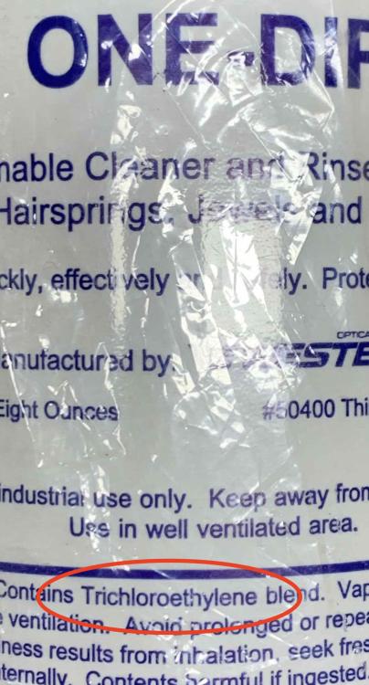

Alternatives for Trichloroethylene (One Dip) and Perchloroethylene
I’m looking for a safer alternative to Trichloroethylene or Perchloroethylene* for cleaning the Balance Ruby.  I think everything else will be able to be cleaned in the Ultrasonic, but I’m hesitant to put the Balance Complete in the machine.  I know Actetone will ‘float off’ any old dried lubricant, but I’ve also heard it can damage rubies.  I don’t really want to use Naptha or Benzene, as they leave a film behind that will likely interfere with the synthetic lubricant.
Any suggestions?

I use brake and clutch cleaner. I think that contains a lot hexane. £20   5 las. Leaves no residue.
I got onto that about a year ago WW . 5 litre tins for 20 quid from motor servicing suppliers. I had a really sticky hairspring a few weeks ago, lighter fluid wouldn't touch it, it even got a short spell is an ultrasonic with elma ammoniated, still wouldn't unstick the coils. A 30 second swirl around in the lid off a tin of spray of the stuff made the coils free again. High evaporation rate similar to lighter fluid but without the addatives.
Thanks for the comments, I really appreciate them.
I think I’m going to stay away from hexane, it’s only two atoms away from gasoline (octane), which means it’s a little too volatile to use indoors…for me at least.  Actually, I stay away from all the ‘-anes’ indoors.  (Except a butane pocket lighter.)
Brake and Clutch cleaner is acetone, at least here in the USA.  I’ve researched a little more, and it appears that a quick swirl in acetone will not damage rubies and should be able to lift off any old, dried oil.  I’ll experiment on the ST36 cap jewel if it has one, and let you all know.

I've found CRC Brakleen® Brake Parts Cleaner to behave much like One Dip when cleaning hairsprings. It seems to have no effect on shellac which is also good. Only downside is I can spot tiny little contaminants in the CRC Brakleen® under a microscope that I don't see in One Dip. They filter out going through a coffee filter though. So I need to experiment a little more to optimize my use of CRC Brakleen®.
The primary ingredient in CRC Brakleen® is tetrachloroethylene. One Dip is trichloroethylene. I'll leave it to the chemists to describe the relative cleaning merits of each. That said, limiting exposure to both seems prudent given their hazardous qualities.
Tetrachlorethylene and Perchloroethylene are the same thing, and I’m trying to stay away from both.  Perchloroethylene has an additional hydrochloride molecule, thus making it tetra- as opposed to tri-.
